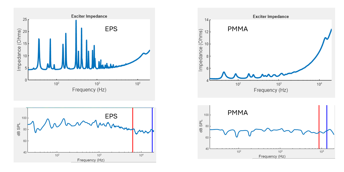

Good catch - I accidentally had a permanently fixed stand on the lower-left corner that was causing these errors in the free version. Oops! It didn't affect anything in SSSS or CCCC, obviously, but did shift the low-frequency modes around for FFFF. I must've been experimenting with that at some point and forgot to set it back.From the EPS impedance plot with PETTaLS, the lowest frequency peaks are not aligned with the measurement.
I'll upload a new version soon that gets rid of the stand and also includes the coupling resonance.
In the meantime, here are some updated results:
Happy those test cases helped in debugging. The fix should solve the frequency shift, the asymmetry in the velocity map and the unexpected peak in the FR.Good catch - I accidentally had a permanently fixed stand on the lower-left corner that was causing these errors in the free version. Oops!
We have now 3 test cases: PS CCCC, EPS FFFF, PMMA FFFF. I have prepared 2 others but I have to learn more from Eric's tap test method to get the materials parameters.

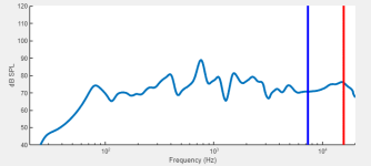

Here is a first version of a paper about damping.
Don't be afraid by the mathematical aspect of the document. It is a way for me to keep notes of what is in the python code. It is also an opportunity to think differently trying to explain what is implemented.
Thanks to that, I found a bug which i think fixed now in some sign mismatch. The damping parameters are now positive as expected!
In the second part of the document are plots that show the effect of each type of damping.
The parameters are not well adjusted. It is the result of few tests.
The main point is probably how the model acts in the frequency range.
The SPL level of the frequency simulation is not aligned on the SPL level of the modal decomposition; A fix to come.
