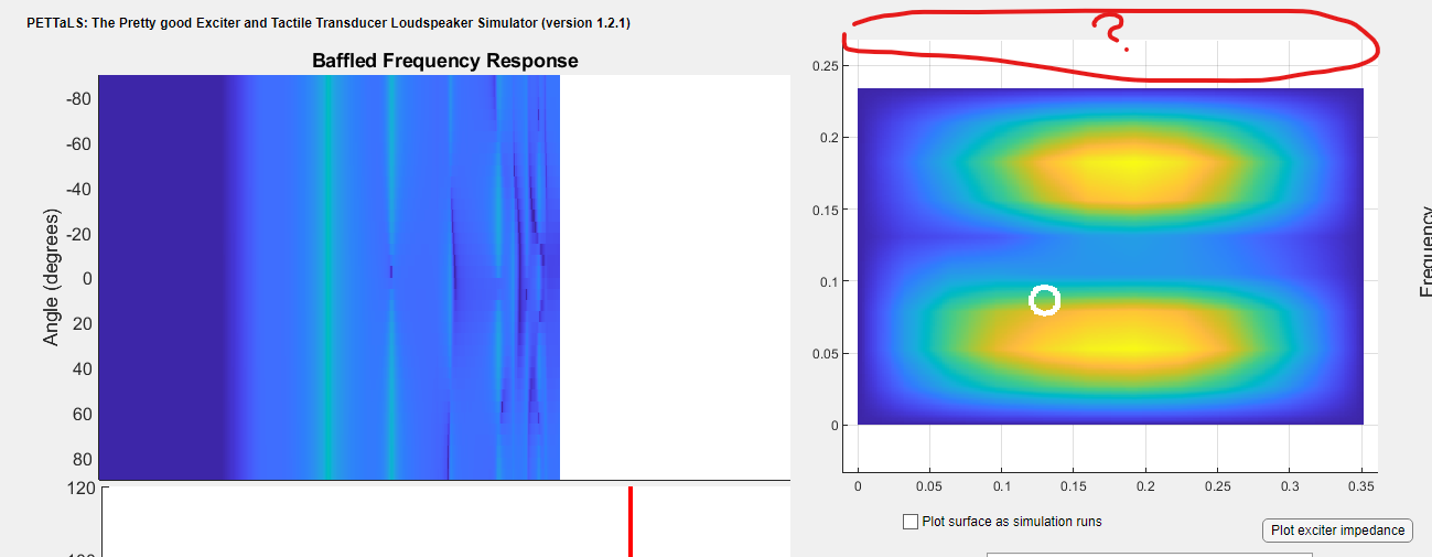

From the EPS impedance plot with PETTaLS, the lowest frequency peaks are not aligned with the measurement.
Good catch - I accidentally had a permanently fixed stand on the lower-left corner that was causing these errors in the free version. Oops! It didn't affect anything in SSSS or CCCC, obviously, but did shift the low-frequency modes around for FFFF. I must've been experimenting with that at some point and forgot to set it back.
I'll upload a new version soon that gets rid of the stand and also includes the coupling resonance.

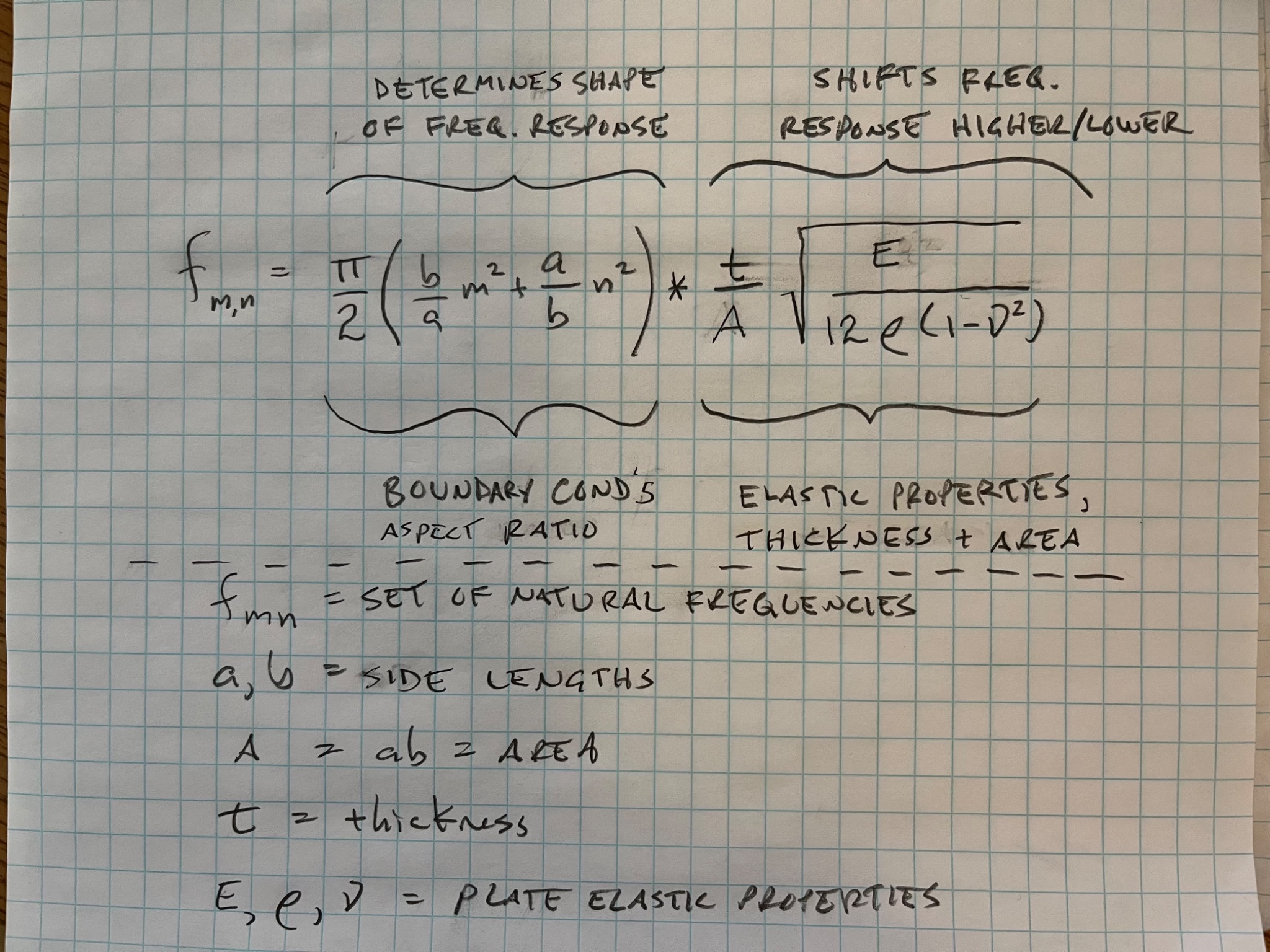

In trying to provide Christian with the best possible characterization of the elastic constants for various panels, I did a series of FEA trials to show how each of the six elastic constants for orthotropic plates influences the natural frequencies. The main purpose for me was to help make my crude trial and error method for evaluation of the elastic constants just a little more rigorous/reliable. Take a look here (or at least pretend to!).
Effect of Elastic Constants on Natural Frequencies
Christian,
I realize this isn't the answer you are looking for regarding the real meaning of the additional shear moduli, but at least it gives you an idea of their impact.
Eric

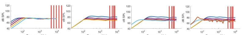

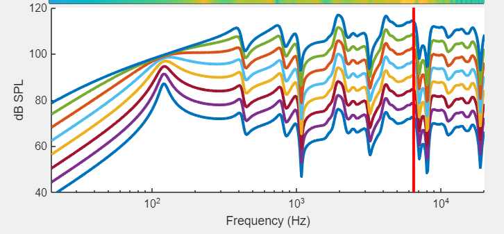

Here are some updated results matching Christian's tests from PETTaLS now that I've removed that pesky stand and added in a simple unbaffled correction. (Black is the new set of results)

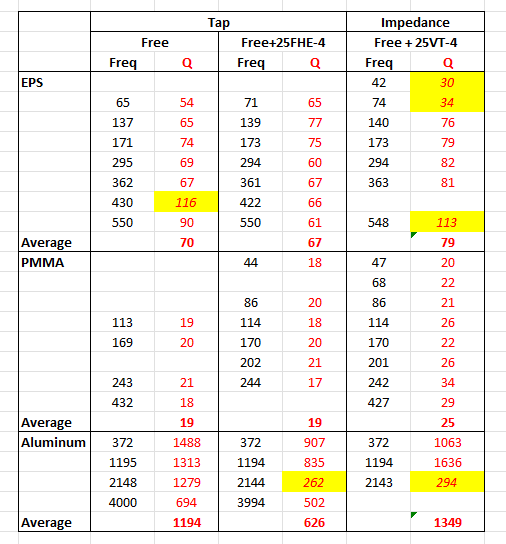

Could you explain the reasons that lead you to adopt the PETTaLLS Q values?
Surface velocity measurements. The Q of all modes seems to be pretty constant when measuring average velocity. I don't know why the values are so different in the impedance measurements - probably something to do with the added stiffness of each mode at the exciter location. The surface velocity right at the exciter point isn't predicted as well by my models as the average surface velocity, so I would assume that the corresponding impedance would also not be predicted as well.
I'd be very interested to know a bit more about how you estimate (a) the elastic properties of plates and (b) their Q value
It's all velocity measurements. For elastic properties (which is my case is just Young's modulus), I just measure the density of the material with a scale and then play around with numbers in simulations until the mode frequencies match up. I think I've really only ever done this with poster board materials, though, so for everything else I look up publications and use numbers that more qualified people have figured out!

Would you mind to explain me your model of unbaffled correction that I implement it in the python script?
Just a simple high-pass filter, as I mentioned in an earlier post, where the dimensions of the panel determine the cutoff.

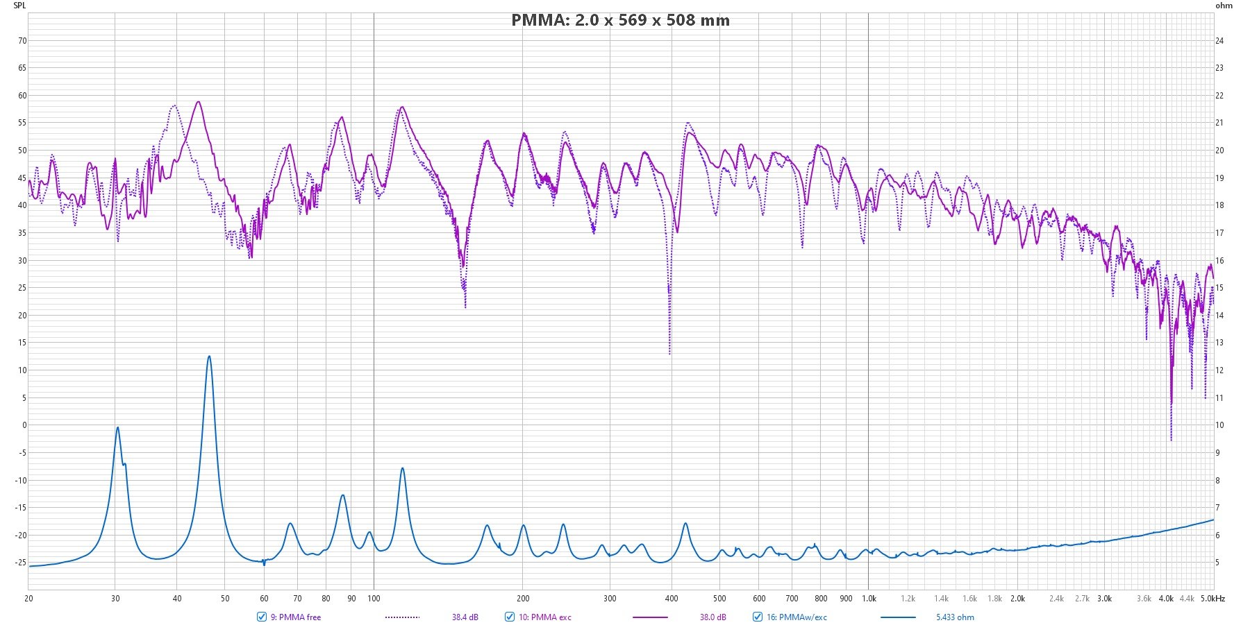

Before new test cases, I saw PETTaLS v1.6 was available.
There is now an option to choose baffled or unbaffled panel (to be selected before running the simulation, uncheck the cell for open back = unbaffled)
I played with this v1.6 the 2 previous test cases EPS and PMMA.
Here are the updated summaries
Christian

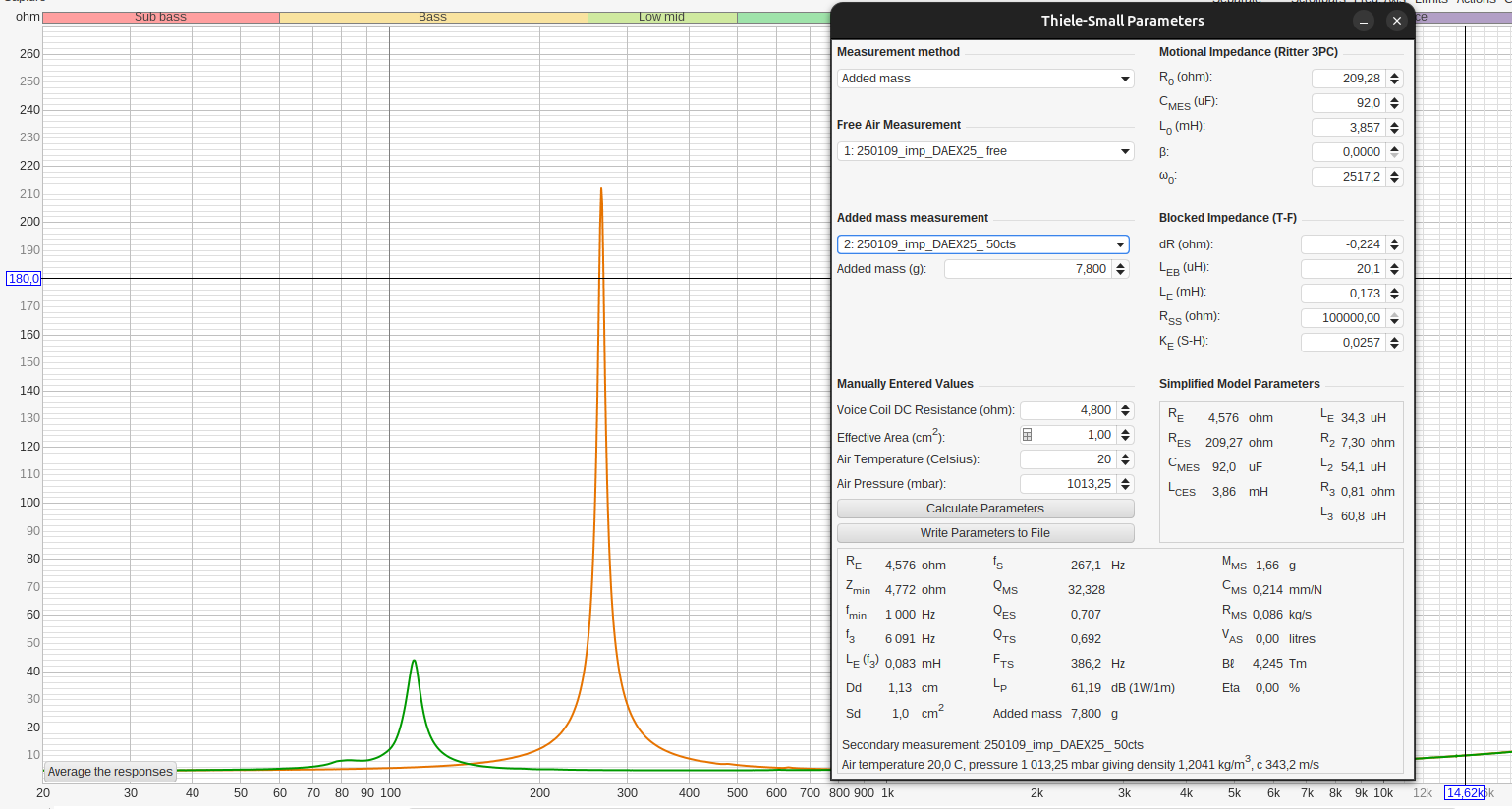

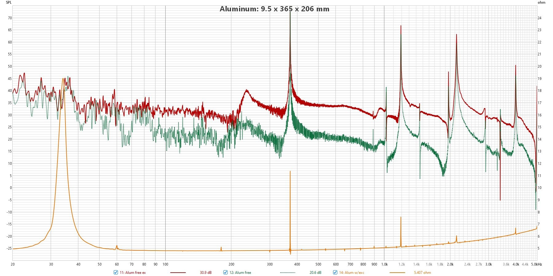

Hi Eric.... I'm hoping you can share some more of the exciter testing output from REW.. In the way of the image now uploaded to Christian's git, and a few actual REW output files of you have any... I'm messing around with a bit of simulation (😵‍💫🥴😱) and I'm not presently able to do the tests myself.

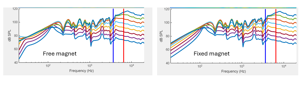

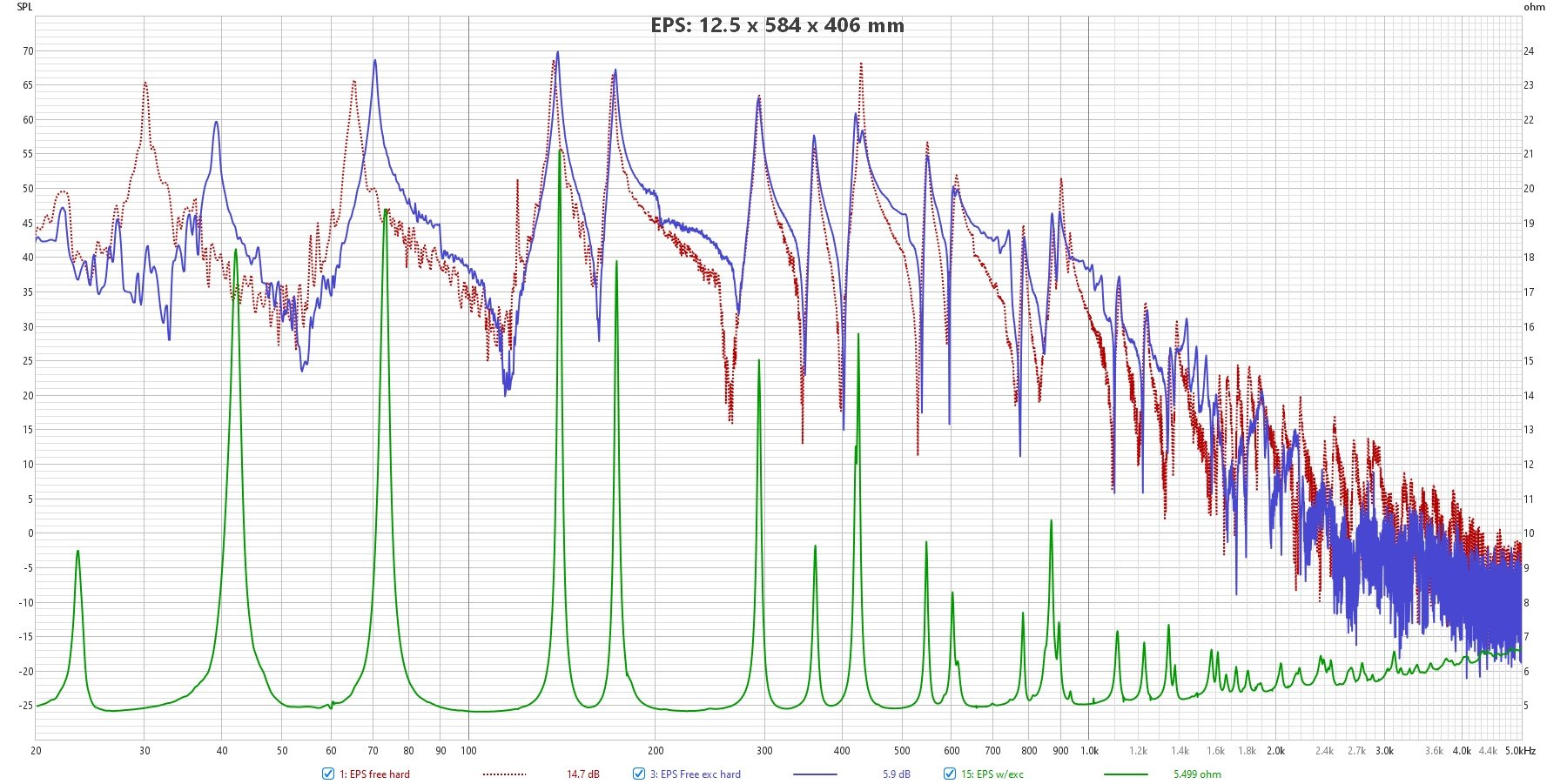

@homeswinghome This is a response to your question from the other thread!
The reason for the extra bass roll-off with EPS is because the panel material is too light and isn't well impedance matched to the free exciter until around 900 Hz. Impedance matching is complicated to analyze, though, because the voice coil mass also plays a big role. The difference is striking in the impedance plots:
The EPS impedance plot shows peaks (indicating panel velocity) only at higher frequencies, and we don't see the magnet impedance at all. This tells me that the exciter is almost acting as if it's floating free in the air, because the panel is too light to really push back. If you don't see the peak from the magnet in the impedance plot, the panel is probably too light - just a rule of thumb I've discovered.
