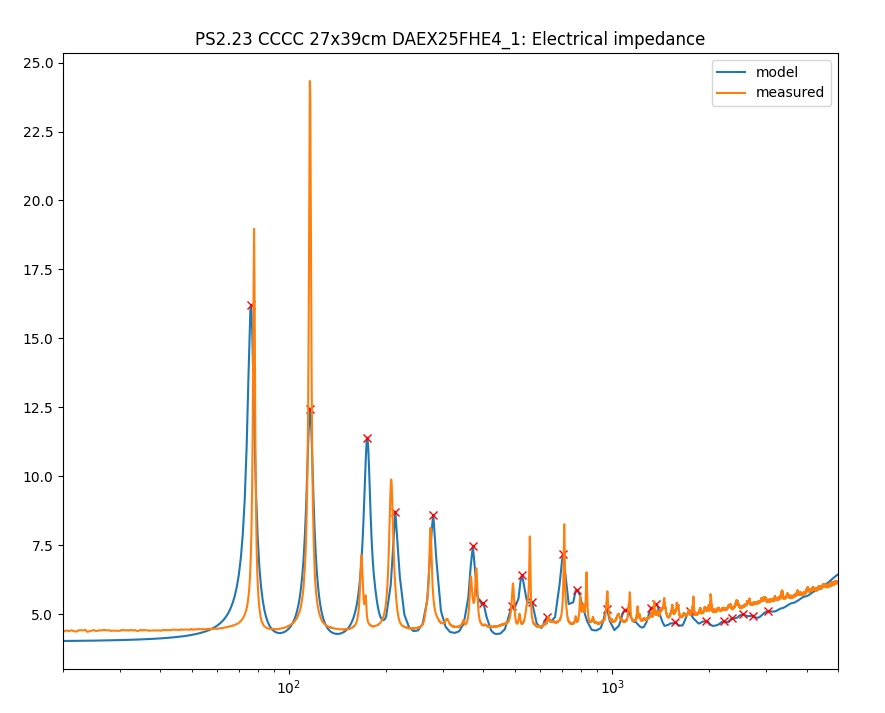

Next plot is the impedance from the FDM script, similar to PETTaLS one mainly because of the mode decomposition model. A better exciter model with a variable damping should improve it.

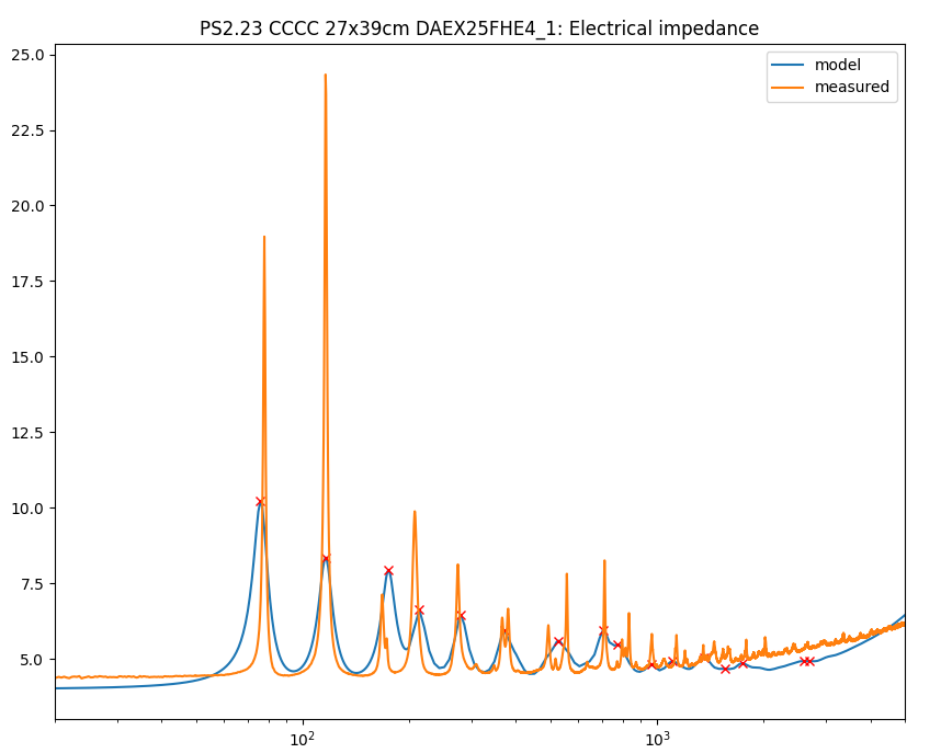

First plot below is the FDM script output compared to PETTaLS. Note they have in common the modal decomposition. I have prepared in parallel a frequency approach (similar to a classical AC simulation in electronics) but it needs a damping model which is not implemented for now. The problem being to find the good damping model...
Probably more interesting is the next plot showing the FDM half plane SPL (blue) and the tentative of open back SPL simulation (green) compared to the measurement (orange). The good point is the model is close to the measurement in the low frequencies. There is a few dB error because the modeled back wave is not strong enough. Some analysis to have to patch it? The dipole peak seems to be at work in the 500Hz area. I can say nothing about the difference in the 70 to 300Hz because of more than possible effect of the room. Some outdoor measurements would be welcome.

Christian,Next plot is the impedance from the FDM script, similar to PETTaLS one mainly because of the mode decomposition model. A better exciter model with a variable damping should improve it.
Does your model us a "Q" factor for the panel, like Pettals? Are you using the Pettals value of 10 (from acrylic)? Did you try increasing the Q in the model to see if the predicted impedance comes closer to the measured results?
Did you also measure impedance of the panel in the free (hanging) condition? I'm curious if the impedance peaks look similar, or if they are even sharper in the free condition. I only once ever built a CCCC panel, and it was before I had the impedance rig. I always assumed that a CCCC frame would add damping (even if it wasn't intended), but your measured peaks look remarkably sharp, like I might expect from a free panel.
Eric
Hello EricChristian,
Yes currently my script is based on a constant Q value, here 10. It is the only model I know currently that gives pretty good results. A simple constant viscous damping for example doesn't give good results. Some variation with the frequency, I guess an increase at low frequency is needed. It is what comes also to simulate correctly the behavior of the exciter spider (visco-elastic damping?). See in my previous posts here the one about the reduction of the peak impedance when we had some mass on the exciter voice coil for parameter extraction.

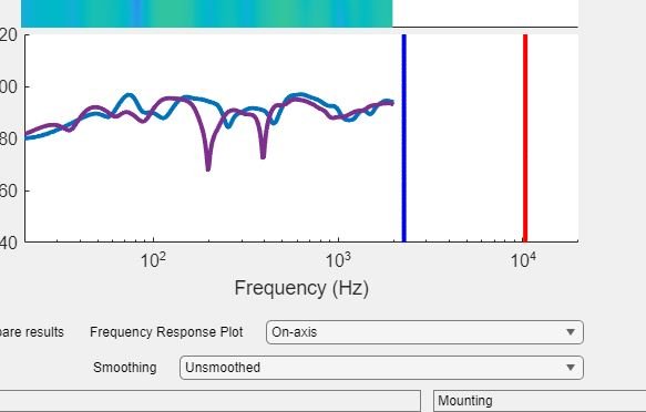

See the plots belowDid you try increasing the Q in the model to see if the predicted impedance comes closer to the measured results?
The correlation between simulation and measure seems better for the impedance...
But for the FR, I would say it is more difficult. Maybe it is already to late here for me?
I tested different combination of not smoothed/smoothed curves. What gives the best correlation is to introduce smoothing in the simulation output and in the measure. Like if the higher initial damping helped in the reading by a natural smoothing
To be clear, I understood just after the pretty good results of the FDM to get the modes that the damping is as much difficult or even a more difficult topic. This impression may come from the fact I have collected papers about FDM for a long time now, many are available; compared to the papers about damping.
No i didn't measure this panel in FFFF. Unfortunately it is now glued on the frame and I have no more enough material. The IR or the spectrogram show long time ringing in CCCC. So in my opinion it is not a damped design.Did you also measure impedance of the panel in the free (hanging) condition? I'm curious if the impedance peaks look similar, or if they are even sharper in the free condition. I only once ever built a CCCC panel, and it was before I had the impedance rig. I always assumed that a CCCC frame would add damping (even if it wasn't intended), but your measured peaks look remarkably sharp, like I might expect from a free panel.

FR. greem simulation (OB), orange : REW FR 5ms windowed IR no smoothing
