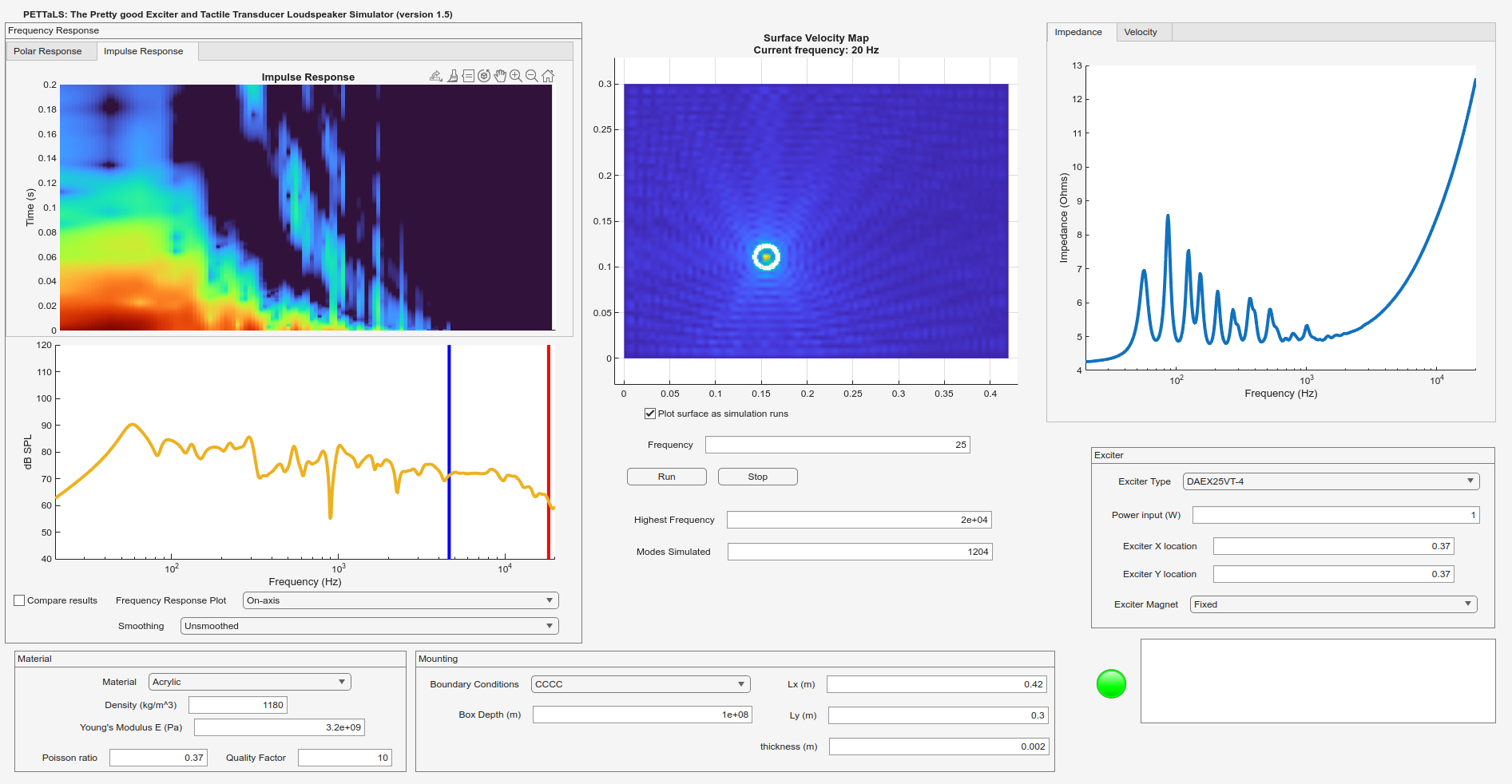

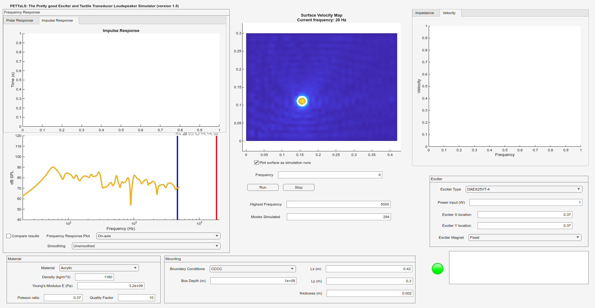

Hello Dave,
Download and launch of the app after the path update are OK. The MATLAB run time R2025a was installed.
... but the plot issue remains. The impulse, velocity and impedance plots are blank. Seems the problem has occurred since 1.4.2 with the change in the GUI (tabs).See 1st picture below.
...but maybe here is a clue : the simulation was up to 5k. The 2nd picture is up to 20k, the plots are displayed!
... an other clue :
Below is the content of the terminal at the end of the simulation up to 5k (no action from the GUI from run button push to this message)
PS : more observations
  • running a new 5k simulation after the 20k one, the problem seems remaining (error message and plots impulse, impedance, velocity not blank but not updated from the previous simulation.
  • running then a 2k simulation... the plots are updated!
It is also correct if I launch a simulation up to 2k just at launching the app!
Like if PETTals likes simulation up to 2k or 20k but not 5k! ;-).

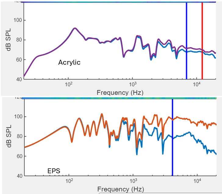

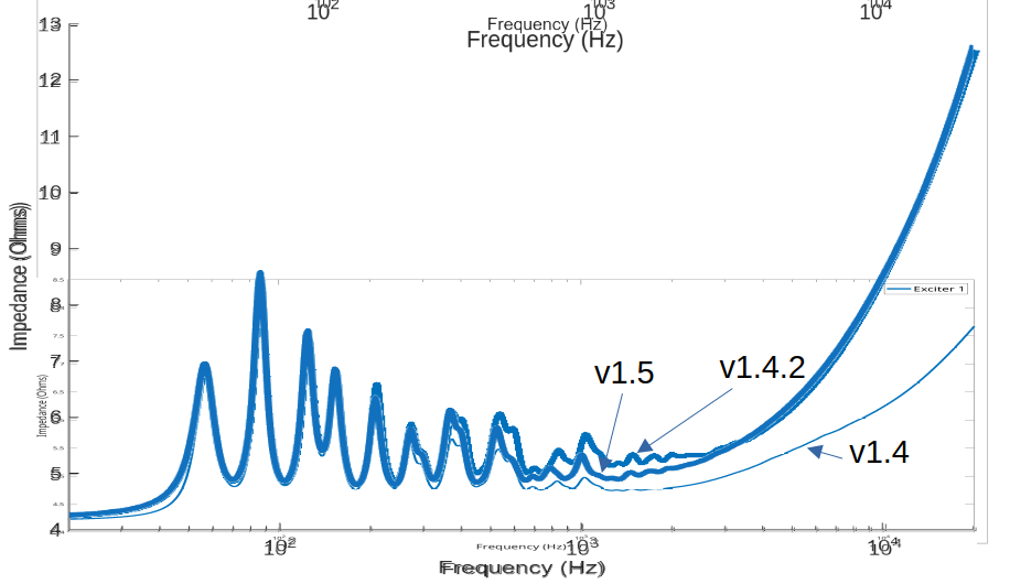

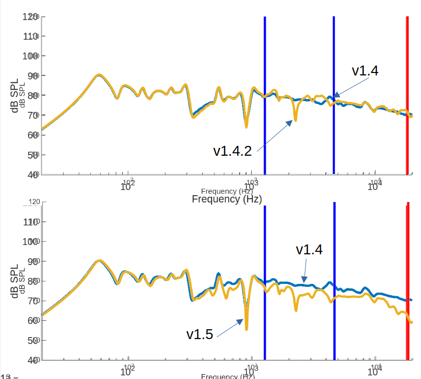

As I was comparing my FDM script outputs to PETTaLs and with the released of PETTaLS v1.5, I compared the outputs of PETTaLS different versions. There are more differences than I thought.
Below are the overlays of the FR and impedance output in 1.4, 1.4.2 and 1.5 for an acrylic 300x420x2mm panel with CCCC boundary conditions and a DAEX25VT at 0.37/0.37 with a fixed magnet.
I came to CCCC configuration because even if it is not what could make a panel for music it appears to be the best configuration for comparisons so I am in the idea to build a test panel similar to that.
To come back to PETTaLS versions, I didn't have in mind the differences in the 1 to 5k range between them.
  • v1.4.2 introduced a deep a bit above 2k and a change in the impedance curve. The increase due to the inductance seems more realistic but with a strange flat area from about 1.5k to 2.5k. The blue vertical line was moved up.
  • In v1.5 this range 1.5/2.5k in the impedance seems more realistic.
  • In addition to the HF roll off, v1.5 modifies the FR in the 1.5/5k range which is now less smooth. It increases also the dip just below 1k.
There is probably no general interest you explain the changes themselves but I think we would be interested if you could share how it converges to your own measurements.
From the comparison of the FDM script to PETTaLS, it comes the impedance peak values and the mean SPL level from the script are for some reasons wrong but there is a pretty good agreement on the frequencies of the peaks of the impedance, the surface shape of the main peaks and on the SPL curve. Both agree on the dip just below 1k even if the valley from FDM is closer to v1.4/1.4.2 and on a not that smooth SPL in the 1.5/5k range as shown by v1.5. The script doesn't show the same shape of dip above 2k but "something happens".
I am curious now of practical results in parallel to that.
Christian

Oh, good catch. I actually caught this bug a while ago but forgot to update it in the github version. There are certain frequency limits that give a NaN SPL for the highest frequency point, so I can easily fix that, and I'll upload a fixed version later today (still v1.5).

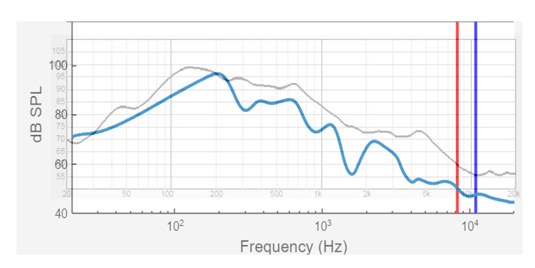

Because you're using the 25VT-4, my guess is that the change from v1.4 to v1.4.2 comes from the fact that I apparently fixed some parameters related to that exciter specifically (just checking the release notes). It was mostly the ring size that I fixed, I think, but it also looks like the voice coil impedance was updated.
Moving to v1.5, the voice coil mass was missing a coupling variable in my code, and after I fixed this, the "something happens" is happening. Tough to describe exactly what's going on there - it's not as simple as a low-pass filter - but I can tell that the simulations are matching experiments much better in the frequency ranges above 2k now.
For example, here's a comparison between the published SPL for the 32VBDS exciter (the biggest, heaviest one) from Dayton and my simulation. They used 1/2" foam core board with an unspecified location - I used 1/2" XPS with (0.37,0.37), so it's not an exact comparison, but not too far off. The general roll-off trend is the same.

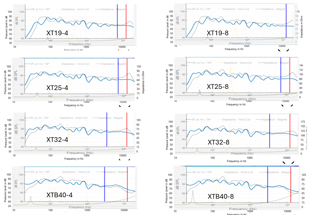

Here's something else fun - I was able to derive almost everything I needed for the Xcite models from the datasheets. Plugging the parameters into my models, the simulations come out very close to the published SPL curves. I'm not sure I totally understood how the panel was set up, but they're very close nonetheless. I think the panel vibration area was slightly smaller than written, probably due to a clamped area at the edges, which probably explains the differences at low frequencies.
Reactions: Veleric

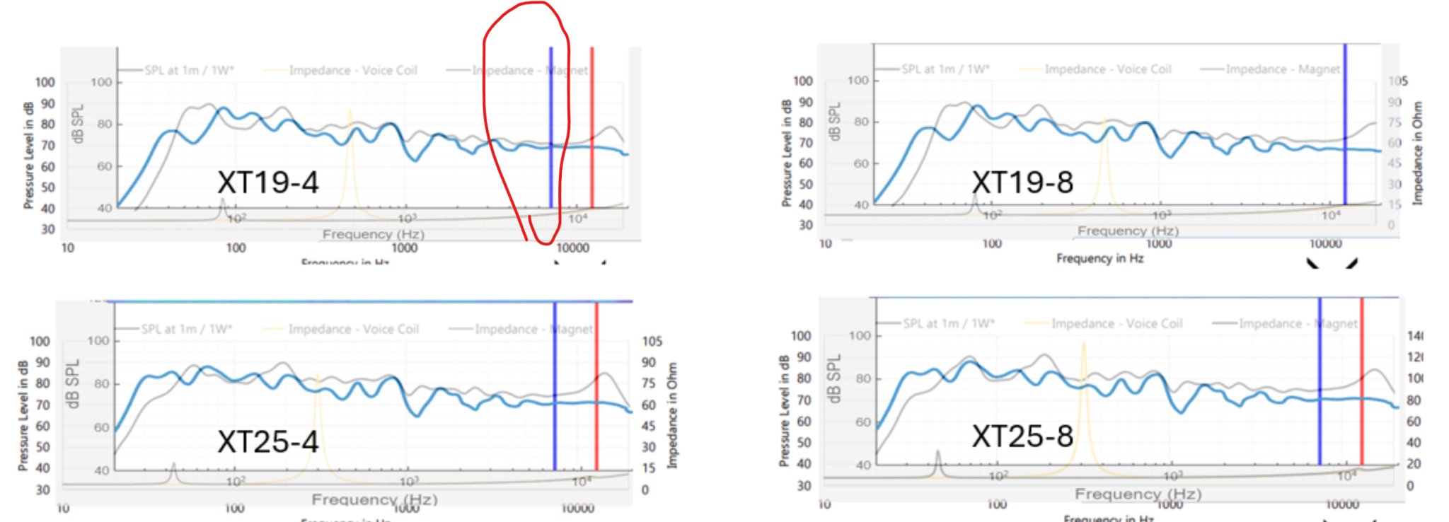

That's really excellent Dave! From your previous post about the Dayton example, I was thinking also to the Xcite. It confirms also the Xcite specifications are pretty good.
Among the few remaining differences :
  • there is a peak in the Xcite plots below 200Hz.
  • the dip at 1k is more severe in the simulation
  • the 19 to 32mm models show the peak I mentioned before above 10k which identified coming from the central area.
With Eric, comparing FDM script to FEM we had a similar question. When the boundary conditions are implemented in the simulation at the equation level, it is the same as if the clamped area was external. It makes sense it is here the external dimensions of the panel. My FDM script works in the same way. Implementing the clamp condition reduces the panel size by adding fixed points.
Something I don't see in the Xcite specifications is the magnet condition: free or fixed?
The panel is about 0,39x0,78m with the exciter at 0.35/0.5. On which dimension did you assume the 0.35?
Christian
