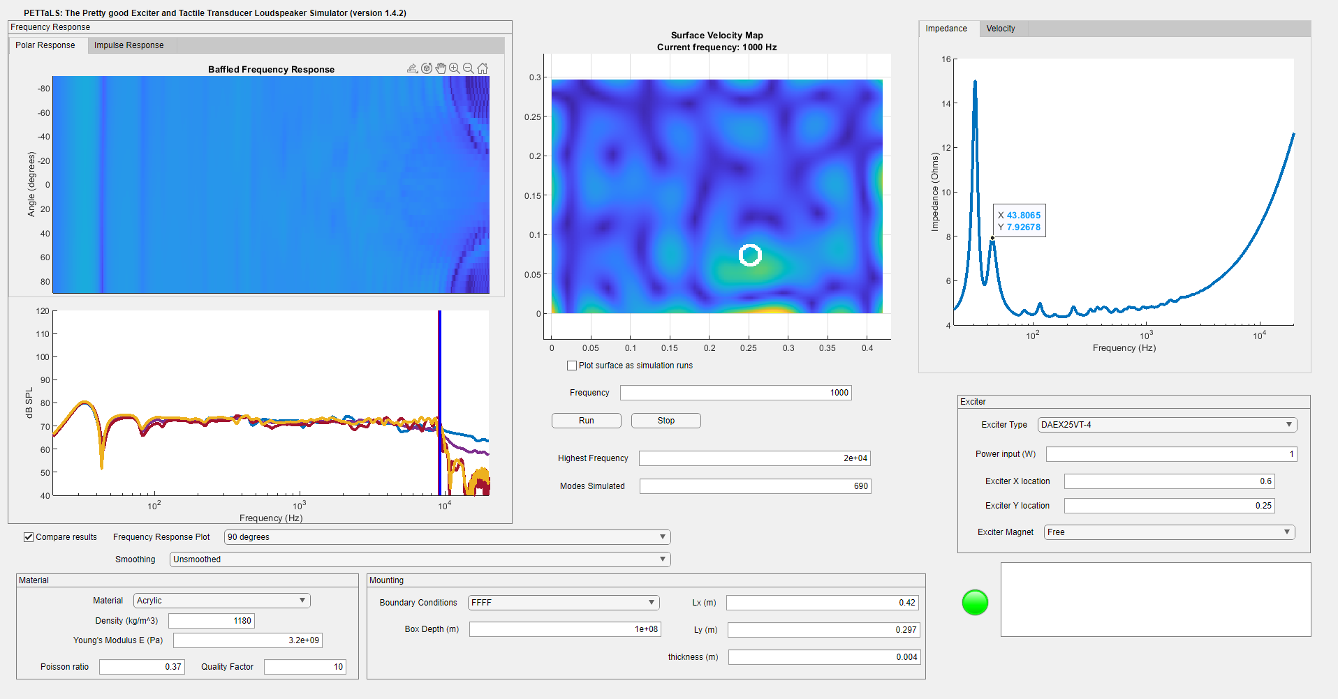

PETTaLS Flat Panel Speaker Simulation Software
And here is an interesting Pettals result for a FFFF acrylic panel, using the default values for acrylic, including a Q of 10.
The sensitivity is really low, as expected with acrylic, but the predicted response is remarkably flat. I found a panel of these dimension online for under $20, so I will see how it really performs when that arrives!
Eric

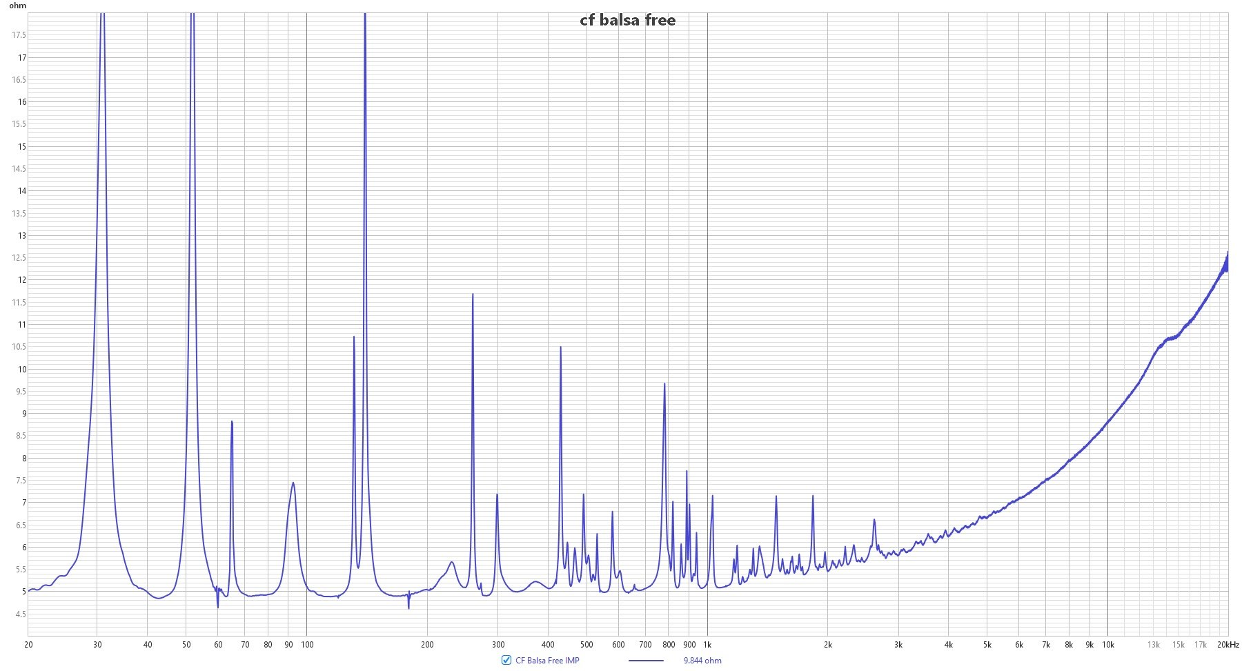

Eucy,

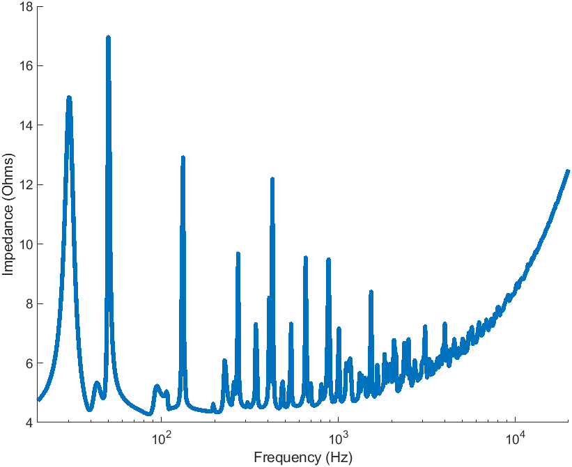

Here (below left) is the impedance curve I measured using REW for a "free" CF/balsa sandwich panel, with a 25VT-4 exciter, Below right is the Pettals FFFF sim using Q=100. Obviously they are not a perfct match, but they are at least qualitatively similar. It should be noted too that the actual CF/balsa sandwich panel is not isotropic, and the real panel isn't truly "free" but hanging from two wires. So it's unreasonable to expect a perfect match. Also, in real life, Q is likely a function of frequency. But that said, I think it's reasonable to say that the "intrinsic Q" of this panel is pretty darn high, and likely in the ballbark of 100.

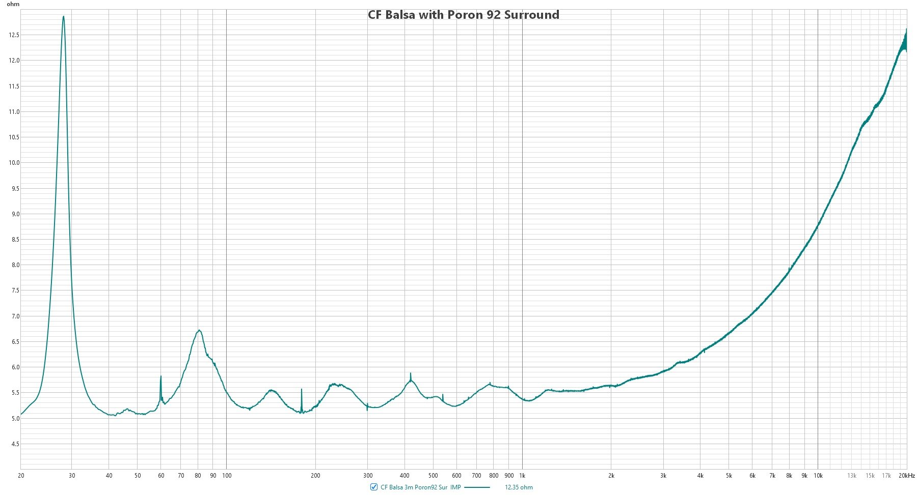

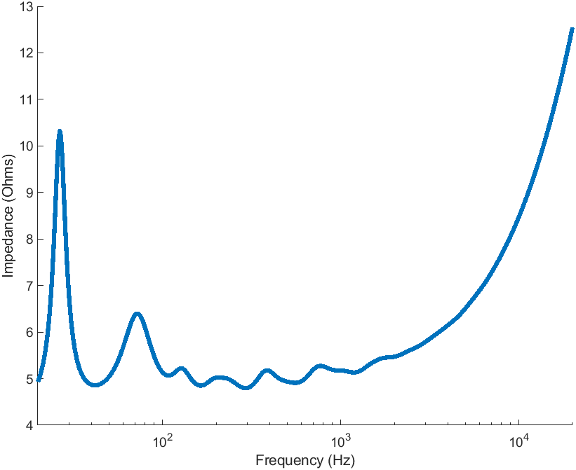

And here (below left) is the impedance curve I measured for the same (or similar) CF/balsa panel mounted to a frame with Poron foam, and also with a 25VT-4 exciter. On the right is the Pettals SSSS sim for Q=3. Again, it's not a perfect match, but I think it's fair to infer that the result of the Poron foam perimeter is a "system Q" of on the order of 3, even if the panel itself is closer to Q=100. (The tiny sharp spikes in the REW measurement here should be ignored, they are system noise).
Eric

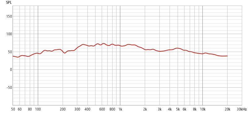

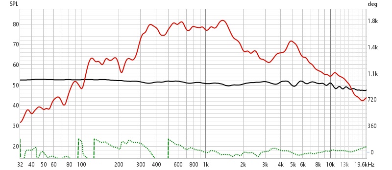

Here are the REW measurements I made at 1m for my small A4 framed canvas acrylic panel:
Looks like Mount Everest.
Here zoomed out with 1/6 smoothing:
Not sure if this is good or bad, but the (single) panel does not sound too bad. Compared to a free hanging 2mm poplar plywood panel the plywood sounds better to my ears. I have not made any progress on this project yet. My next plan is to make another A4 canvas framed panel, but with 2mm poplar plywood and compare to the acrylic one.

Eucy,
View attachment 1452433 View attachment 1452434
View attachment 1452435 View attachment 1452436
Eric
They're remarkably close Eric.. Well tested!!

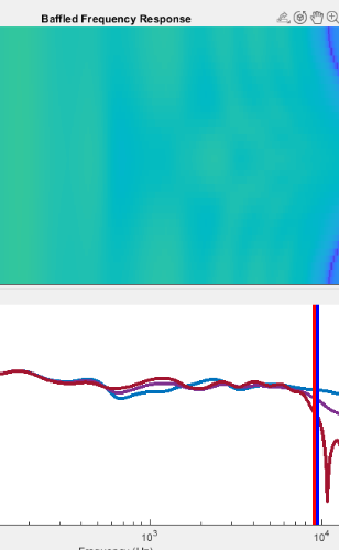

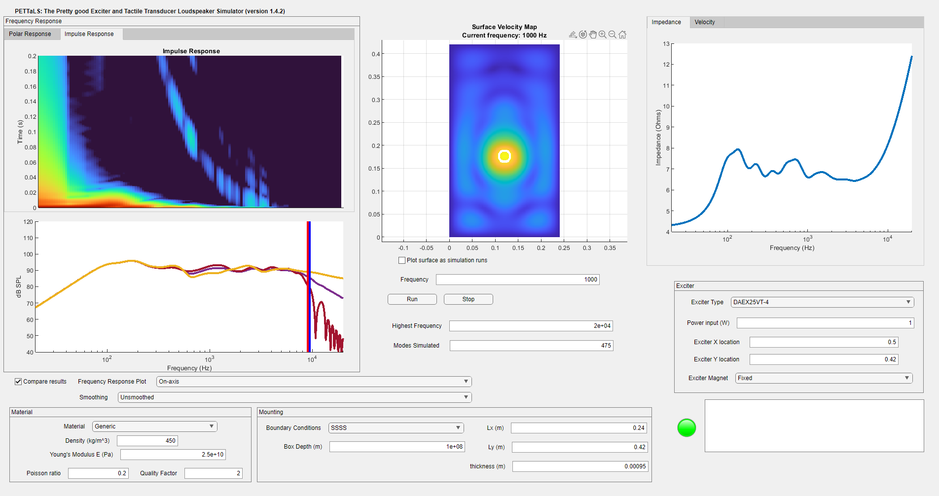

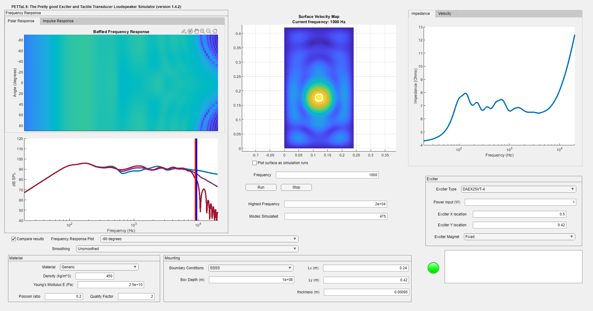

I thought it might be interesting to talk about what the results of a "good" DML design might actually look like in Pettals.
So I am inviting those who are interested to come up with a virtual design that looks good to you, and share it with the rest of us. The idea for the time being is to simply assume that Pettals is perfectly accurate, and find and share a design and response in Pettals that looks like the response you would like to see from your own DML panel. Use whatever material properties and configuration that you want.
The design/response below is my first entry. In the interest of being realistic (or close), I tried to limit myself to:
  • Designs using one of the three actual exciters in the program (i.e. not point force)
  • Material properties that are (hopefully) within the realm of possibility.
  • SSSS panel (I'll try FFFF next).
My design goals were:
  • Sensitivity >90 dB at 1 watt
  • Flat-ish response over the widest frequency range possible, with emphasis on 100 Hz to 10 kHz
  • Slight downward slope okay/preferred.
  • Minimal variation of FR with angle, directivity always positive, or nearly so.
  • Clean impulse response without long tails.
Feel free to make up your own constraints and goals.
Below is what I came up with, the second screenshot is the same as the first, but with the impulse response plot selected instead of the Polar response.
View attachment 1451785 View attachment 1451792
Some points:
  • The panel properties are approximately what I get with a carbon fiber balsa sandwich, but for this design I need balsa and cf fabric about half the thickness of what I have made before.
  • I chose a thickness that put the coincidence frequency and exciter cut-off frequency at the same value. However, since the panel is not isotropic the prediction of fc is dubious.
  • The panel size was made just large enough to get the fundamental frequency (first impedance peak) at around 100 Hz.
  • The aspect ratio and exciter location were positioned by trial and error to get the flattest possible response.
  • I used a Q of 2. I'm not really sure if it is really possible to get Q quite that low. Using Poron foam on the perimeter with the thicker versions of these panels resulted in a Q of near 3, I think. I don't know if Q will be higher or lower with a thinner panel. Using Q=1 gives an even flatter response, with virtually no cost in output, but setting Q any lower than 1.0 starts hurting output SPL.
  • Probably the weakest part of the response is around 1000 Hz, were there is a bit of a dip in the on-axis response, and the DI goes slightly negative, but otherwise I think the simulation looks pretty good.
Next I'll try an FFFF design. Meanwhile, I'm interested to see what looks good to you guys.
Eric

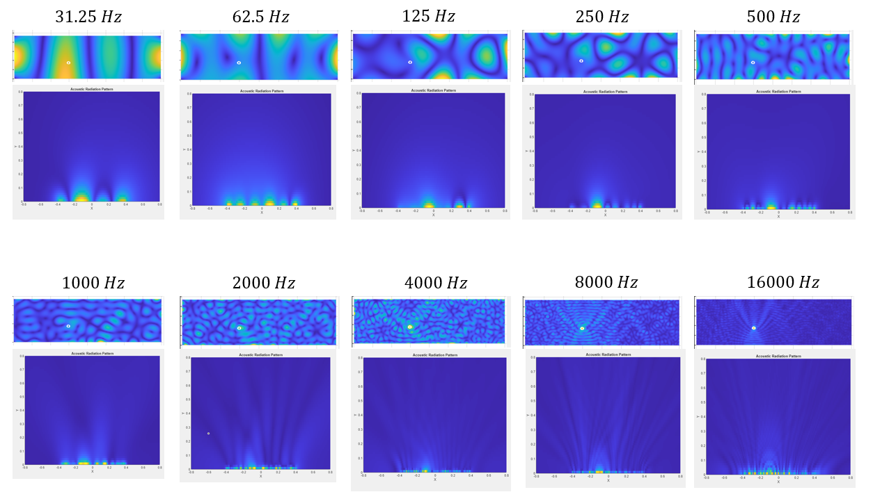

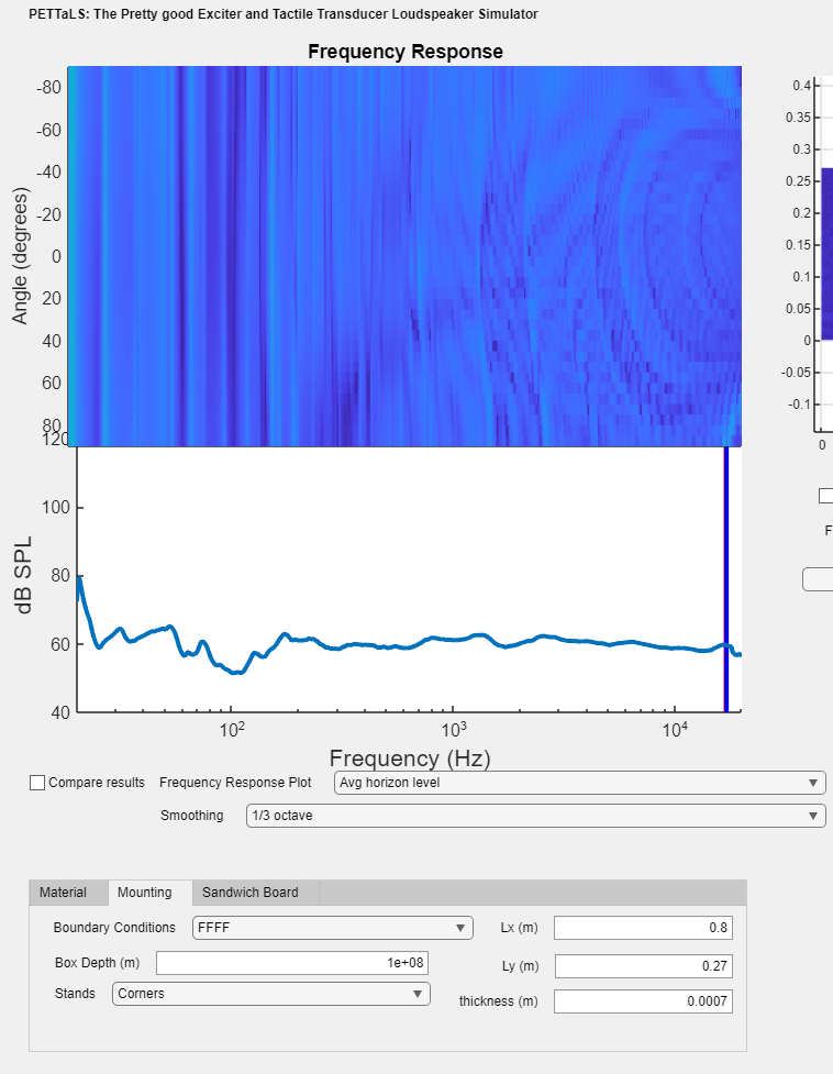

I designed (in PETTaLS) a 0.7mm FFFF glass speaker with corner supports, 0.8m x 0.27m, with a single small Tectonic exciter such that the coincidence frequency and driver critical frequency (still not sure what to call it) overlap at roughly 16 kHz and don't affect the audio frequency range too much. By the way, I'm cheating and using the PETTaLS version with extra options.
Here's the polar response and frequency response.
Here are the surface velocity shapes and radiation patterns (I like the erratic responses above 1 kHz). These shapes are actually from a speaker with a slightly different aspect ratio, but it illustrates the point and I didn't feel like going through the hassle of taking a bunch of screenshots again!
This speaker has a more-or-less flat response, besides some peaks and dips below 200 Hz. It's pretty omnidirectional at all frequencies too, or at least after you realize that the erratic directionality shifts don't lead to any enormous dark spots in the polar response.

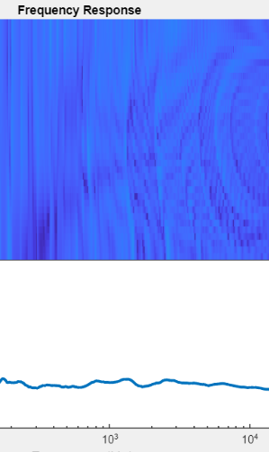

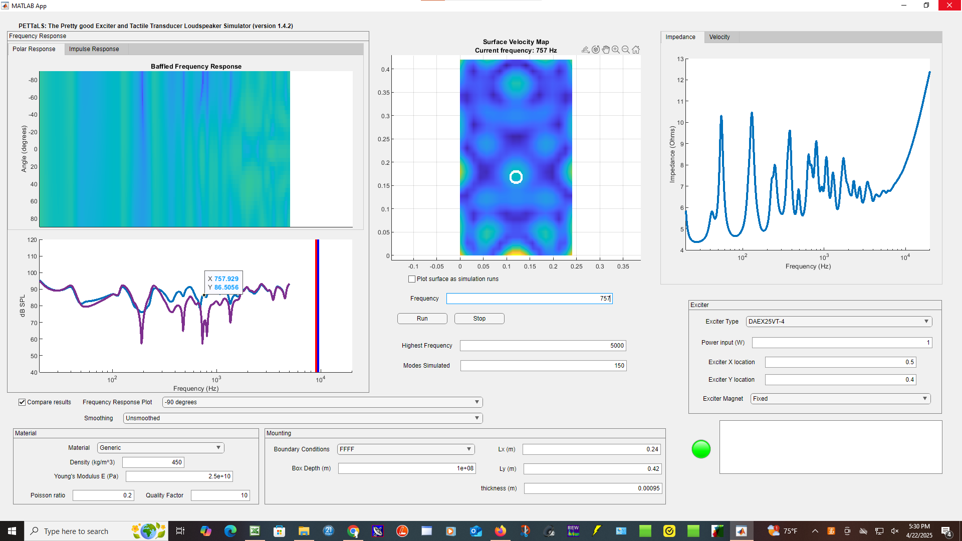

I just tried this sim of an FFFF plate with the exciter in the center of the X direction. I was surprised to see that the responses at +90 and -90 are pretty different, particularly in the region of 150 Hz to 2000 Hz. Interestingly, in that same frequency region, the surface velocity maps look very symetric, like the one shown at 757 Hz. I have not see anything like this with SSSS conditions.
Any thoughts?
Eric
I think this is probably due to the discretization of the exciter ring shape, which always comes out a little bit lopsided. I haven't seen the effects so dramatically before, though, so I'll look into it more!
OMG I just realized just how big and thin that really is! I was going to ask how many of them you have broken so far and realized that you probably havent broken any, since it's only virtual design, so far, yes?
Eric
