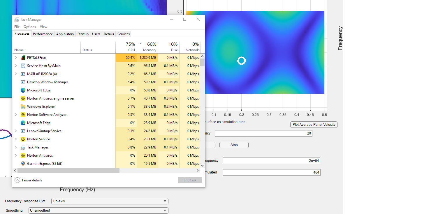

I still suspect my computer might not really be up to the task, but I'm wondering why Pettals seems to be using som much memory and CPU and while nothing is apparently happening. Here I had asked for a new sweep to start but there was no indication on the screen that it was even running. When this happens sometime I just shut down and restart my computer and it runs a few sims until the same thing happens, i.e. nothing apparent happening but lots of memory and CPU in use.

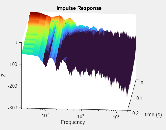

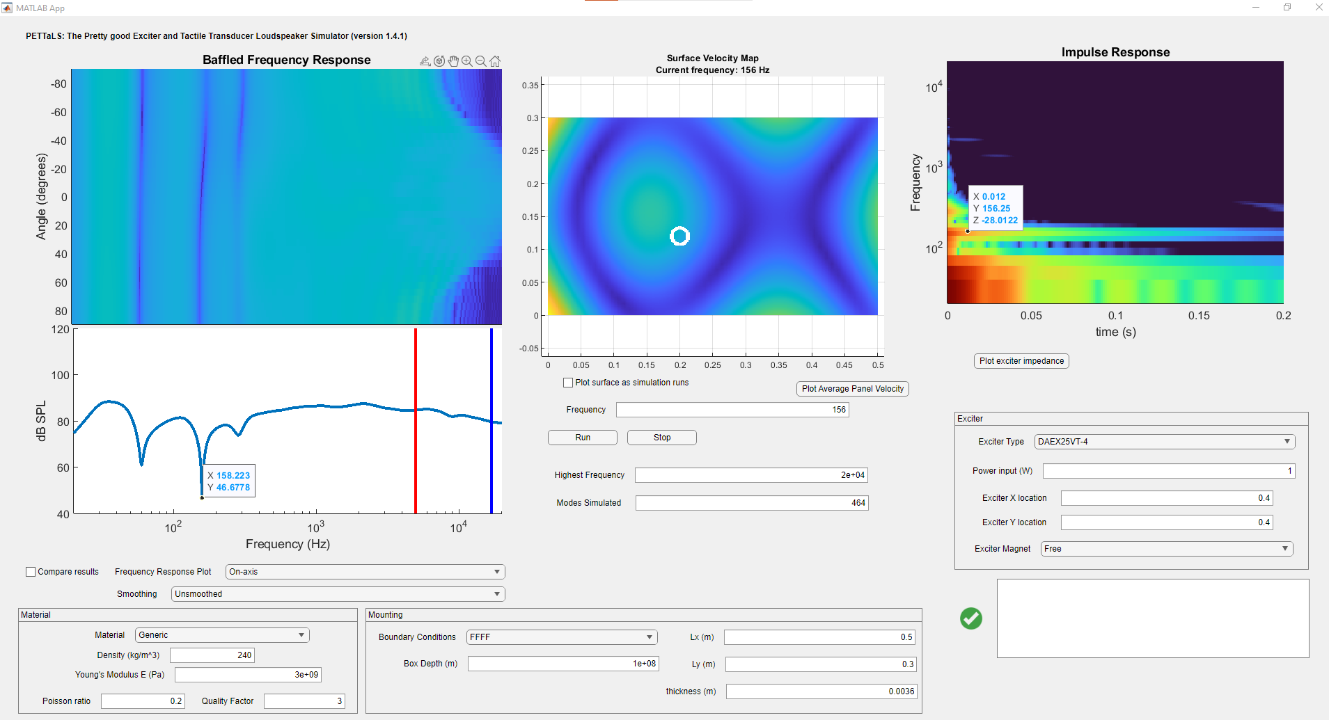

I just observed something that seems odd to me. The simulation is of a highly damped FFFF plate, otherwise using properties roughly like a fiberglass/balsa sandwich panel I made. The thing that seems odd to me is that the impulse response is showing a strong resonance at around 156 Hz, and there is a corresponding peak in the impedance at nearly the same frequency, which is typical. But those peaks coincides with a very strong dip in the SPL at the same place. Does it make sense that there really could be such a strong ridge in the impulse response at the same frequency as the deep dip in the frequency response?

View attachment 1442446 View attachment 1442449
It looks to me like there are three ringing frequencies that correspond to the "peaks" between the sharp nulls. The specific ringing that you were pointing out seems to come from the pseudo-peak around 120 Hz. The colors are assigned based on the value at the lower frequency for each mesh surface, so it makes it look like the red color is assigned to a higher frequency than it actually is with this low of resolution.
I'm not totally sure. I can say, though, that I'm not having this problem on any of the computers I've been running my program on. Matlab is a compile-at-runtime language, though, so the execution performance depends a lot on the specific machine.@EarthTonesElectronics

There's a couple things I can do to probably free up some memory (I would maybe also guess that your CPU shows such high usage because it's keeping a lot of values in cache, but I'm not totally sure). The IR spectrogram can be resampled to take up less memory, and based on some code rewrites I don't need to store the surface velocity at every frequency any more, so let's see if that helps!

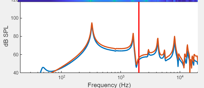

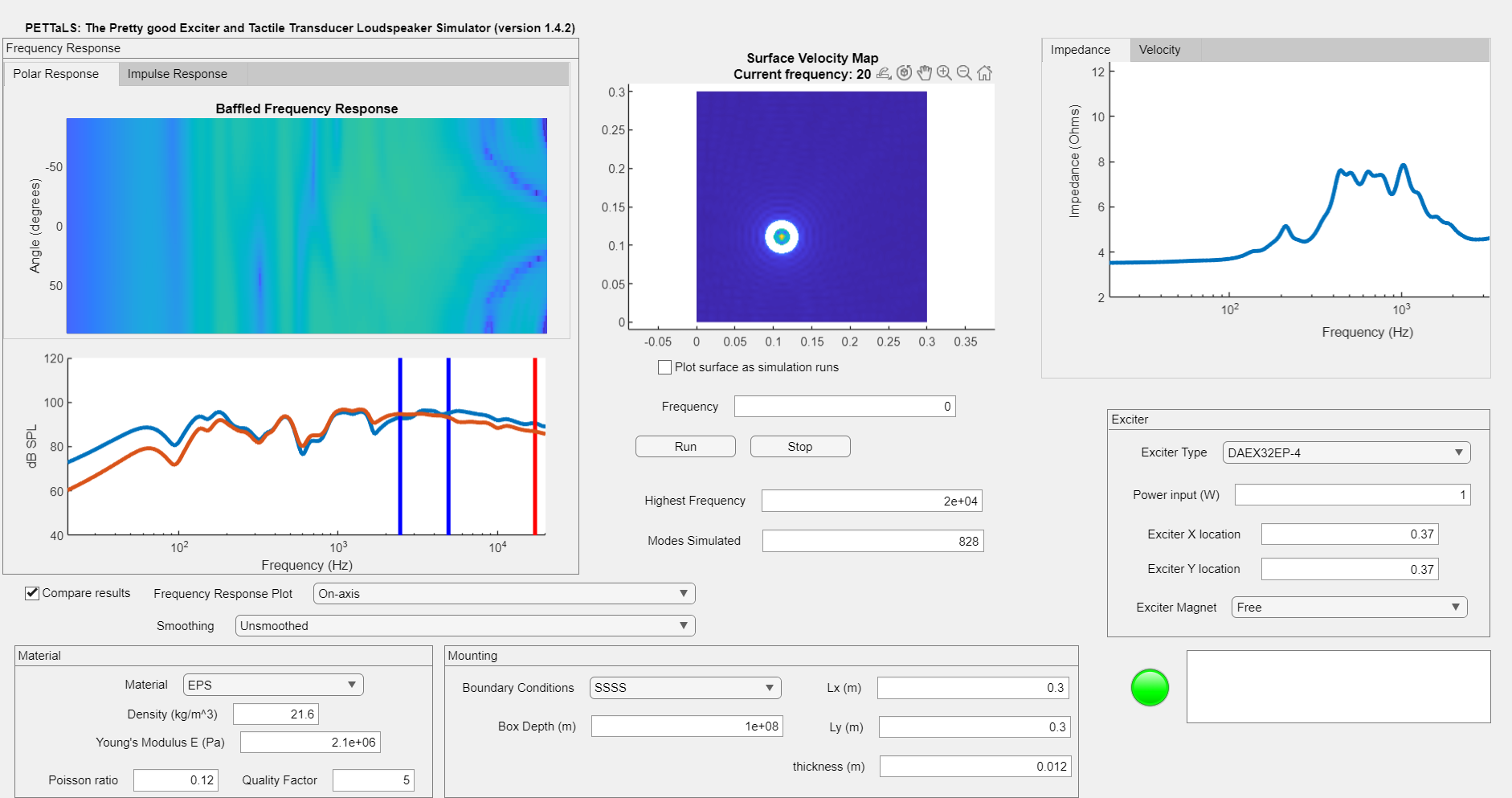

Hi Dave - Can you please check and advise why the sim shown shows a much poorer response graph from the 32mm thruster vs the 25mm VT-4.
The 32mm unit has a slightly higher BL than the 25VT-4, and Dayton's FR graphs show the thruster giving about 7dB more than the 25mm unit at 100-200Hz (On foamcore) vs the sim, which is about 10dB lower for the 32 than the 25.

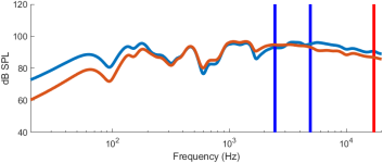

Also there's a marked difference in the lack of roll-off at HF's in the sim vs the Dayton graphs for both exciters. Blue=25VT-4, red=32EP-4

There are at least 2 things going on here...Hi Dave - Can you please check and advise why the sim shown shows a much poorer response graph from the 32mm thruster vs the 25mm VT-4.
1. In our tests, the EP-4 actually did have a lower BL than the VT-4. We've also seen, though, that the tolerance is huge on these billionsound exciters, probably up to as much as 50%. If we had more funding to test a wide range of units we could come up with a better estimate of where the middle of the bell curve was for each exciter model, but alas, we don't right now! That being said, the EP-4 is still capable of making a louder speaker because it can handle double the wattage of the VT-4.
2. There's also the issue of impedance matching - At 100 Hz, 1/2" EPS is very floppy, and the exciter doesn't have to push against. The 32EP-4 is a much stiffer exciter than the 25VT-4, so the relative squishiness of the 25VT-4 is actually better impedance matched to the floppiness of the EPS.

My friend Steve wrote quite a bit about this in his PhD thesis. They're cheap exciters, though, so you get what you pay for!That's terrible quality control.
At first I thought this would be due to the voice coil impedance, but after checking my measurements those two exciters have relatively similar impedance curves at high frequencies. This means, then, that the HF roll-off would be due to the larger ring shape of the EP-4. I ran a simulation using 6mm thick aluminum, which has wavelengths larger than both exciters even at 20kHz, and there's no real roll-off difference between the exciters (orange is VT-4, blue is EP-4):What about the hf roll-off differences?

Thanks Dave. This means, then, that the HF roll-off would be due to the larger ring shape of the EP-4.
I was really getting at the fact that the Sim roll-off of both is less than we typically get in practice. Our general conclusion is (I believe) that with EPS it's most likely due to through-thickness shear deformation, a feature which would not be picked up by thin plate theory.
A secondary cause applicable to all panel materials (but perversely, probably less so with EPS) may be voice coil deformation ala Zenker.
