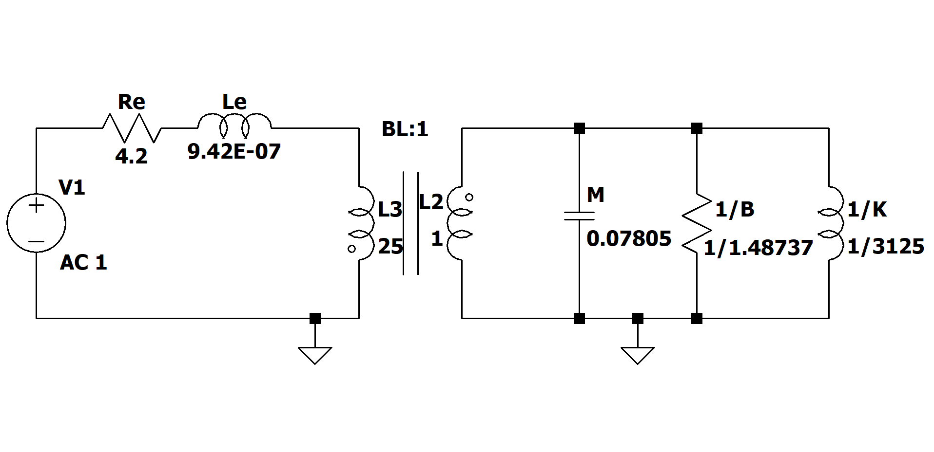

I'll add this to the list of things I'm working on!1/ Is there a possibility to export a curve (ie impedance or SPL) to a text file?
The model that I'm using is more complex than this, but collapsing it down to these components... (as electrical units)2/ Could you add to the BL information the values of Mms (mass), Cms (compliance), Rms (damping) of the exciter models?
DAEX25VT-4: Mms = 78 mF, Cms = 320 uH, Rms = 0.8 ohm.
DAEX32EP-4: Mms = 124 mF, Cms = 323 uH, Rms = 1.3 ohm.
DAEX25CT-4: Mms = 29 mF, Cms = 45 uH, Rms = 0.18 ohm.

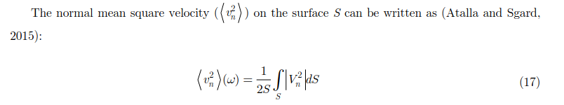

Yes, I do the RMS because the velocity at each point has a magnitude and phase, then take the average over all points on the surface.In the velocity plot (the curve in the same window as the impedance), which velocity is it? In your thesis there is a similar plot which is the "spatially averaged RMS panel velocity". Is it the average value of the RMS speed of each point?

About the model values you posted, it is not the order of magnitude I usually see making the conversion to the mechanical data with a BL² factor (classical loudspeaker like in REW). Am I on a wrong model?

BL wasn't incorporated into those values - I'm assuming that there's a transformer with a value of BL:1 between the voice coil and mechanical components.About the model values you posted, it is not the order of magnitude I usually see making the conversion to the mechanical data with a BL² factor (classical loudspeaker like in REW). Am I on a wrong model?
Here's a picture of the very basic model (missing quite a few things) - this works okay to model the exciter impedance when it's stuck to a table.
Added masses are part of the PETTaLS model, too, I was just leaving those for the advanced version. This is how I simulated clamped corners, for example - by adding very large masses to the corners.PS : other advantage of the FDM, is the possibility to simulate easily adding mass like the one we see on the commercial DML either to balance the panel or to tam some modes
OK, you are in the analogy force <=> current and speed <=> current on the mechanical side (M, 1/B, 1K)? I would expect then M in the range 1 to 5mF for Mms from 1 to 5g (about) and 1/K 30 to 300µH for Cms in the range 0.03 to 0.3mm/N for the exciter alone.Here's a picture of the very basic model (missing quite a few things) - this works okay to model the exciter impedance when it's stuck to a table.
Maybe the structure of your model is different the one I have in mind...
Christian
When you translate everything back to a purely electrical circuit without the transformer, these values sound right (e.g. there is a factor of BL^2 difference between my values and your ranges).OK, you are in the analogy force <=> current and speed <=> current on the mechanical side (M, 1/B, 1K)? I would expect then M in the range 1 to 5mF for Mms from 1 to 5g (about) and 1/K 30 to 300µH for Cms in the range 0.03 to 0.3mm/N for the exciter alone.
Christian
I'm using RMS (root-mean-square) instead of MS - MS velocity is more related to power rather than velocity itself. Neither is more correct than the other, but they do represent different physical quantities!I found this as mean velocity. Is it what you use?

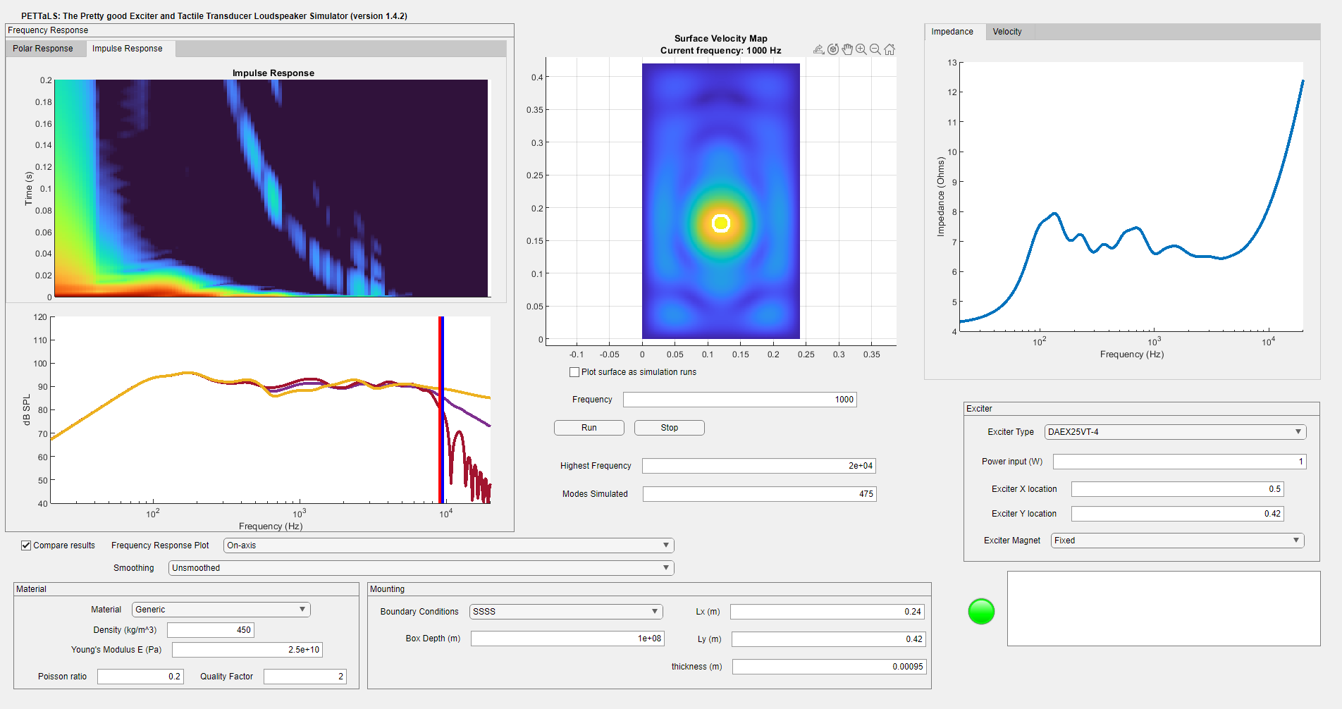

I thought it might be interesting to talk about what the results of a "good" DML design might actually look like in Pettals.
So I am inviting those who are interested to come up with a virtual design that looks good to you, and share it with the rest of us. The idea for the time being is to simply assume that Pettals is perfectly accurate, and find and share a design and response in Pettals that looks like the response you would like to see from your own DML panel. Use whatever material properties and configuration that you want.

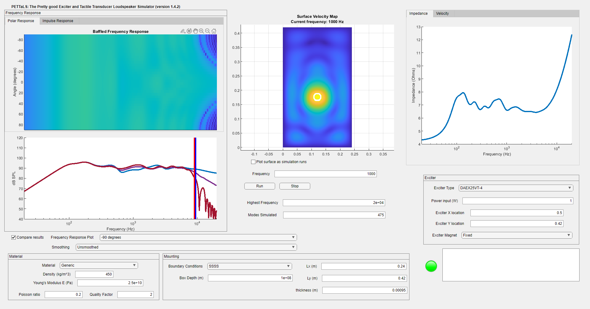

The design/response below is my first entry. In the interest of being realistic (or close), I tried to limit myself to:
Below is what I came up with, the second screenshot is the same as the first, but with the impulse response plot selected instead of the Polar response.
Some points:
Eric
- Designs using one of the three actual exciters in the program (i.e. not point force)
- Material properties that are (hopefully) within the realm of possibility.
- SSSS panel (I'll try FFFF next).
- Sensitivity >90 dB at 1 watt
- Flat-ish response over the widest frequency range possible, with emphasis on 100 Hz to 10 kHz
- Slight downward slope okay/preferred.
- Minimal variation of FR with angle, directivity always positive, or nearly so.
- Clean impulse response without long tails.
Some points:
- The panel properties are approximately what I get with a carbon fiber balsa sandwich, but for this design I need balsa and cf fabric about half the thickness of what I have made before.
- I chose a thickness that put the coincidence frequency and exciter cut-off frequency at the same value. However, since the panel is not isotropic the prediction of fc is dubious.
- The panel size was made just large enough to get the fundamental frequency (first impedance peak) at around 100 Hz.
- The aspect ratio and exciter location were positioned by trial and error to get the flattest possible response.
- I used a Q of 2. I'm not really sure if it is really possible to get Q quite that low. Using Poron foam on the perimeter with the thicker versions of these panels resulted in a Q of near 3, I think. I don't know if Q will be higher or lower with a thinner panel. Using Q=1 gives an even flatter response, with virtually no cost in output, but setting Q any lower than 1.0 starts hurting output SPL.
- Probably the weakest part of the response is around 1000 Hz, were there is a bit of a dip in the on-axis response, and the DI goes slightly negative, but otherwise I think the simulation looks pretty good.
Eric

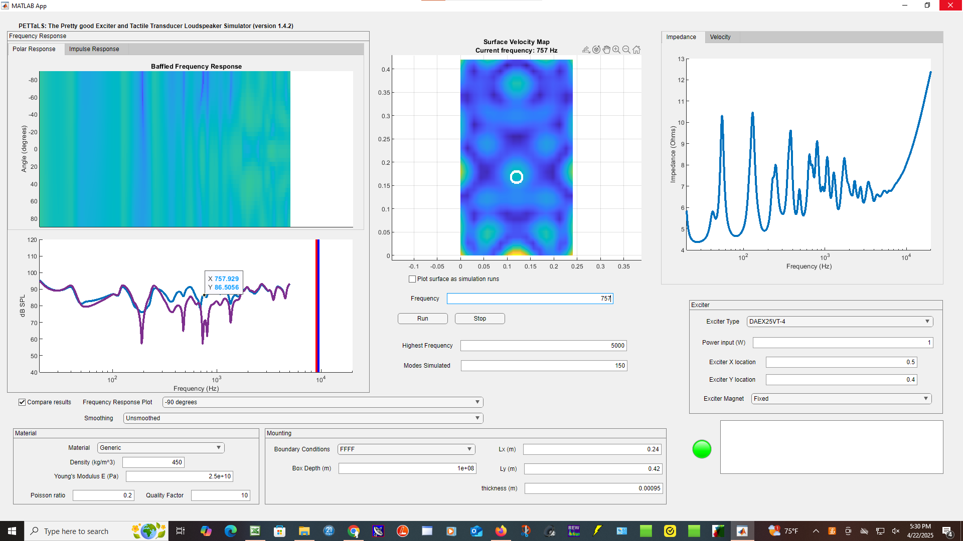

I just tried this sim of an FFFF plate with the exciter in the center of the X direction. I was surprised to see that the responses at +90 and -90 are pretty different, particularly in the region of 150 Hz to 2000 Hz. Interestingly, in that same frequency region, the surface velocity maps look very symetric, like the one shown at 757 Hz. I have not see anything like this with SSSS conditions.
Any thoughts?
Eric

Hmm... something is strange. With the transformer, I wouldn't expect the BL² is involved in this circuit. The resonance frequency of the LC circuit is around 32Hz which is not the typical frequency resonance of an exciter (voice coil side).When you translate everything back to a purely electrical circuit without the transformer, these values sound right (e.g. there is a factor of BL^2 difference between my values and your ranges).

Eric... If customwood (a very dead material) is listed at a Q of 5, I don't think a CF/balsa sambo is going to be 2... What does the graph look like @Q = 5?I used a Q of 2. I'm not really sure if it is really possible to get Q quite that low.
Eucy
Great initiative, thank you Eric. Obviously it would be fantastic the day when Pettals designs are actually built, measured and listened to. I am sure this is not too far away. I lurk here with interest.I thought it might be interesting to talk about what the results of a "good" DML design might actually look like in Pettals.
Eucy,Eric... If customwood (a very dead material) is listed at a Q of 5, I don't think a CF/balsa sambo is going to be 2... What does the graph look like @Q = 5?
Eucy
You are right for sure that the Q of the CF/bala combo itself isn't going to be as low as 2. I can't recall if I tried estimating the Q of a free cf/balsa panel or not, but I would guess it's closer to 50! Cf/balsa itself is far from dead. But what I'm suggesting is that (just maybe) with the incorporation of a strong damping at the perimeter, that a "system Q" or "equivalent Q" of about 2 just might be possible.
Also, I think it's worth noting that (as I understand it) the Q in the model is intended to represent the Q of the material itself, rather than the "System Q". So you can argue that I am "mis-using" the model by trying to include the perimeter damping into the "panel Q". But until Dave incorporates an explicit "perimeter damping" input (i.e. reflection coefficient?), the best way I can think of to include the effect of perimeter damping is to think of the "Q" in the model as the overall system Q rather than simply the Q of the panel itself.
I do wonder how much difference it would make if the damping is inherent in the panel itself vs. coming mainly from the perimeter. That is, say you could make two panels with the same modulus and density, but one with a Q of 2, and the other a Q of 100. Then you mount the Q=2 panel to a frame using something that adds virtually no damping of its own, and mount the Q=100 panel using something that adds loads of damping. Would the resulting response be very similar for the two panels, or not? For now, I'm making the assumption that the difference would be small, but only because Pettals doesn't yet have a feature to model perimeter damping separately.
Eric
