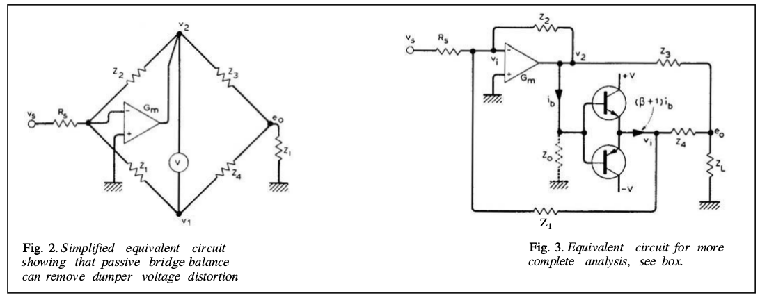

My French isn't great but it seems to me that Fig 8 is discussing a voltage amplifier, G, driving the transistors. The Quad is described by Vanderkooy and Lipshitz as using a transconductance amplifier (see below). So I am not sure what the Quinquis article is trying to show.Page 5 of Quad 405 : analyse d'un schéma
It's about the output impedance.[/IMG]
In the V & L model it can be seen by inspection that the output impedance changes when the transistors start to conduct (because they add current gain). It can be shown by simulation too. A constant output impedance being caused by using a bridge arrangement is not correct IMO.

Thanks for trying this out. I think I need to see what your models are to comment usefully. The linear amp needs to be a transconductance amp. The amount of NFB needs to be the same in both.I made a simple model with a resistive bridge, an ideal x100 amplifier and a simple class B transistor buffer with zero bias.
The distortion at 1V peak was about 0.1% and only 3rd harmonic.
Changed to a standard negative feedback only and distortion was 0.3% 3rd and a slew of higher harmonics

For a start there is no feed-forward involved in the proper sense. This is very much a NFB system. In the V & L simplified model, the output impedance is the result of NFB and is not linearized by the "bridge" arrangement. Regarding distortion, the perfectly balanced bridge makes it as good as conventional feedback topology and unbalanced makes it worse. There must be another reason they chose a bridge but I haven't figured that out yet (unless it was just for marketing).
The actual circuit Quad built is very complicated. They appear to have added a number of extra components that appear to be for stability reasons. It really needs to be simulated to see what it actually does.
The current dumping principle is quite clever. Walker and Albinson had to figure out that one can make a bridge circuit with an inductor, so the low-frequency output impedance and the power losses remain low, and that the path from the dumpers through the inductor to the output could be largely cancelled by the other path with a resistor, the integrating class-A transimpedance amplifier and another resistor. In fact finite DC gain of the transimpedance amplifier can be cancelled with nonzero DC resistance of the inductor.

I have studied the error correction topologies. As far as I can understand them, there is always some kind of negative of feedback in their scheme.For a start there is no feed-forward involved in the proper sense. This is very much a NFB system. In the V & L simplified model, the output impedance is the result of NFB and is not linearized by the "bridge" arrangement. Regarding distortion, the perfectly balanced bridge makes it as good as conventional feedback topology and unbalanced makes it worse. There must be another reason they chose a bridge but I haven't figured that out yet (unless it was just for marketing).
I agree with that.The actual circuit Quad built is very complicated. They appear to have added a number of extra components that appear to be for stability reasons.
Ask yourself what the output impedance of a class B amplifier is during the switching point, it is off course very high, the output impedance of the current dumping amplifier is very low due to the class A error correction amplifier.
