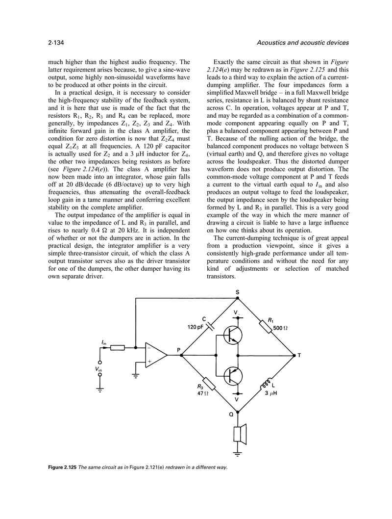

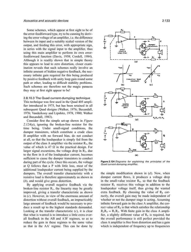

Baxandall's analysis (from Talbot-Smith's book) :
attachment.php
attachment.php
Ok I know I'm rustling feathers by poking this sacred cow. I am sorry. But what would you have me do?
I see errors or oversights in all these papers. I see gross exaggerations in PW's description that I would not expect to be tolerated except perhaps in commercial audio where everything seems to be allowed especially if it looks unusual and stirs interest.
Do you want to understand the reality behind stuff or is DiyAudio a place where being awestruck is a protected characteristic?
The only gross exaggerations I've seen in this thread were those in your posts. The same holds for incorrect analyses and incorrect quotes. (My earliest posts about the Quad listening test were also wrong, of course, but I've corrected that.)
Regarding Walker's claim that the dumpers in a current dumping topology need not be linear: he backs that up with an amplifier achieving <0.01 % distortion with a class-C dumper stage.

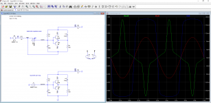

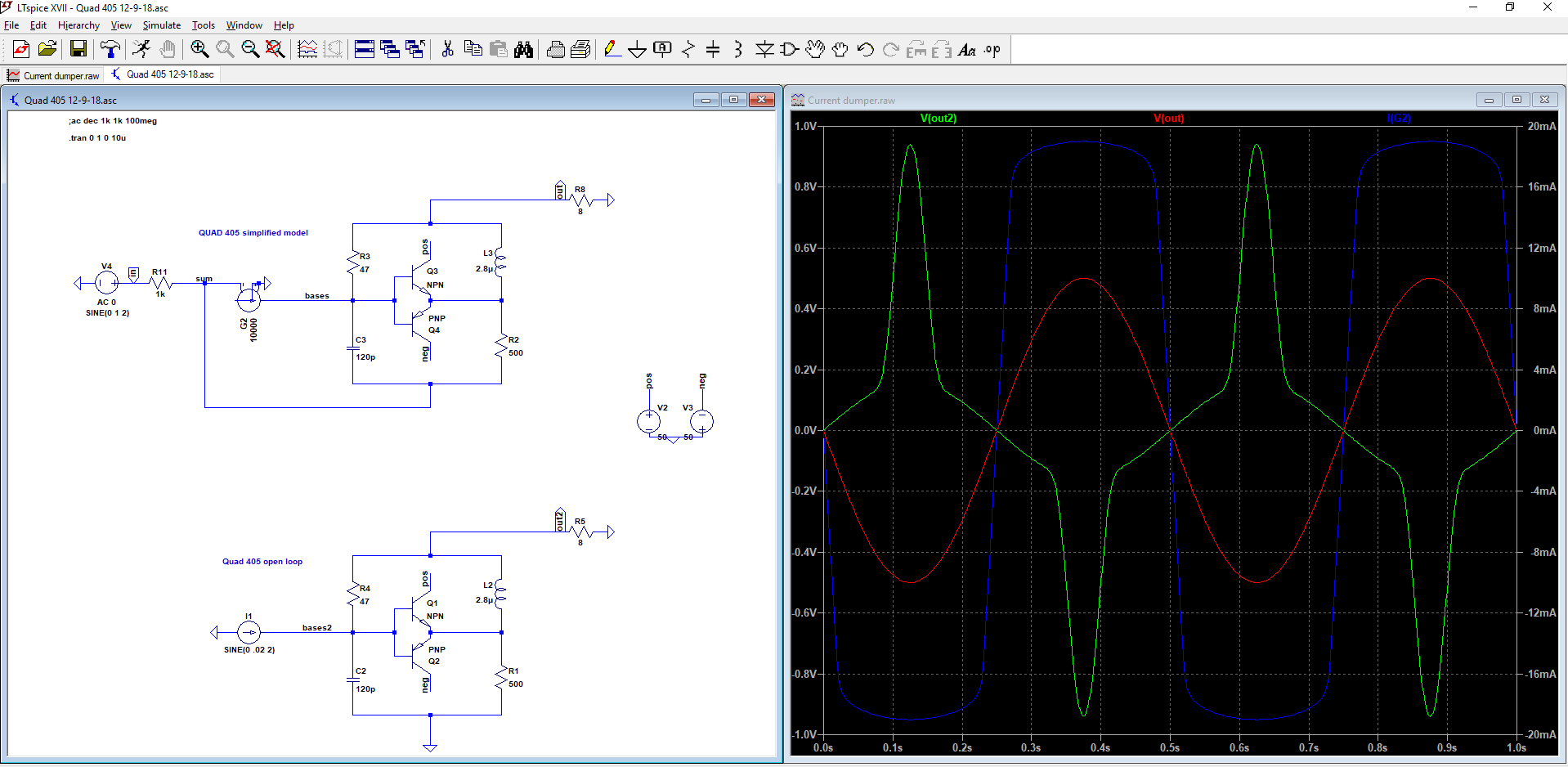

I've knocked up a couple of LTSpice circuits for anyone to play with so you can see for yourselves what is really going on.
The top circuit is a simplified version of the Quad 405 based on PW's paper. It is not exactly the same as the real circuit but is good enough to show the principle of operation.
The bottom circuit is a version operating in open loop.
Note:
The yellow curve is the voltage output of the open-loop model (bottom). It is not linear at all as you should expect. The Quad does not add any non-linear components that could cancel this distortion away so instead relies on a lot of NFB to reduce it. The Quad's transconductance amplifier (aka class A amplifier) has to output a very distorted current to compensate and this is generated entirely by NFB.
The blue curve is the transconductance amplifier's current output in the closed-loop model (top). You can see it is extremely distorted. The power transistor distortion has not been cancelled. The high NFB reduces the distortion at the output (red curve).
