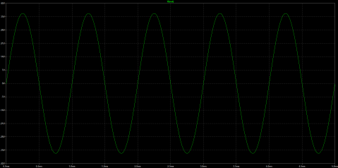

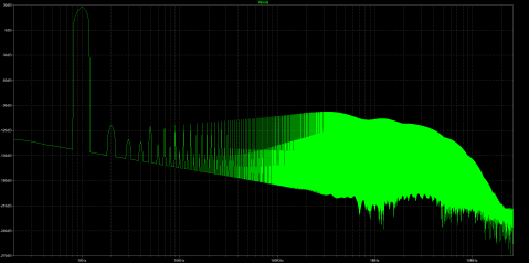

For f -> 0 it indeed becomes a simple negative-feedback amplifier, as I already mentioned at the end of post 86. What's more interesting is what happens at higher frequencies and how the distortion at the output then compares to the case without the inductor.
Indeed. I've just done a few more simulations at 20kHz.
In a conventional output where the power transistors are biased on, the magnitude of Vbe swings is much much lower. So the Vbes distort the Miller feedback a little but that's tolerated, and usually there is another global NFB around the whole amplifier too.
In the Quad the Vbes dead zone is a huge 1.4V or so. To keep the circuit stable I think they had to use a relatively large 120pF compensation capacitor. You know, to stop it trying to be a radio transmitter. The combination of wild Vbe swing and large C, and the absence of any additional global NFB, made this distortion a show-stopper. Fixing this necessitated the invention of using a balanced bridge, which is very effective.

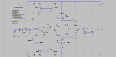

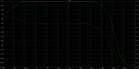

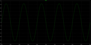

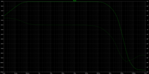

There is one more implementation of current damping idea, I found it at diyaudio but cannot remember who's the circuit is?
That's what I'm thinking. What do you think?

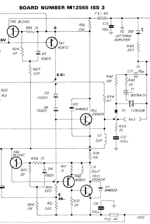

To the class-B (or C) bias of the output stage: you can see the evolution in thinking in subsequent versions. The original had zero bias, but later on you see that first they relocated the base of the NPN to obtain some bias (1 Vbe) and later added an extra diode (D6).
The impression I get (but cannot prove) is that PW wanted to make a statement but later realized the class C was rather extreme 🙂

it's a high current class A driver stage ( 50 ma ) into Quasi comp all NPN output stage.
The PNP vas transistor can push several amps due to the buffers driving it.
the low side NPN has a PNP driver and 10 ohm base shunt for high speed.
the updated version has a diode between the two to party bias them.
the crossover distortion is handled by the 47 ohm resistor from VAS to output.
it works very well.
The amp is a low gain current feedback design driven by an op amp with a gain of -10 ish that also performs servo duty.

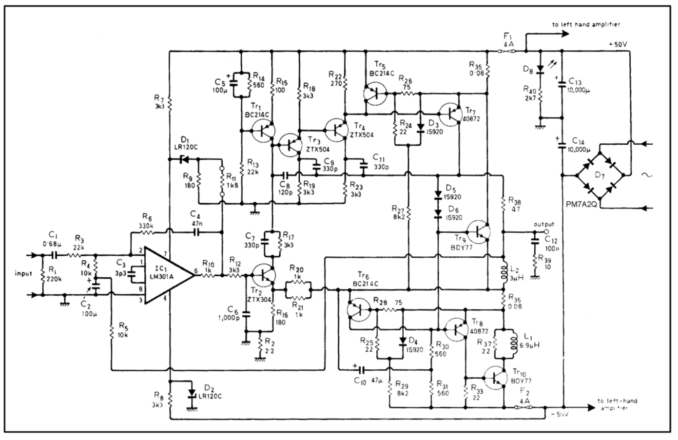

It's a tricky design challenge. The bridge can only stop Vbe feedback through the 120pF & 500 ohm parts. The bridge cannot stop parasitic feedback in the transconductance amplifier: for example the Ccb of the driver transistor Tr7 (RCA 40872). Quad has added C9 and C11 feedback paths too, presumably for stability reasons. I did not notice this mentioned in those articles but I would note parasitic feedback paths as another reason the Vbe feedback distortion can not be completely eliminated in practice.
Stability may also relate to Chris Daly's citation of Keith Snook's "proper location of C8". In the theoretical model, the 120pF and 500 ohm resistor should both connect to the same point of input to the transconductance amp. In the 405 that would mean 4 BJTs sequentially in the signal path of the NFB loop. Asking for trouble. I didn't read it carefully but I think Snook had to bypass one of them in order to relocate C8; maybe for this reason.
Another question in my mind concerns the output stage. The transconductance amp bias is about 45mA and this drives the BDY77s. Sort of short on current compared to conventional designs. The current limiter (about 8A?) is only on the positive rail but I doubt the negative could reach that with only 45mA drive current when the BDY77 has max gain of 140. Ok so you don't absolutely need 6A at normal listening into efficient speakers but it will run out of puff with 4 ohm loads and below.

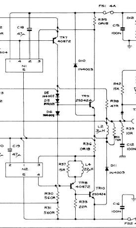

Current limiting is on both positive and negative rails - the current sense resistors are the two 0R08 resistors on the schematic you posted. Mislabeled as R35 in both positions on your schematic
Good catch, thx. And TR8 allows more than 45mA to TR10 so the neg protection can kick in. Should have looked more closely at that bottom section.
