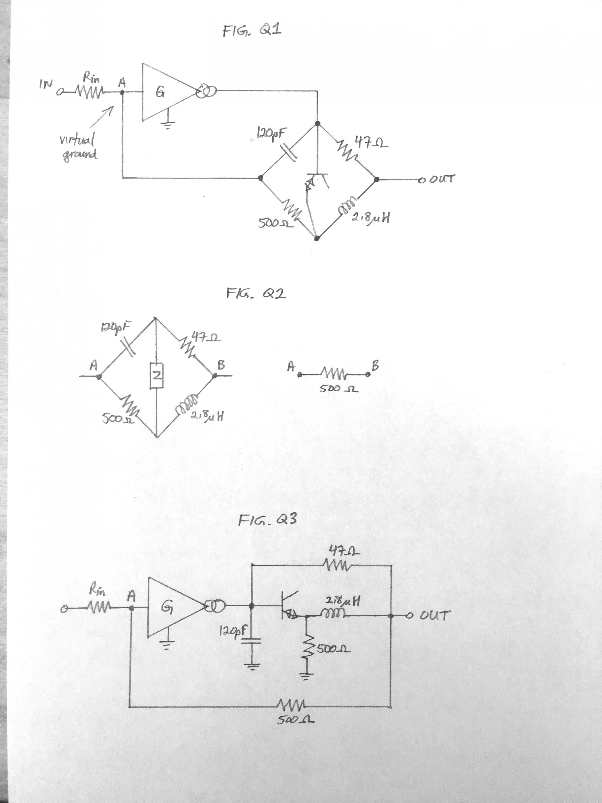

Here's my take on the Quad 405 current dumper. What have I got wrong?
(I'll try not to be too "engineery" but this is an engineering subject after all...😉 )
Fig. Q1 is the same simplified model as Vanderkooy & Lipshitz's except that I have used the actual bridge components and values. I put the real parts in to make it easier to see what is going on.
Here is the crux...
Fig. Q2 shows that the impedance between points A and B of the balanced bridge is 500 ohms. This is independent of any Z in the bridge - shorted, open, transistors, whatever. This is what a balanced bridge does. If it is not balanced then Z plays a role.
In Fig. Q3 I draw an equivalent to Fig. Q1 based on point A being a virtual ground and the bridge connection to point A being replaceable by a single 500 ohm feedback resistor from the output (based on Fig. Q2).
If you have got this far and agree, then please read on.
Fig. Q3 is a conventional NFB circuit around class B (or C if you prefer) power transistors that is relatively easy to understand. It uses the same components as the balanced bridge form but because the feedback is taken directly from the output the circuit is always "balanced" no matter what component values you choose (ie: the Vbe voltages do not have to be balanced out by a bridge because they aren't in the feedback path anymore).
>> So one question I have is why did Quad use the Fig. Q1 circuit rather than the Fig. Q3 circuit as the latter needs no balancing?
Examining Fig. Q3 you can see the 120pF capacitor introduces an integration into the amplifier response. This slows the thing down and helps with the issue Jan pointed out earlier that the voltage on the power transistor bases will tend to slew extremely rapidly. Without the capacitor I image the circuit would be totally unstable.
The 47 ohm resistor allows the amplifier to drive the output directly and this is what happens in the "gap" when both power transistors are off. The open-loop output impedance of the amplifier is about 43 ohms (there is some shunting from the inductor and 500 ohm resistor). This is huge so the NFB is really keeping the output impedance usably low. Note also that the power transistors will start to turn on at around 0.6V, say, so the transconductance amplifier is only supplying about +/-13mA before "dumping" kicks in. Not a lot of class A - pretty much the same as some conventionally biased class AB amps. Note also that since the class A amp has to draw this current all the time there is no net power saving by having unbiased power transistors.
Normally, no designer would put a 2.8uH inductor between their emitter followers and their feedback point. This adds another complex pole in the loop. So I imagine the Quad 405 is a sod to keep stable into difficult loads, especially capacitors.
I wonder whether many of the topology decisions in the Quad stem from trying to stabilize the real circuit.
Bonus question: If you start with the circuit of Fig. Q3, how would you improve it?

It is easy to see that this is wrong. Just substitute Z -> infinity (remove Z) and calculate the impedance between A and B at zero frequency and for frequencies approaching infinity:
f = 0: capacitor is an open circuit, inductor a short circuit -> impedance between A and B is 500 ohm.
f -> infinity: capacitor becomes a short circuit, inductor an open circuit -> impedance between A and B is 47 ohm.
In fact you get the same values for the impedance between A and B at zero and at infinite frequency for any value of Z, removing it just simplifies things a bit.

I don't. Your Fig. Q2 is wrong and even if it were correct, the step from Q1 to Q3 would be unclear.
The way I see it is as follows. It is an oversimplified analysis that neglects all kinds of second-order effects, but it does explain the basic operation:
Look at Q1 but replace the dumpers with an independent voltage source connected between ground and the node between the 500 ohm resistor and the 2.8 uH inductor. You then have a simple linear time-invariant model. If you can show that the transfer from the independent voltage source to the output is zero, then it doesn't matter what the voltage provided by the voltage source looks like. In particular, it doesn't matter if it is a distorted version of the signal you want to listen to.
Since the model is linear, you might as well calculate the transfer to the short-circuit current from the output, rather than the voltage. When the transfer to the short-circuit current is zero and the output impedance is finite, the transfer to the open-circuit voltage must also be zero.
The voltage Vdumper produces a current Vdumper/(j omega L) through the inductor to the output. That is, the current is inversely proportional to frequency and has a phase shift of -90 degrees.
Voltage Vdumper also produces a current Vdumper/500 ohm into the virtual ground node, assuming a perfect virtual ground. Due to the 120 pF feedback capacitor, the output voltage of the integrating class-A part is -Vdumper/(j omega 500 ohm 120 pF). Through the 47 ohm resistor, this gives an output short-circuit current of -Vdumper/(j omega 500 ohm 120 pF 47 ohm).
The total short-circuit output current due to Vdumper is Vdumper/(j omega) * (1/L - 1/(500 ohm*120 pF*47 ohm)). This expression becomes zero when L = 500 ohm*120 pF*47 ohm = 2.82 uH. The path through the inverting integrator then precisely cancels the path through the inductor.
Back from the model to reality: in reality there is a cancellation, just like in the oversimplified model, but there are some imperfections that limit its efficacy, such as:

Aside from this, is there anything substantively different between Fig Q1 and Fig Q3?
Let's name the upper node "C" and the lower node "D". D is the junction between the inductor and the 500 ohm resistor.
You describe attaching a voltage source between D and ground?
If so, the transfer from the voltage source to the output, node B, will definitely not be zero. The bridge function requires both C and D nodes to float. But a voltage change between C and D will not transfer to the output.

The current flowing from node A to the virtual ground will always be [v(B) - v(A)]/Z where Z is the impedance between nodes A and B.
Therefore, the connection between virtual ground and A can be replaced with an impedance Z between virtual ground and node B (output) and node A can be grounded.
Virtual ground is assumed to be close enough to ground to make no substantive difference.
Yes, Q1 is a very clever distortion cancellation circuit whereas Q3 isn't.
You completely ignore the fact that there are things connected to the "bridge" at other points than only nodes A and B. If both the output of the class-A amplifier and the dumper were connected at node A or node B, I would agree, but they are not.
Hence, this statement is also wrong.
Yes, I do.
If you forget for the moment that there are people who call it a bridge, do you see any flaw in my calculation?
