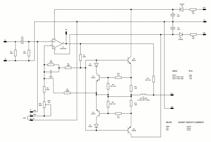

I have a 405 based circuit, basically Keith Snook mods plus complementary output stage using mjl3281/1302, I measured the track capacitance and wound the coil to match and it does sound very good, certainly a lot nicer than the naim type sound which is much too harsh for my ears. The basic Walker design is very clever and I think the reason it sounds so nice is that the speaker always sees a low impedance path due to the class A stage plus at the point the dumpers switch the class A is there to mop up some of the nasties.
Just added an LTSpice file for those interested, I did do a PCB but I am not sure how up to date it is, however if anyone feels brave you can have the kicad files. COD is for Complementary Output Dumpers and of course fish puns...
