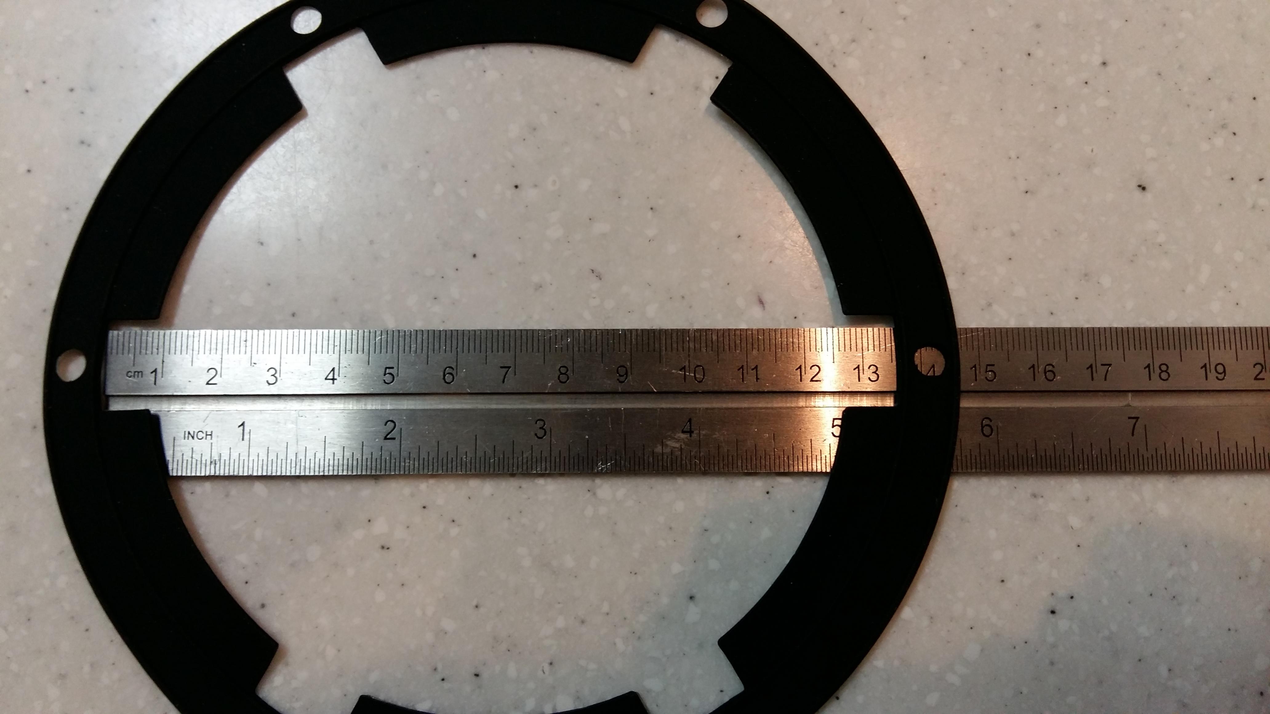

Down to the end of making the pensils. I gave my friend the published dimension for the driver cutout: 139mm. The hole, as measured with calipers yesterday came out at just under 140mm. Awesome....not! The pictures attached show a basket width of 136mm. I measured the driver and the gasket of the Alpair 10p.
Has anyone else seen this? I suggested to Mark's employee to look into it....

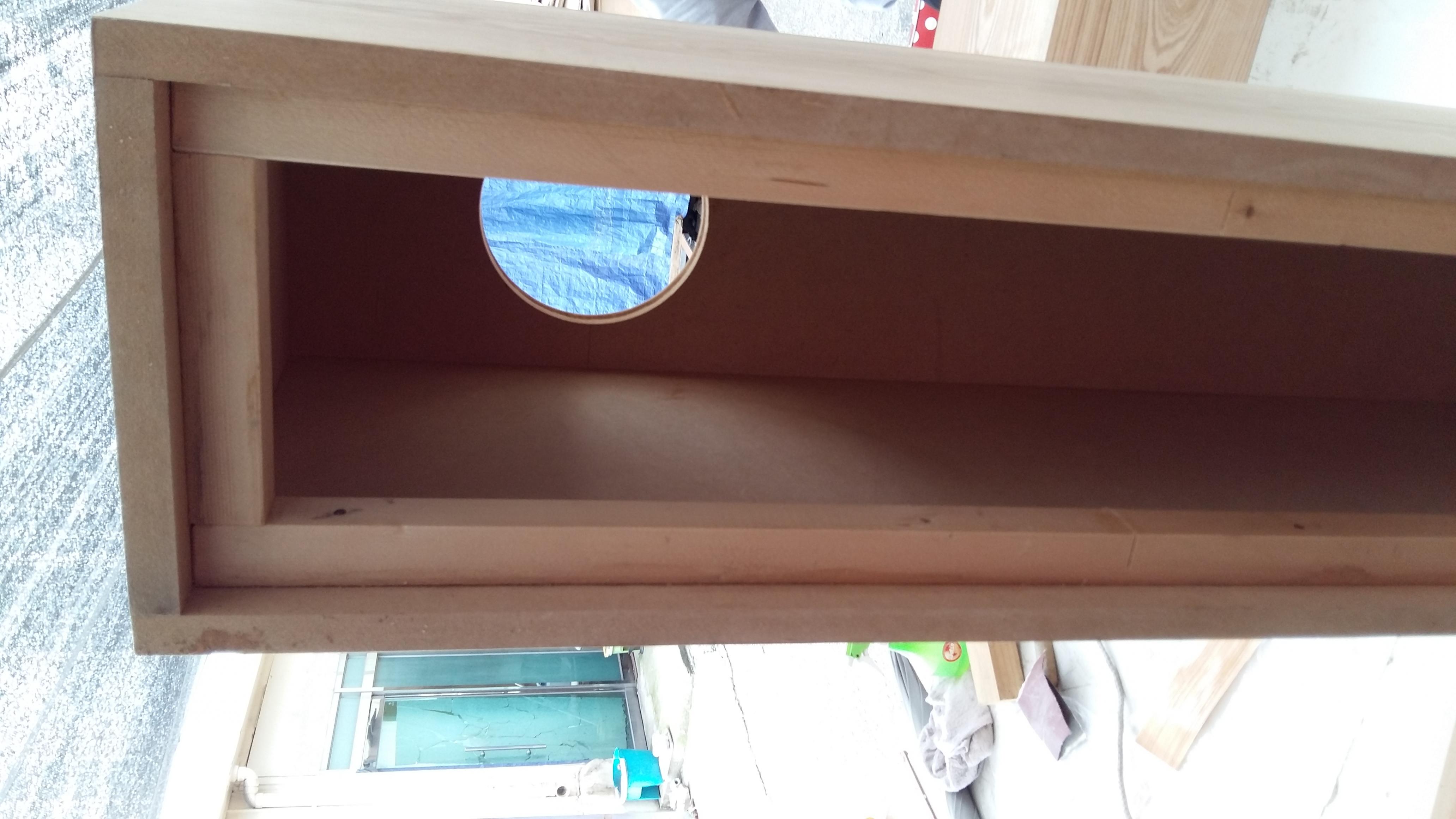

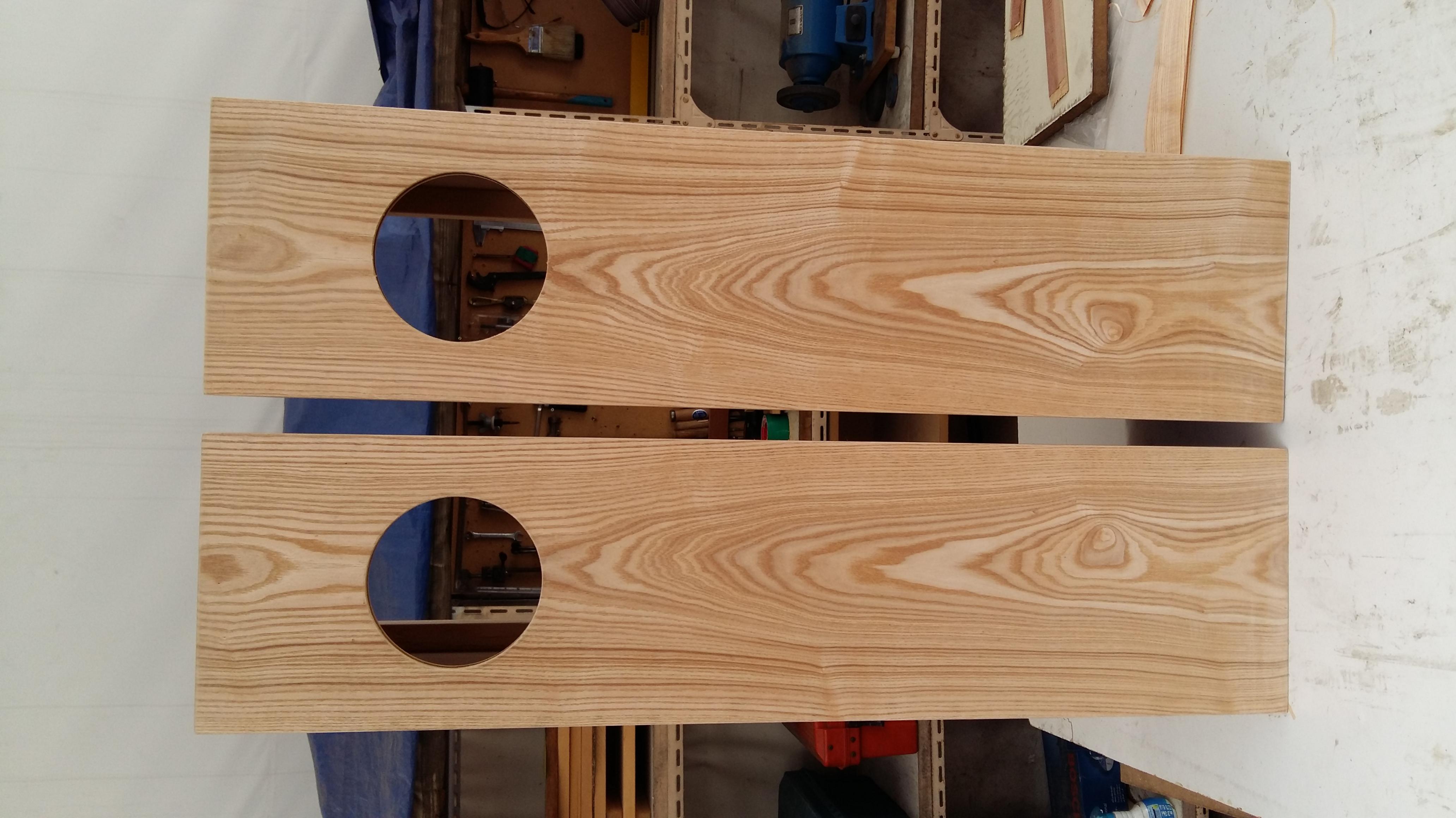

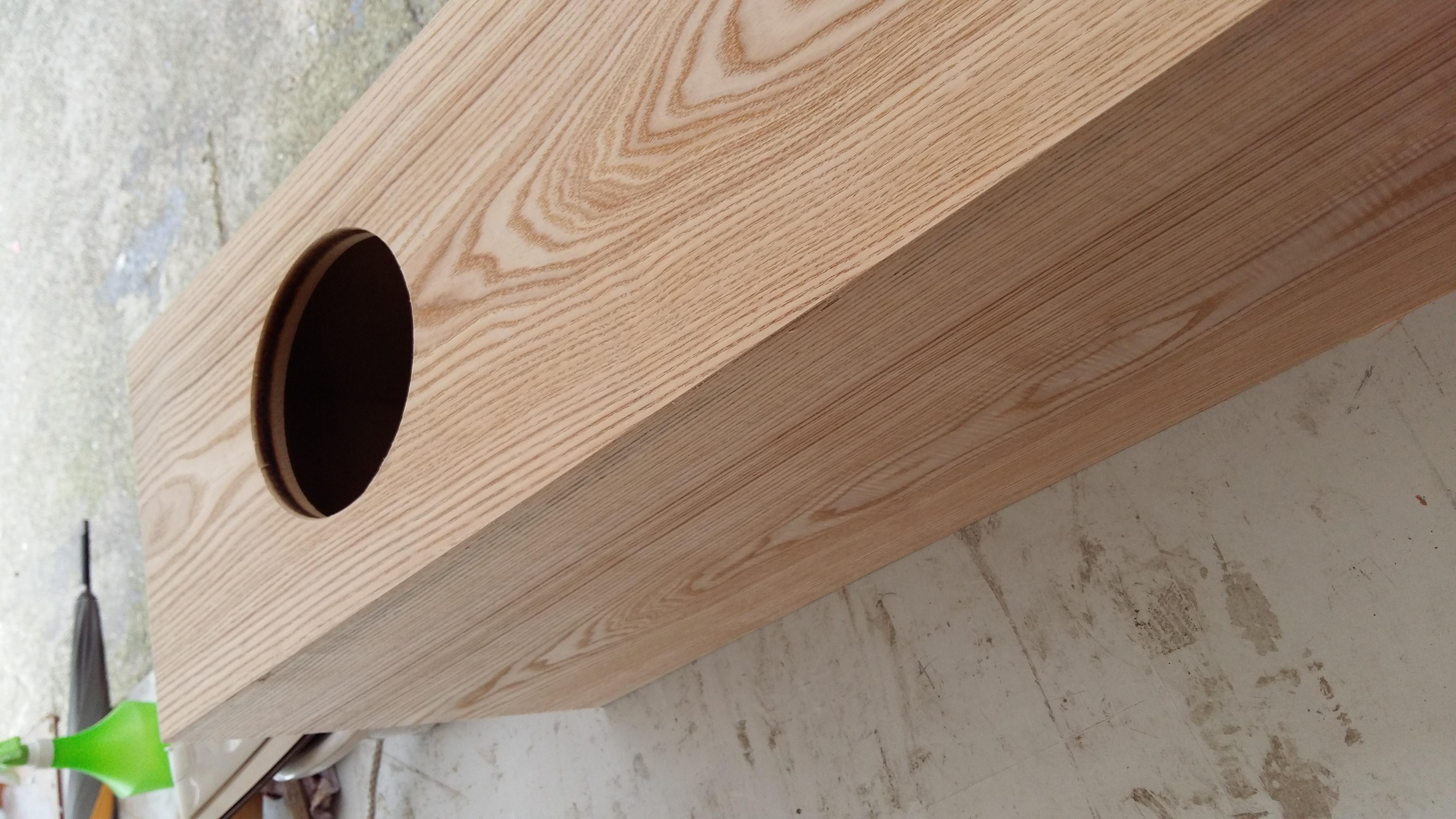

A couple of picks of the pensils before the satin clear coat. Not great plywood here so used MDF. The veneer is white oak nicely book matched. The vent is on the back. I'll post more soon.

Have you chamfered the insides of the diver cutout? From the photos it does not look chamfered.
