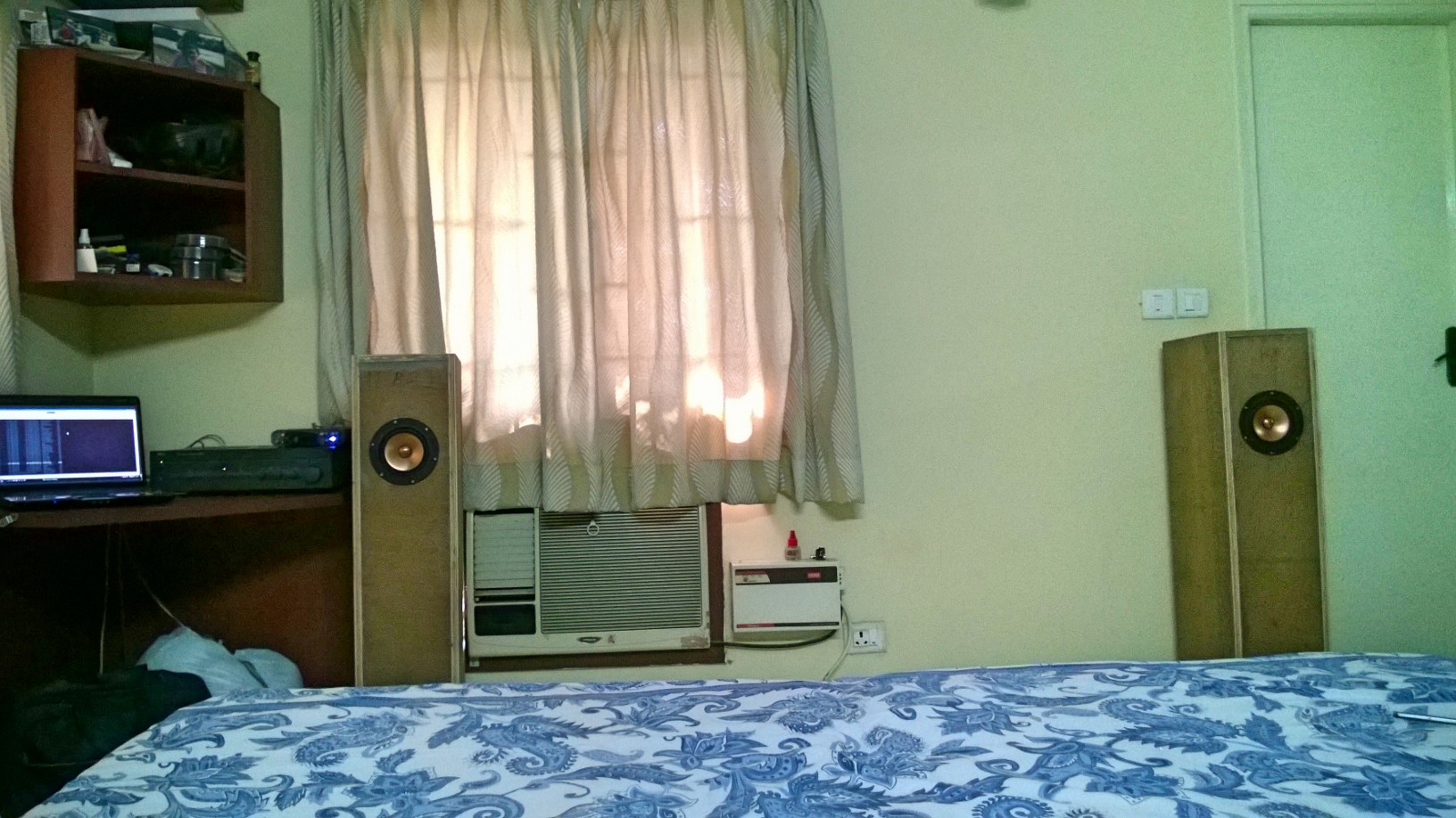

Attached is my WIP speakers.Have not sealed the back plates yet....After burn in plan to do it next week end.

My room size is 16x15 .My set up is a Windows pc stripped down to barest possible services,with ASIO as the output .M audio USB PRO DAC,NAD 320 BEE amp and the audio files are Aiff's(transcoded by iTunes) and no EQ'ing on Foobar and no filter applied on NAD.

PS:Further these speakers are very very sensitive to listening from different positions other than the identified sweet spot for listening

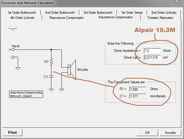

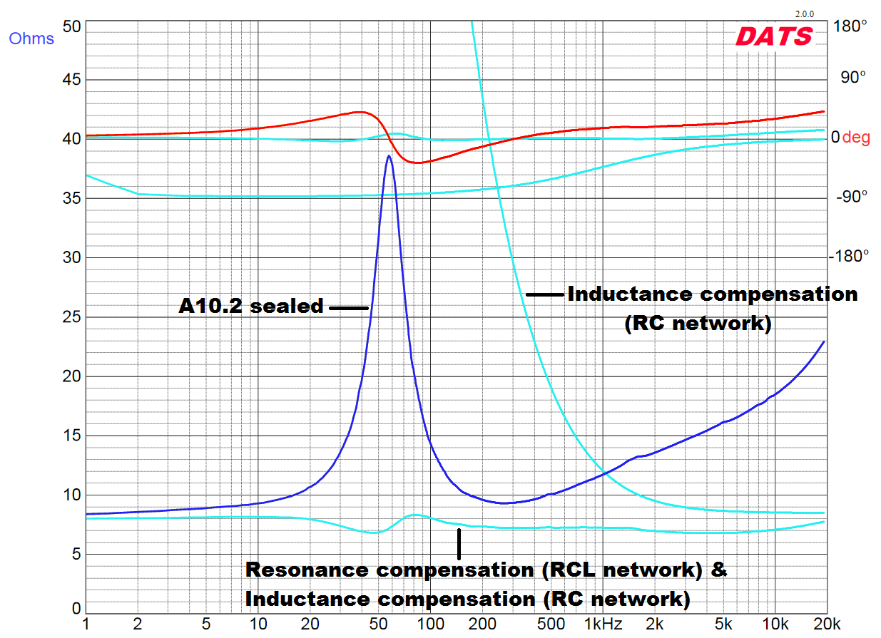

To tame the top end you can try a impedance compensation in form of a resistor and capacitor (RC network), the network does not change frequency response but most ears can hear a difference in middle to high frequency. Attach a schematic and values to be used based on A10.3M datasheet and the driver in free air. Because our box change the actual value to be used regarding the capacitor value i would guess try values from 1,4uF and down to 1uF. To get the right component values combine multiple ones in series or parallel or both series/parallel. Under listening trials if using low volume you can use small cheap components as example 0,25watt resistors and 16volts capacitors, but remember if you like the network to buy higher wattage and voltage components for the final network and higher system volume. The network should be placed in the speaker end of the speaker cable, and from own experience i seen amps that when turned on with speaker connected don't like a sudden change in impedance when live adding the network then they begin to oscillate, to get around this live connect only the network when power amp is turned off or disconnected the speaker. I see you have computer as player so if you like you can download REW and use it's build in feature to measure speakers AC impedance and plot the correction this RC network will give.
To see what happens attach a picture with 3 times impedance plots, one is my A10.2M driver in sealed box, one is a RC network alone, and one is A10.2M in sealed box with a resonance compensation (RCL network) and a inductance compensation (RC network), all the measurements are taken thru 4 meter cat5 solid core as speaker cable. The plot is done with a special soundcard and program that package is called DATS but you can do the same with our own soundcard and the free REW program.
