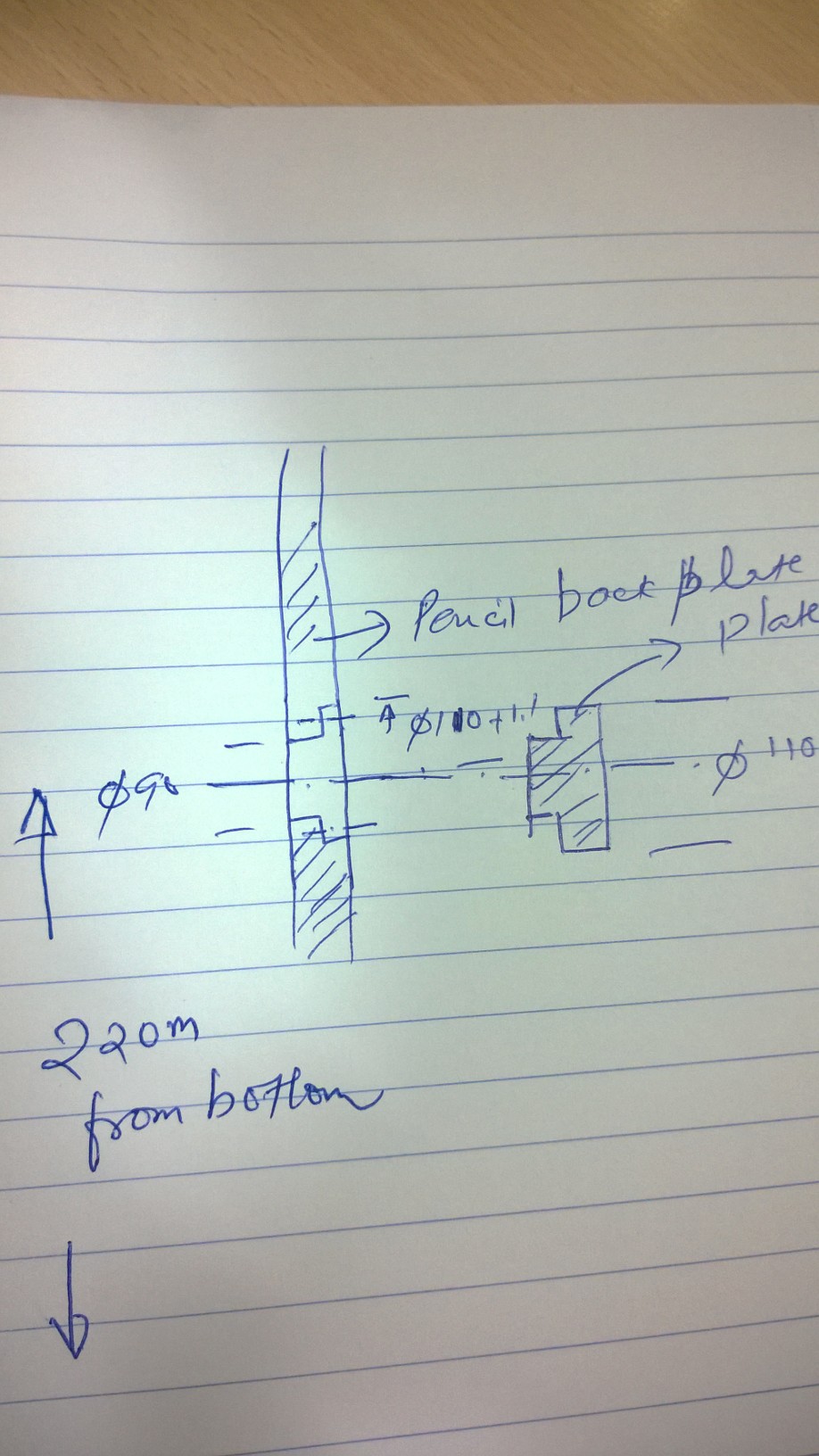

I am yet to finish the gluing,as I am stuck with how exactly I can proceed to stuffing and sealing the back plate,not having gone with the internal cleats suggested.
Currently I am thinking to have a stepped hole of 90 dia /110 dia and have the center cut pieces for the driver,turned to a stepped dia plate to go in to the hole(ref attached sketch) ,on which I can have the banana binding posts.So to add to stuffing I can remove this plate which will anyway be flush,reach across to bottom corners till just above the vent .And will be handy for sealing the bottom half of the back plate.
I have also taken the suggestion of a double baffle for the speaker mounting and glued a 12 mm MDF and cut a through hole for speaker clearance.This week end it should be done,except finishing.Also I am going in with M3 hex bolt and D nut,as I am concerned this wooden screw mounting may not last for long given I may have to remove and mount the speakers many a times during the stuffing and finishing stages.
Suggestions /advice welcome...Thanks a lot folks
