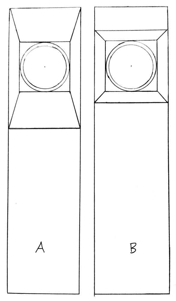

Just to add, the oval supra-baffle is Bob's signature look... you can try a simpler SB like one which is a circular in shape with round/chamfered outer edges.
Zman01, I have been sketching today and think I will be trying a rectangular based truncated pyramid that extends to the top and side edges. The bottom edge will match the top edge. Perhaps for a future build I will try a whole front baffle that is one large tapering pyramid.

I'm considering supra baffle A) in my sketch. The driver will be flush mounted.
35mm may be a little thick. At this thickness the angle on the sides is less than 45 degrees and the rake top and bottom is much less than 45 degrees.
Less than 35 mm the angles start to become very shallow, especially above and below the driver; at this point I'd consider a frisbee shape.

Faith- I almost always use only the socket head screws supplied with the drivers - AFAIC, they're more than adequate for the job. Sure, they're longer than necessary when using a single layer of 18mm plywood, but I welcome anyone to point to rigorous testing/measurements that prove the extra length protruding through the rear of mounting panel causes any deleterious effect.
I'd also agree with Zia says about 35mm being excessive - if for no other reason that if fully that thickness over the entire panel, chamfering the rear side of opening would be even more critical and tricky / time consuming
That said, I do rather like the aesthetic of option A

I'm thinking 35mm is a little much....maybe just 25mm will be enough and go nuts with a rasp...could be fun. Cutting a very acute angle with the table saw will involve a little vertical jig...hmmm

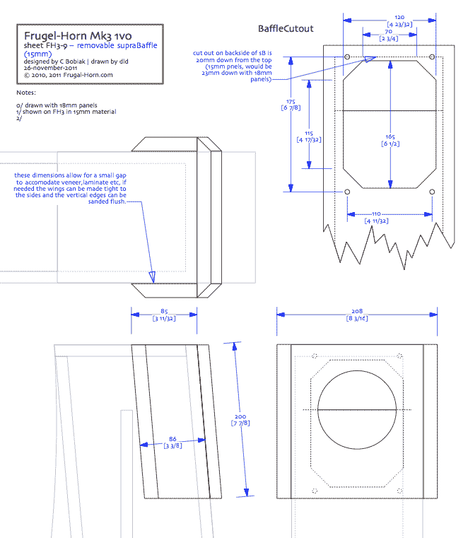

Since the supra-baffle looks like the only option now, I would suggest that you make the hole a bit bigger and rectangular in shape (option 3 suggested by Andrewbee in post #126). Keep enough material on the baffle for the Supra-baffle to get attached though 🙂. Use a gasket on the SB.
Here is a snapshot of the FH3 sB drawing that will show you how big we made the hole in the baffle.
