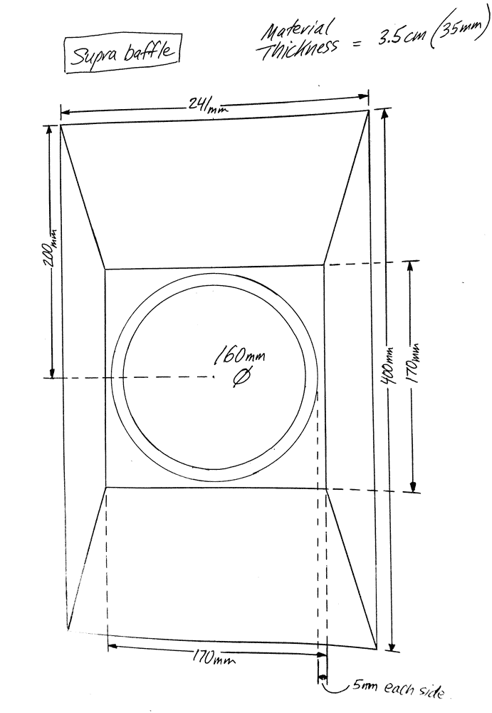

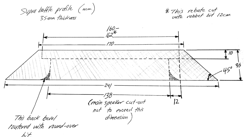

I drew up the plan with a 35mm thickness. I think it will protrude but not as much as many supra baffles. With this thickness, I get two 45° angles on the vertical sides. The very shallow (acute) angle above and below the driver is about 17°. I think I'll cut it close on a band saw and plane it down to the line.

If you have a CNC that can cleanly machine those very acute angles for the longer tapers, that's great.
I think an issue you might encounter is the depth/height of cut required for the 17dg bevel at top/bottom of your sketch. By my math, that hypotenuse works out to approx 124mm, while the 45dg on the longer sides is approx 50mm.
The latter shouldn't be too hard to cut on table saw (I'd do those last), but it could be a bugger to cut the 17dg bevels on the 241mm wide pieces on a band saw. I'd think again about using or fabricating a tenoning jig that can securely clamp the pieces vertically and set the table saw blade at the required angle. It might take a few passes to reach the maximum height of cut and would likely require a hand saw to finish off - and there could be some minor burning - but I think you'd get higher precision on all 4 cuts.
Then of course, there's the matter of the deep chamfer required on the rear side of driver cut-out. That's a lot of material to chew through, particularly by hand - the gray shaded area on attached sketch.

Thanks for that sketch. Mine is below. I got 50 mm and 120mm exactly for the two different bevels. Tricky bugger this thing. I was thinking a round-over bit would be enough for the back side. Your sketch shows alot of material to be removed....leaving only a little meat for the screws ( the reason I decided against a 1" supra baffle)
I may have to make it from 4 or 5 pieces. I don't have my own cnc but I know a place to ask.

Using the Alpair's supplied screws, and with carefully piloted and pre-tapped holes, I honestly don't think a lot of thickness of core material is actually required. I realize that my hasty sketch did not reveal that the chamfer is not continuous, but scalloped to leave full thicknes "pads" at each of the screw locations. That does of course make for a more time consuming process with thicker material.
Their outstanding performance notwithstanding, these are after all relatively light weight, low moving mass full range drivers, not 18" monster car audio subs.
For the Planet10 FH3 kit Supra baffle option 18mm BB is used, and for A7.3 the combination of the slightly shallower driver rebate and rear side chamfer leaves less than approximately 1/2 of the core thickness, which I think is still sufficient.
Of course I've used exclusively BB grade plywood in my builds for well over a decade, and not the least of its advantages over MDF or particle board is superior screw holding capacity - particularly with the narrow margins involved with this class of drivers.
A round-over bit will not remove as much material as a similarly sized 45dg chamfer bit.

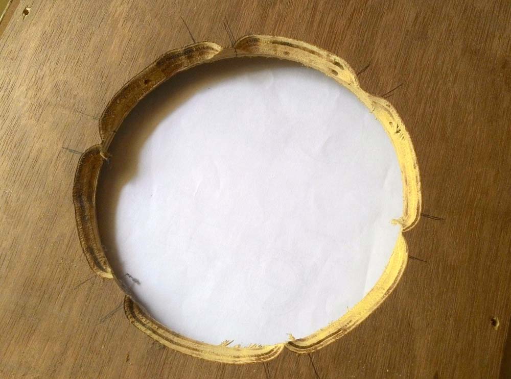

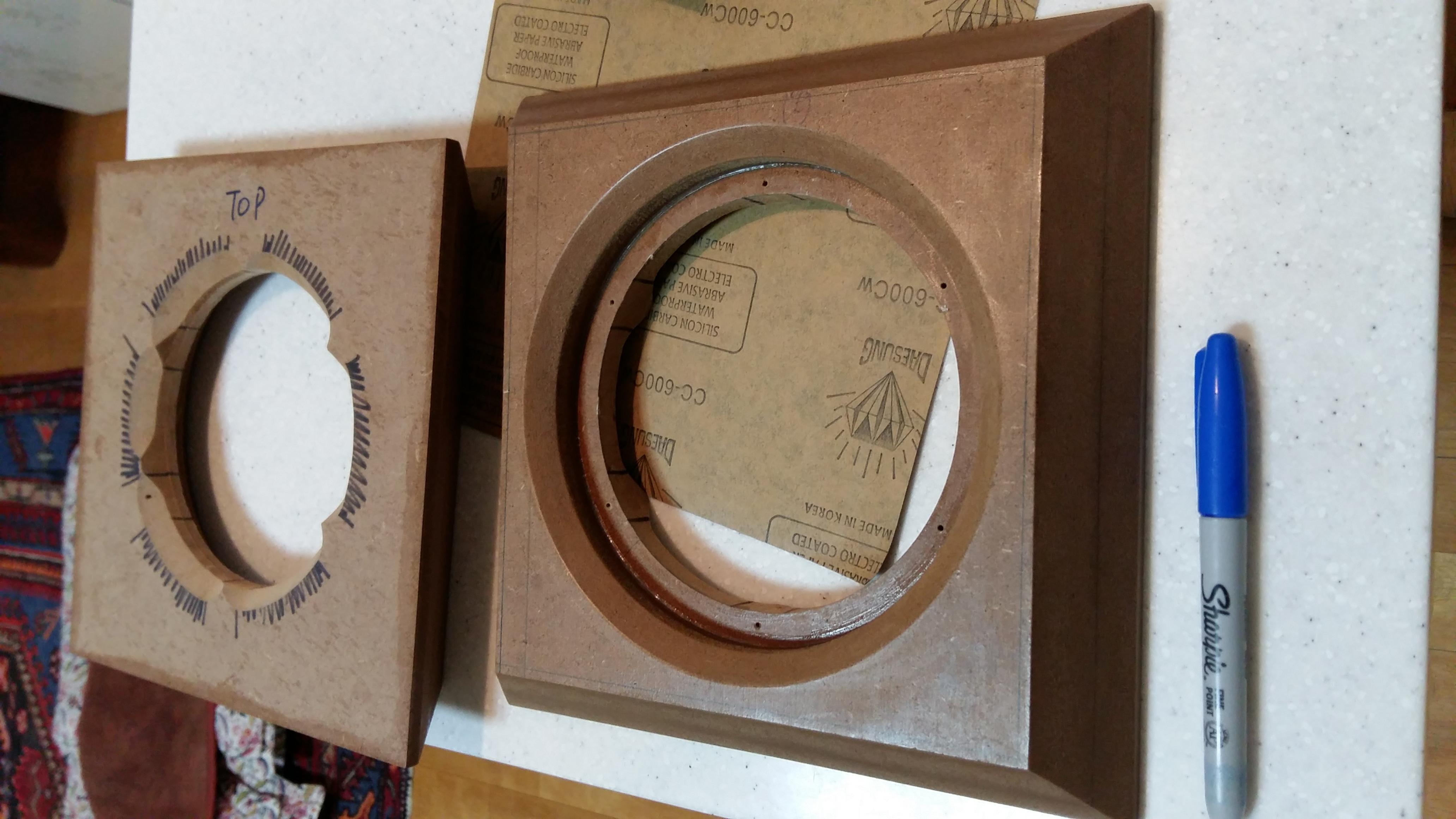

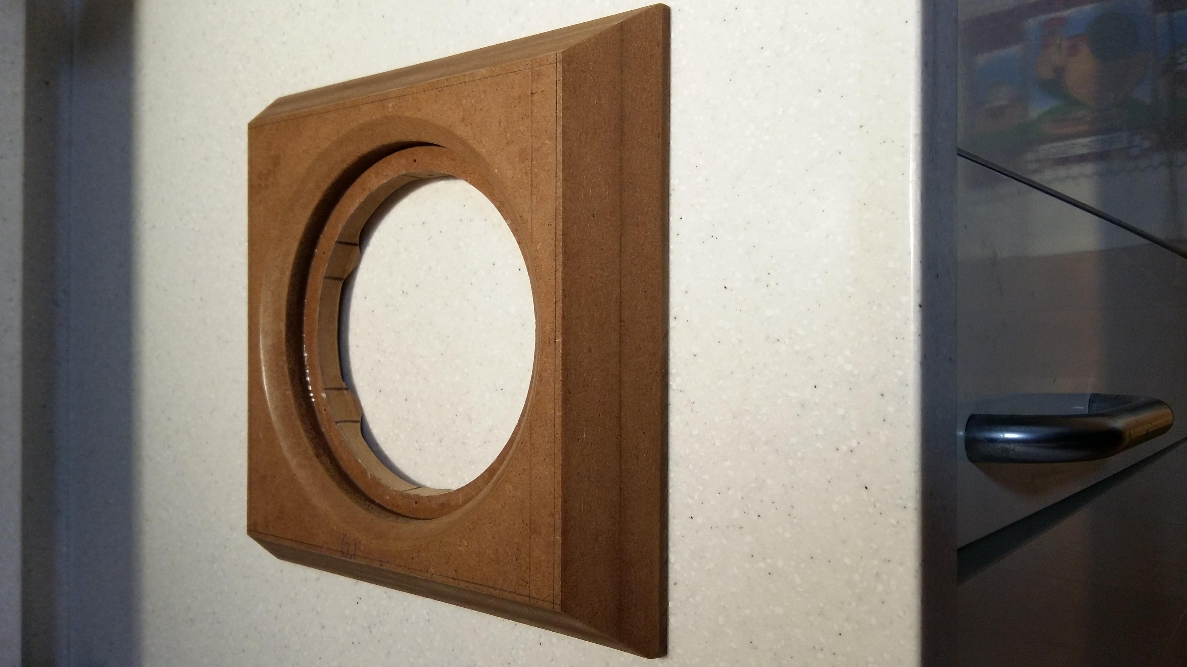

After a long break I am making progress with the pencil suprabaffles. They are the width of the box, square. Truncated square-based pyramid. The chamfor is approx 39°. The rebate is a little deep so I routered out a gentle horn. The underside is well scalloped for allowing ventilation. I will post more pictures in the next few days.
