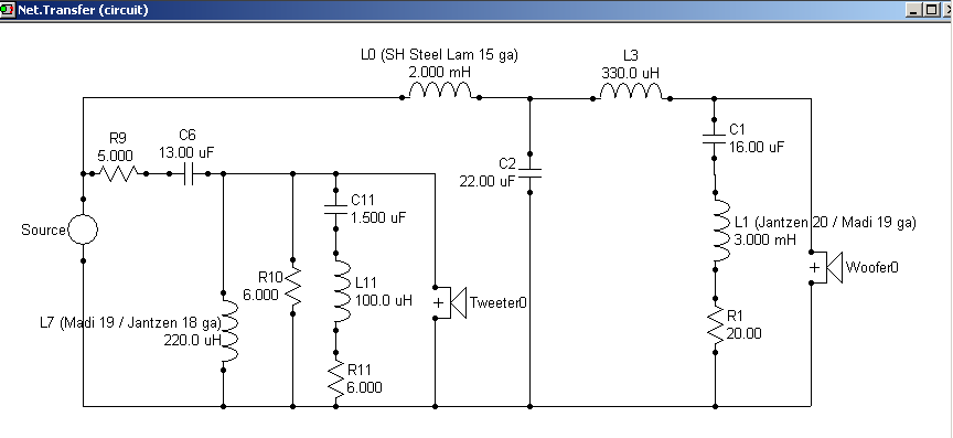

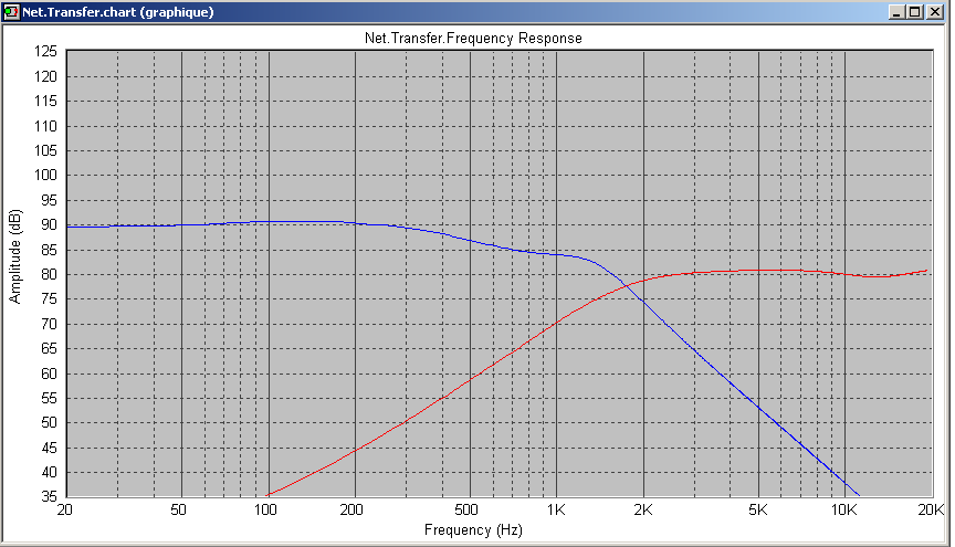

See below a crossover design and tranfer function The LCR create the small ~2 dB dip around 12 Khz. This crossover is from Jay and use 830883+810921. You might find this old thread interresting :

can you describe what the operation of the LCR and why it produces that little dip in the response.
Can you also describe the operation of the circuit parts that create the rise in response as frequency falls?

OK...first of all I don't understand this 100 UF in that schematic...if you can clarify that would be awesome.
Also, I finally got a chance to ad the LCR. I decided to try that before modifying the xover further. Wow, what a difference! It's not quite there yet, but now I feel like I am getting somewhere.
I went with the LCR you recommended Pascal on one of the first pages of this thread. I used 1 uf, .1 mh and I didn't have the 6.5 ohm resistor so I used a 5.6 ohm. That was too much so I changed that to 18 ohms, and much better.
I also read that whole thread you linked to above. First of all, is the graph above his xover, since the image no longer exists that he originally posted?
If so, again what the heck is 100UH? I understand it is a type of inductor.

The LCR in this case is working more as a notch rather than a tilt, but it accomplishes pretty much the same thing, especially as you probably can't hear much above where it's operating anyway.
