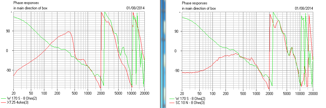

I had a look at a better R2604 or XT25 ring radiator, as opposed to the D2608 or equivalent Visaton SC10N.
It just scrapes it on output level and works nicely on third order filter. The exact match on the slopes is less of an issue, because I could time align it better, but it's the smooth phase response that is the revelation. Look and understand, folks! 😎

Let's reiterate. I have just given you a remarkable demonstration of a ring radiator's strength versus a soft dome. Not a cone tweeter, or a metal dome or a waveguide, interesting though they are.
Whether you want to read the theory behind this is up to you. But here is why soft domes are broken: Robin Marshall: A Modicum of Genius | Stereophile.com
Now if you can spot what is remarkable about the XT25 phase response will tell me whether we are on the same page here. No more waffle please. If you don't know, say so. 🙂

Frankly I'm not particularly bothered about the Boxsim phase model of the XT25 under unspecified conditions. Interesting, and apparently quite clean in the higher registers, but alas, not what I was concerned about. What I was concerned about was the arbitrary writing off of all soft-dome tweeters, sans qualification (aside from a single pair of simulated phase plots) but presented as universal fact.
Rather than casually dismissing all of said as 'broken' on the basis of a pair of Boxsim plots & a link to Stereophile, I, and I think many others, prefer to primarily work on the basis of a drive unit's frequency response on & off axis, impedance behaviour, distortion performance &c. Do soft-dome tweeters have limitations? Of course. Do hard dome types? Yes. Do ring-radiators? Also yes. The XT25 you refer to for instance. Lovely on axis FR. But distortion rockets < c.2.5KHz, it has a rather small radiating area due to its construction and somewhat mediocre off-axis performance due to the same. These are extremely important design considerations which cannot be written off as 'waffle', or having no engineering / scientific relevance. Therefore, I for one do not accept the above simulation as sufficient justification for claiming that all soft-dome tweeters are incapable of reproducing anything more than 'horrid mush' >7KHz.

So what are we seeing here with my comparison of an XT25, using imported FRD and ZMA files in Boxsim, and a soft dome? EXACTLY what Robin Marshall is talking about. Game, Set and Match to Robin Marshall I'd say. :smash:
But hey, you stick to your frequency plots. But maybe you have now learned what to really look for. 😛
