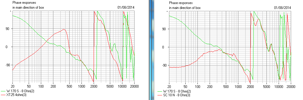

So what are we seeing here with my comparison of an XT25, using imported FRD and ZMA files in Boxsim, and a soft dome? EXACTLY what Robin Marshall is talking about. Game, Set and Match to Robin Marshall I'd say. :smash:

Please explain how to read the phase plots you are posting.
Quite easy to follow really. The SC10N soft dome has a ghastly second resonance around 6kHz, represented by an S-shaped kink in the phase curve. Ideally a phase curve will be more or less a straight line. You can see that a 6" woofer has a few issues too. Another way to look at the kinks in the phase is the slope of the bends correspond to group delay. Above 6kHz, it has lost all linearity.
The non-ferrofluid XT25 ring radiator does much better, with no significant resonances or energy storage whatsoever. Almost perfect straight line. In fact a ring radiator has much in common with a cone tweeter, even down to needing a third order filter to work well. Significantly, a ring radiator pins the troublesome floppy centre of the dome rigidly, thus curing most of the resonance problems.

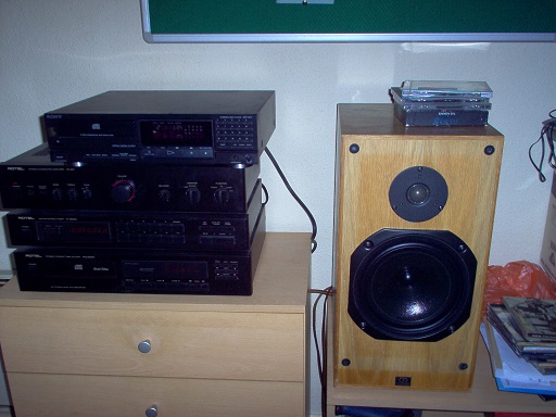

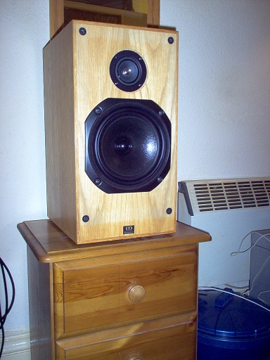

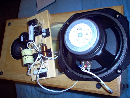

My least favourite speaker:
Morel soft dome on a BW3.
Monacor cone tweeter, below, works much better. Truly musical and revealing.

That doesn't exactly prove that all soft domes suck, but I guess at least you've listened to one, that's good.

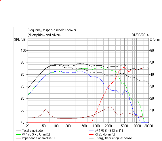

For sure, soft domes are the WORST tweeter in town in my experience. I think I'd prefer a good metal jobbie like the SEAS 22TAF/G. I've already done some rough and ready modelling of the Nomex 164 with XT25 reusing some existing components. Tweeter attenuation is select on test anyway, but this won't be a million miles away. I'd use the double magnet XT25 since people say it's better. 🙂
Ghastly impedance, but what can you do with such a design...LOL

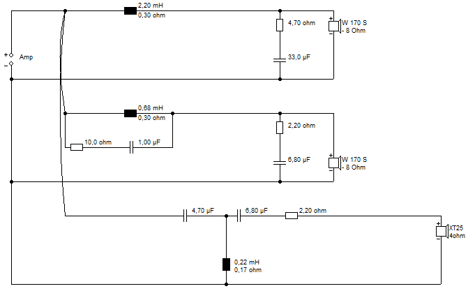

Not bad, at least you're giving him something real to work with, well from nfg graphs anyways. What's up with that mondo peak/knee @ 5K? And it almost looks like the lower woofer could do with a notch too; maybe .47 and 10 ohm. I thought the xt25 had a smooth response, is that really what it looks like on an 8" baffle?
satx, I did say rough and ready modelling. The particular XT25 I modelled was the XT25SC30-04 with ZMA and FRD files from Zaph Audio. 😀
The Nomex bass driver will roll off faster being low inductance too. These are mere details, and I'd prefer 3.9uF at the tweeter filter, but 4.7uF is not far off. As is closed box or reflex. I've kept with Troels' bass design.

Yes, looking at the plot it looks to be about 90db max. Why try to shoehorn that tweeter in there if it's not ideal. That really gives you very little if any room to finesse the FR or raise the impedance considering it's 4 ohm.
Anyways, I seriously doubt the the HDS tweeter in the Nomex is the problem and I don't think replacing it with the xt25 is the solution. I would look room, wiring mishap, damaged component, power response/xo point, and electronics/source. In that order.
