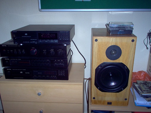

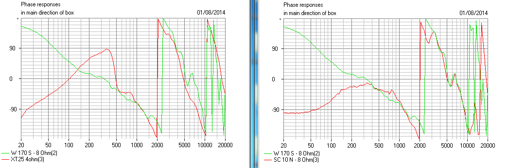

Whether you want to read the theory behind this is up to you. But here is why soft domes are broken: Robin Marshall: A Modicum of Genius | Stereophile.com
All drivers go through breakup at some point. Soft domes do this in the last couple of octaves, we know this, but it's done in a controlled way and it actually helps to improve the off axis response. This doesn't make it sound like mush.
Now if you can spot what is remarkable about the XT25 phase response will tell me whether we are on the same page here. No more waffle please. If you don't know, say so. 🙂
There is nothing remarkable about it. The only remarkable thing about the XT25 is that, when placed on a large flat baffle and flush mounted, it has a very flat frequency response. This isn't because it's a ring radiator it's because it's a well designed tweeter.
Another way to look at the kinks in the phase is the slope of the bends correspond to group delay. Above 6kHz, it has lost all linearity.
Group delay is an intrinsic part of any filter response, be it how a driver behaves without a crossover, or how just the crossover behaves on its own. If there's a kink in the frequency response there's a kink in the phase and kink in the group delay. Equalise the kink in the FR away and the others go away too.

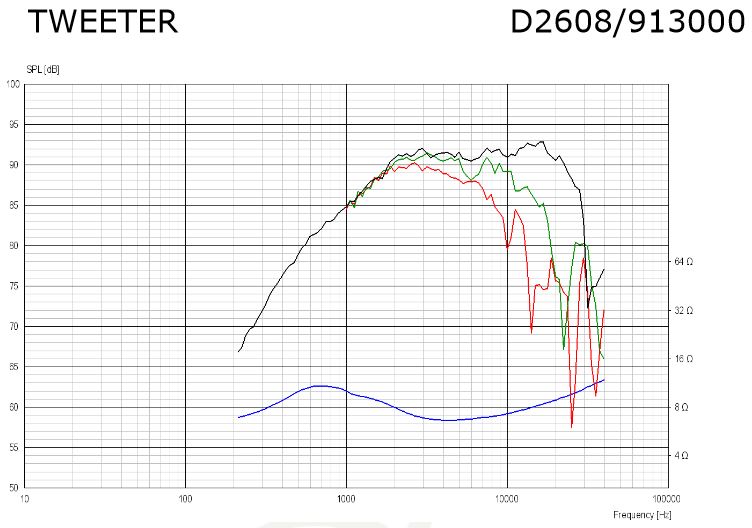

Nobody has mentioned one other rather obvious thing about the D2608 tweeter, is that it is a largish 30mm dome, which means the usual problems kicked in earlier and required some rolloff.
The D2608 is actually has a 26mm diameter coil.

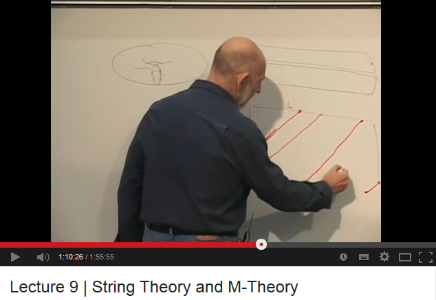

Lecture 9 | String Theory and M-Theory - YouTube
I don't know what is controversial about the suggestion that a spherical piece of soft dome fabric flapping around uncontrollably at high frequency might not be the best way to do things. But, hey, you've got something working even if you have to notch it above 10kHz.
When Robin Marshall was talking about cone tweeters, the toroidal Vifa XT25 ring radiator wasn't even around, AFAIK. Science indeed is never proved for all time, but the maths is. The only question is whether the particular maths describes the real world.
I leave you with two images which strongly suggest that a torus is a better and more useful geometry than a sphere. There may be other solutions too which you can explore. Good luck. 😎

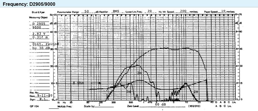

The replacement old classic scanspeak D2905/9000 tweeter is a bit less bright and a bit more rolled off than the D2608/9130 by the look of it.
