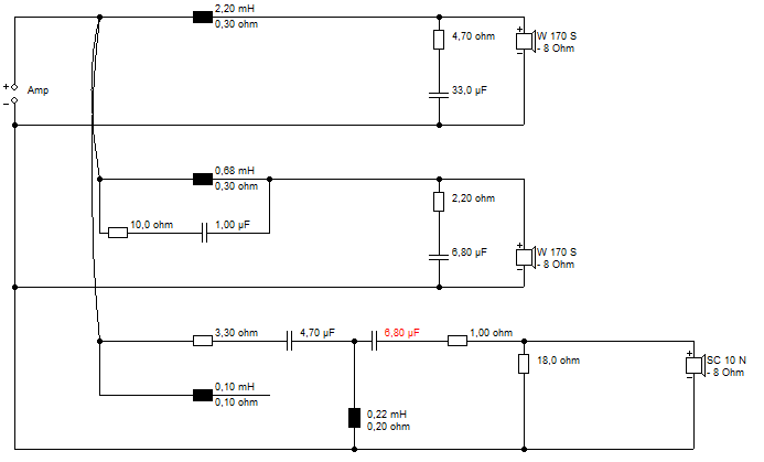

I am using MiniDSP 4x10 as a crossover (no caps). Perhaps this is what makes treble harsher?

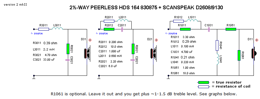

Concerning the HDS tweeter, I found this thread (and project) interresting, measures of the HDS at post #29
The BaSSlines (Lamda TD12H, B&C6md38, Peerless HDS) - AVS Forum

Here's something you can try. Let's convert it to third order tweeter using those 6.8uF caps you have.
That gives 6dB better power handling and rolloff down low on the tweeter. Should sound better at high volume. 😎
Joe Rasmussen is crossing this tweeter second order on the Elsinore, sure he does not think it sound bad at high volume 🙂
PS : I've tried this also this kind of mod when i was finding the HDS tweeter sounding harsh ... Changing amp from Poppulse T150 (TA2022 chip) to Roomplayer (IcePower 50ASX2 module) solved the problem.

IMHO the rising response of this tweeter is something to take care :

One thing I didn't mention, (I mentioned it in another thread), Troels told me to raise the inductor to 1.1 MH on the midrange, which I did. Everything I have done was an improvement.

Jeez, Clausen, you've changed the midwoofer coil from 0.68mH too! 😕One thing I didn't mention, (I mentioned it in another thread), Troels told me to raise the inductor to 1.1 MH on the midrange, which I did. Everything I have done was an improvement.

That will make a big hole in the midrange, and change the notch and phase alignment too. It leaves the tweeter too loud, but getting that right leaves you with an excessive "BBC" downward tilt IMO.

I'll change it back to .68 mh when the other parts come. I did what Troels suggested.
