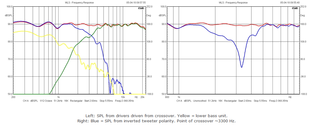

Well you said it, it needs a crossover redesign to be at its best. A steep (4th order acoustic) xover as low as the HDS will comfortably go would be my recommendation, probably something around 1800Hz. But first should be sealing the ports and adding in a high pass to the mains, lighten the load to them and sort out the subs so that they fill in where the mains roll off.

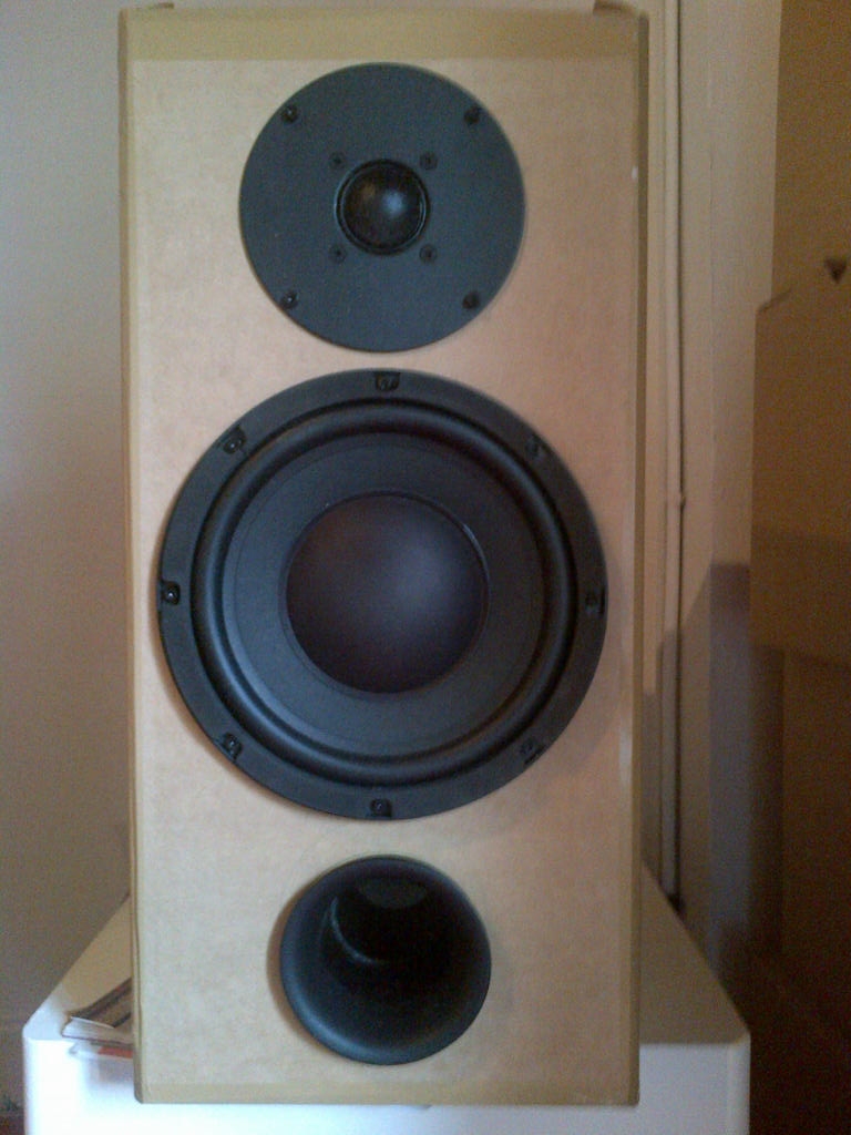

Pascal...I really appreciate your input...it helped me figure out I screwed up the bass of this speaker.
But cheer leading how great this tweeter is, isn't helping me. It sounds harsh to me PERIOD! It doesn't matter what it sounds like to you. To me, the sound is a deal breaker. I don't care what measurements ANYONE can produce. Measurements won't change my bleeding ears!
I don't mean to be a jerk, you have been VERY helpful. So please understand I appreciate WHAT YOU HAVE SAID SO FAR. Understand my bluntness is simply to make a point!
I most likely will use some of your suggestions for this tweeter. But to my ears if it is not a frequency issue these things are just too LOUD! If they are too loud that can be fixed. If measurements say they are not too loud...then they trick the measurements, but not my ears! So they cannot be fixed IMO!
What I am trying to say is this....I recognize these tweeters have a huge following. If I can fix my issue, maybe I can be one of them, however, I am NOT ONE NOW!
Bleeding ears signing off....

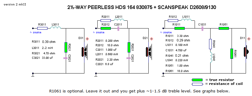

Hi Clausen,
1 - you should go back to the original TG crossover values
2 - listen for few days
3 - then try lowering the tweeter : R1051 et R1061 1.2 and 15 ohms (omiting R1061 as TG suggested sound awful IMHO)

PS : I attachment the speakers in working on : 8"+1.2" (Audax tw034)

I hope to have some time this weekend to mess with the xover. The parts I ordered won't be here until Tuesday, but I'm going to return the original coils, and while I'm at it try the 3rd order xover as suggested since I have those parts. I'll post when I get it done, and take some pictures of the xover.
I added the extra cap to make it 3rd order and tried changing R1061 to 10 ohm. (It was too much.) I immediately replaced the 18 ohm after listening to An ELO concert I have. On two songs one of the back up singers claps a few times, and it is very subtle but audible. I was listening to it in 2 way and noticed I couldn't hear her clap at ALL. I replayed both songs with the center playing, and it was very clear. I replaced the 18 ohm and listened again in 2 way, fixed.

If you've completely exhausted changing the level of the tweeter with this design then I would advise trying to roll off the top end of the tweeter a little.
Whenever I am trying to balance the treble in a design there are two things I play with, the tweeter level itself and how the top octave is balanced, either making it rise/droop/be flat etc. Usually I end up tilting it down a touch, or at least tilting down a rising response is usually necessary.

Clausen, try cutting out a felt ring and place it over the faceplate with a hole in the middle for the dome. Start with 0.5" thick felt and add another layer if needed. I think you'll be surprised by what you hear especially at high volume.
I still think this tweeter has wild dispersion in the presence region which can cause problems with some rooms and some ears. I think it's a good candidate for a waveguide of some sort.
