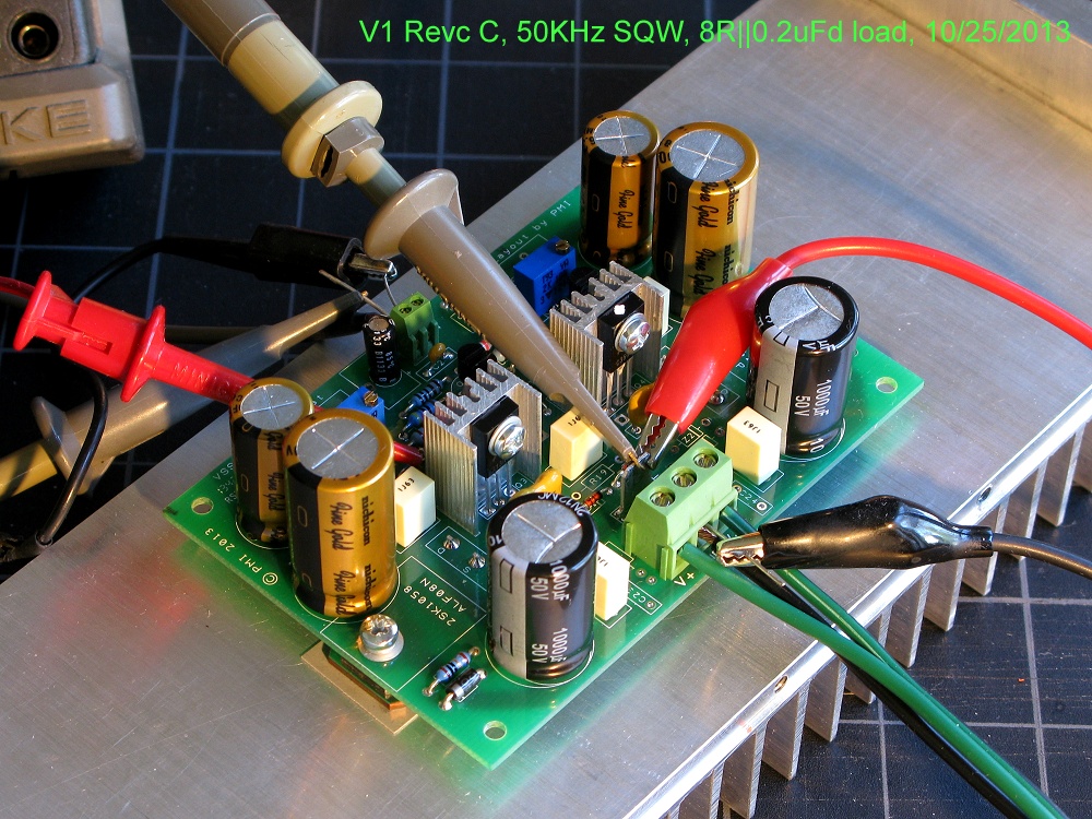

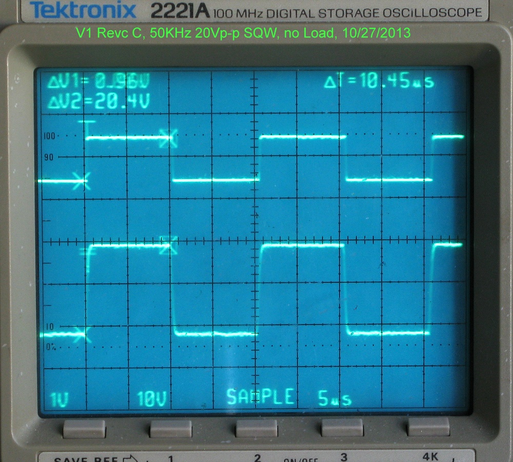

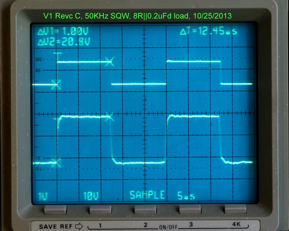

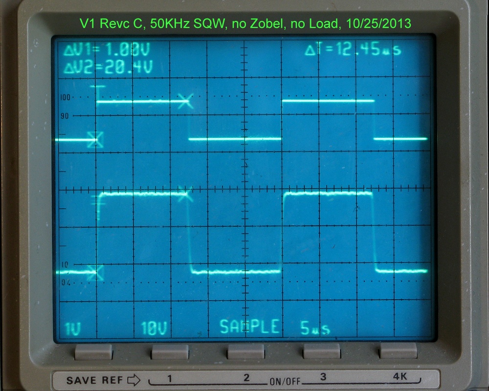

Test Results, 50KHz Sq Wave, 8-Ohm and 0.2uFd Load
The pics below show a 20Vp-p square wave, with no Zobel installed, with and without a load.
First Pic: 50KHz, 20Vp-p, no Zobel, no load.
Second Pic: 50KHz, 20Vp-p, no Zobel, 7.5R||0.2uFd
Third Pic, as tested: +-30.5V bench supply, input filter, KSC3503E/KSA1381E with 47pF Miller caps, no Zobel on circuit board

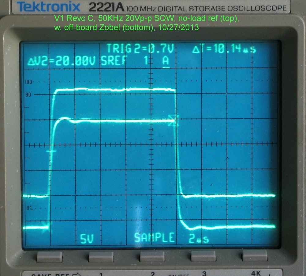

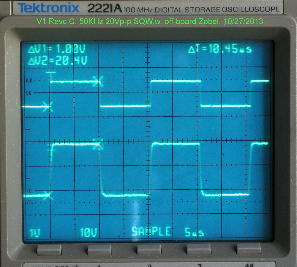

Test Results, 50KHz Sq Wave, Zobel off-board
First pic: No load, no Zobel
Second Pic: 7.5R 0.1uFd in series, and no other load
The two pictures show very little difference, although there is a slight one.
Third pic: Magnified no load saved waveform used as reference (top trace), for waveform with Zobel (bottom trace), showing the Zobel-loaded output a little more clearly. Not an especially fair comparison in any case, because it includes fairly long leads between the board and the load.

Thanks for the pictures and the tests. Very useful!
I see the effect, but it is really benign and probably as a result of the wires to the load. If you twist them it may disappear completely. Mine is closer to Lazy's, slightly less, may be... Hmm, I should try some changes in the power supply, unless the 2SK/2SJ are completely different animal than my FETs, but I doubt it.
Not in this regard, I think. The load was connected using test leads, and not hookup wire. You can see a red and black clip in the third pic. They are about 3 feet long, and they were loosely twisted. not tightly like you would do inside a chassis, just a few turns to keep them together....unless the 2SK/2SJ are completely different animal than my FETs, but I doubt it.
