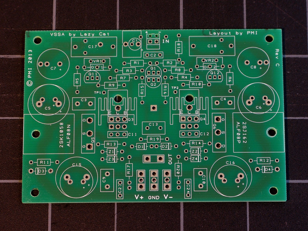

Baked and out of the oven, Pee-Cee-Bee part duex.... (also known as Revision C of my through-hole layout).
In the last version, the main departure from the original layout was that I intended the trim pots, or at least one, to be permanently attached. Offset and bias adjustment using fixed resistors was (and is) still an option, although these are mutually exclusive with the trim pots. In other words, after the adjustment is made using the trimmer, it can be removed and a resistor soldered in its place.
The new version has a few more options, but can still be assembled according to the original schematic, with all conventional parts, and with no parallel film caps required... up to +/-35V supply, and 60~65W/channel with specified components. Some component values will change, mostly to accommodate higher voltage operation.
New in this revision:
For those who have my last board (or etched one), the distance between the mounting holes for the output fets is still the same, so the board will fit the same heatsink. If you want to mount VAS transistors under the board, two additional holes will have to be drilled and tapped.
The board was, and is, oversized compared to the others seen here. 70 x 102 mm or 2.75 x 4". Personal preference - if I am going to assemble something by hand, I like space between components... that way I can just make even bigger solder-bridges...
- Up to 100W/channel w. +/-45V supply, and 125W/channel w. component substitutions.
- More space for larger electrolytic decoupling and filter caps
- VAS transistors top-side or bottom mounted (at higher supply voltages)
- More space for bigger top-side heatsinks, or one common VAS heatsink
- Optional CCS (recommended above 35V supply voltage)
- TO-3P (Renesas latfets) or TO-247 (Semelab Alfets)
- Pads for protection diodes for ALF08P/N16-20

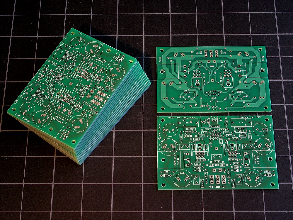

Good looking Board. I am trying my hand at etching one of your 1st ones. We shall see. Still waiting on the Chemicals. 🙂
VSSA PCB made for through hole discrete parts
Hi PMI
So guys this is the VSSA PCB made for through hole discrete parts, released at just proper time, when VSSA PCB SMD group buy is going to be concluded.
This PCB should continue VSSA project and bring it to the masses all around the world.
PMI I am proud the PCB you've designed holds my acronyme, you have my blessing to go on with successful VSSA project.
Good luck!

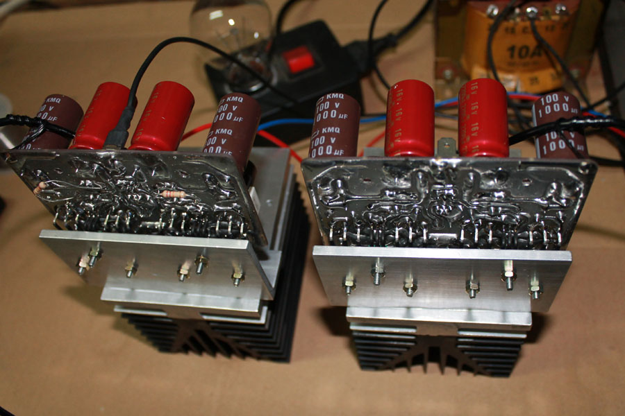

the double barrel is almost ready 😀
Hi guys,
today I power it up, only 42VDC no higher yet because no more higher tap in the transformer.
What is the maximum voltage for 2 pair of K1058-J162?
I really want to use 55-60VDC if I can 😀

Very cool John!
BTW, how hot can these TO-3's run. My outputs get up to 50C when played hard for a couple hours. Is that too hot? Sounds fine at that heat. I just want to be sure it is not harmful.
Thanks, Terry
Thanks, Terry
Hi Terry no problem, you are there in the sweet spot area...
Do you notice the sound maybe different now after some hour listening?
It should be some extra/hidden sound that maybe never heard before, more detailed sound?
My power supply not finish yet, but at my previous build the heat sink is quite hot but I can still touch them. I notice the heat sink is stable at that temperature so
don't worry about it if not too hot to touch (I forgot to measure the temperature at that time)
& they have a positive temp-co not like the BJT that need a VBE multiplier(negative temp-co)...
Because we bias it to optimal value it should be quite hot & the hotter they are the better it sound (but too hot is not good too).

Thanks John. Yes, I can leave my finger right on the device. It is hot but tolerable. I figured it was OK but thought I would ask. I played it on 4ohm all day today. Sounds good. Gets a little crispy on the highs if pushed hard. May just be clipping. I'm driving it with an X-BoSoZ which is basically no gain. I drove 4425, 4412 & 4312 JBLs. All sounded good. I also drove some Event 20/20 nearfields. It really is a nice sounding amp.
Terry,
There's no issue with the output device temperature based on what you are experiencing.
I'm very happy to hear you are enjoying it and that I was able to be part of that.
It is possible that little bit of 'crispness' might be the slightest bit of clipping when you are playing loudly. Amps with lateral MOSFET output stages are not as voltage efficient (that is there's more 'loss') than amplifiers with BJT output stages. They simply can't get as close to the power rails. In this case you are 'loosing' anywhere from 8V to 12V off each rail, depending upon load. With your supply voltages the output should be clean to about +/-27V of output on your 4Ω speakers, so about 90W average output (to say RMS is a misnomer) maximum. I'm not too familiar with your speakers so I don't know how efficient they are, but that definitely plays a role as does their worst case impedance.
I know with my PeeCeeBee, running on +/-31.5V supplies into a nominal 6Ω speaker (that has an impedance dip down to just over 3Ω) with an efficiency of 93dB/W@1m can cleanly play to a level I will only tolerate for a couple of songs. Otherwise at 'normal' levels there is no issue, even with fairly dynamic materials.

Nice build John! (and thanks for the compliment). I think you are limited by the power and the current, and also the ability to keep the case temperature down, to stay below the power derating curve.Hi guys,
