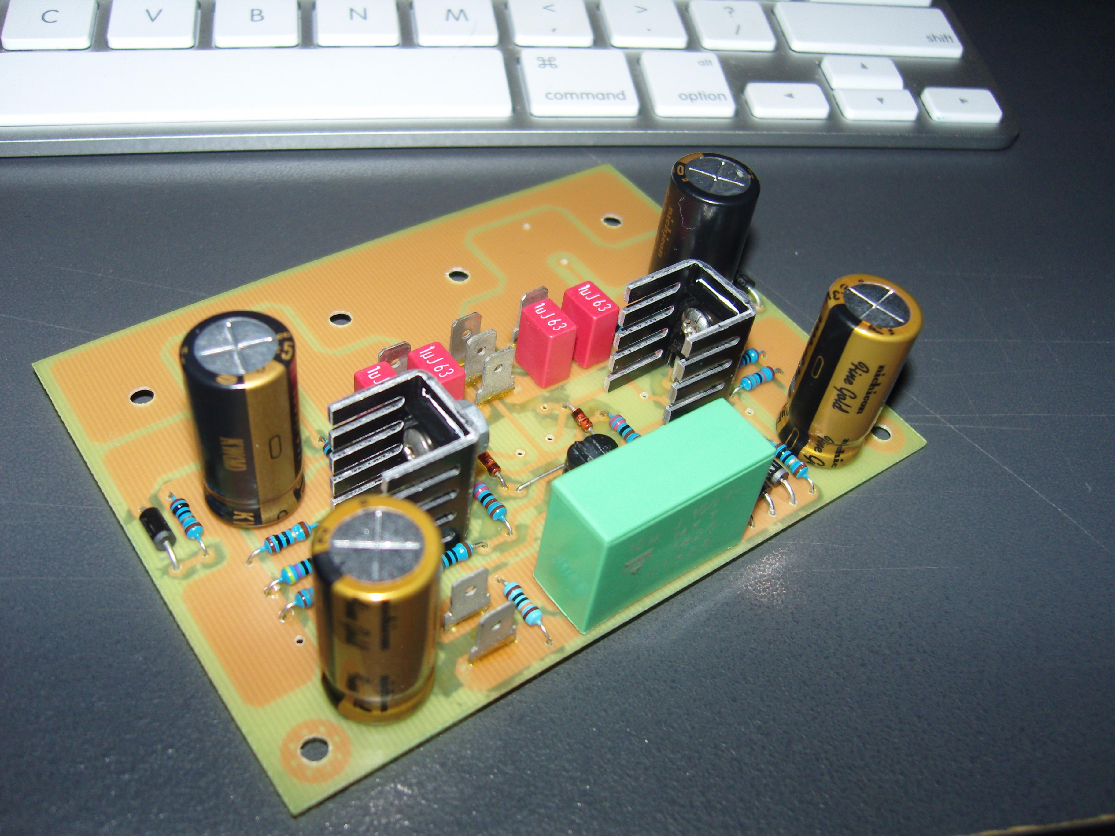

Little pic of a mostly stuffed board with nicer components than my first build. Vishay- Roderstein input film, Wima film bypasses, CDE silver mica comp and filter, Nichicon electrolytics, and metal film resistors. Will it make a difference? Dunno. I might open my wallet a little more and even spring for some double die outputs too, though they seem to be stocked only in Europe 🙁, added shipping.

Perhaps some of us can combine an order. I have noticed that the charge is once, per UK stock order, at least at Newark.com....I might open my wallet a little more and even spring for some double die outputs too, though they seem to be stocked only in Europe 🙁, added shipping.

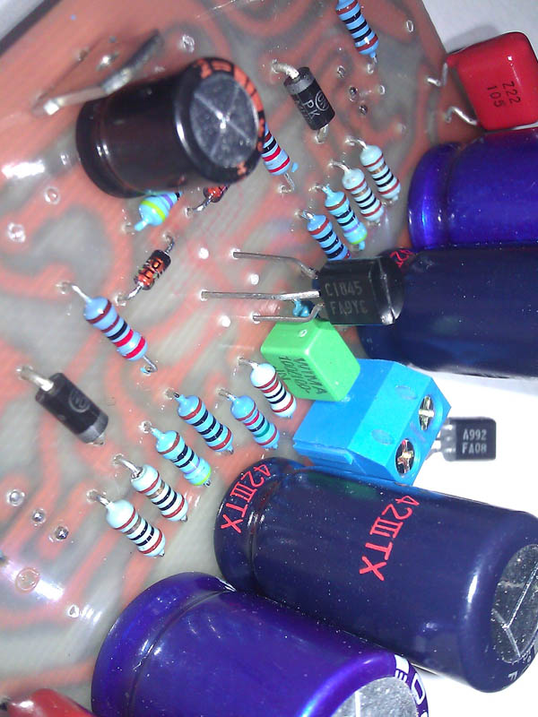

I have the old version 2SA992+2SC1845 only 2 pair match & I use it in my first PeeCeeBee 😀
but I change it back to BC550C-560C because only use +/-35VDC.
So I can use it in higher voltage version latter 🙂
Now I'm finish mounting the double die 😀 (aka double K1058-J162) 😀 at heat sink
still missing some parts to finish.
The building must be slowly to ensure no error 🙂
