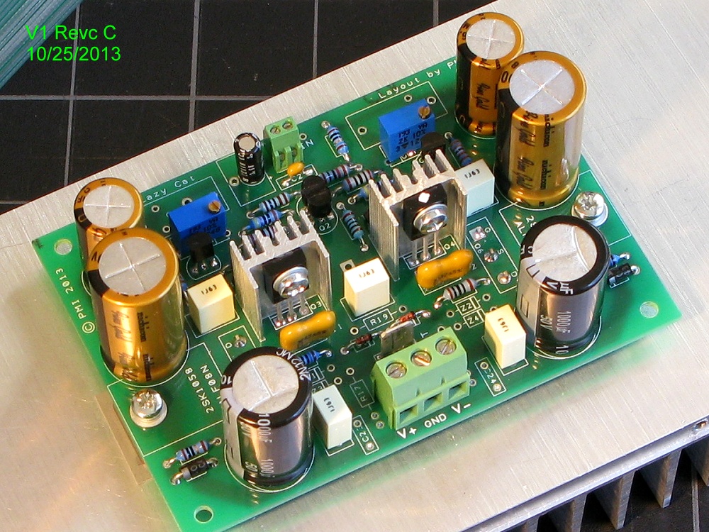

It's alive...
First board assembled last night!
(or rather, this morning, 🙄)
Successfully powered up and calibrated off my bench supply. First quick sine wave and square wave sweeps done, and looking good from about 10Hz to 50KHz. Frequency response looks perfectly flat from below 10Hz to above 50KHz, with no phase delay at all... 😀
I'll post some first pics, but no real measurements yet, I hope to have those by this weekend.
I do not need them for the first tests. They are expensive and I don't have spares, so in case I had to build another board right away, I left them off.I see you left off C17 & C18. Are those not needed?
According to Shaan, none of the parallel film caps are required (with some assumptions about noise, I am sure). And some people do not believe in bypassing electrolytics with film caps at all.
The circuit board has space for the same caps as LC specified, as of V1.4 of his schematic, and associated BOM. There are some extra pads at some of the cap locations, so parts with different spacings can be substituted (both 5 and 7.5 mm lead spacing, etc).

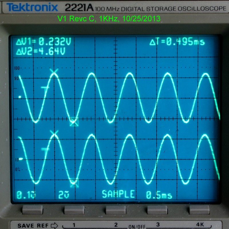

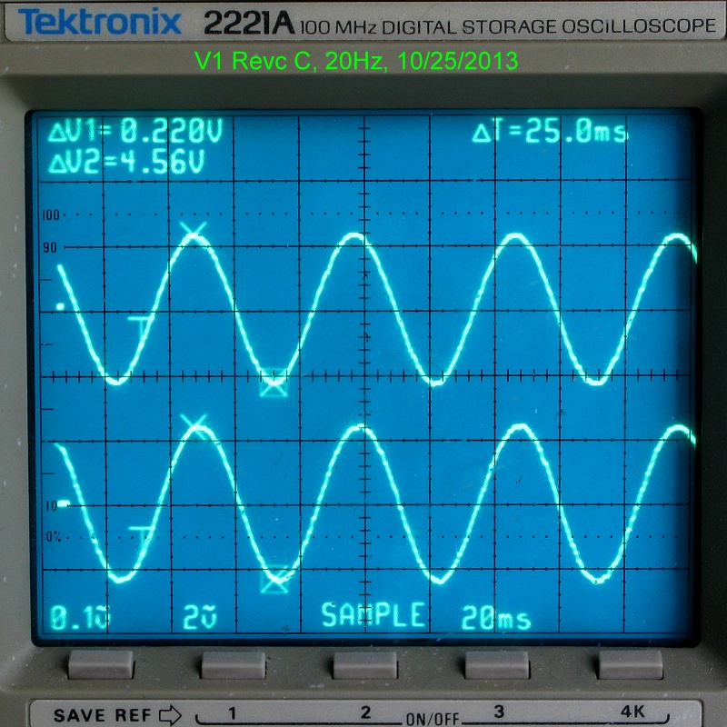

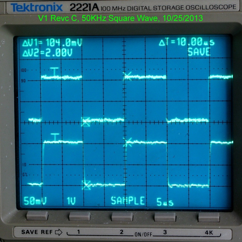

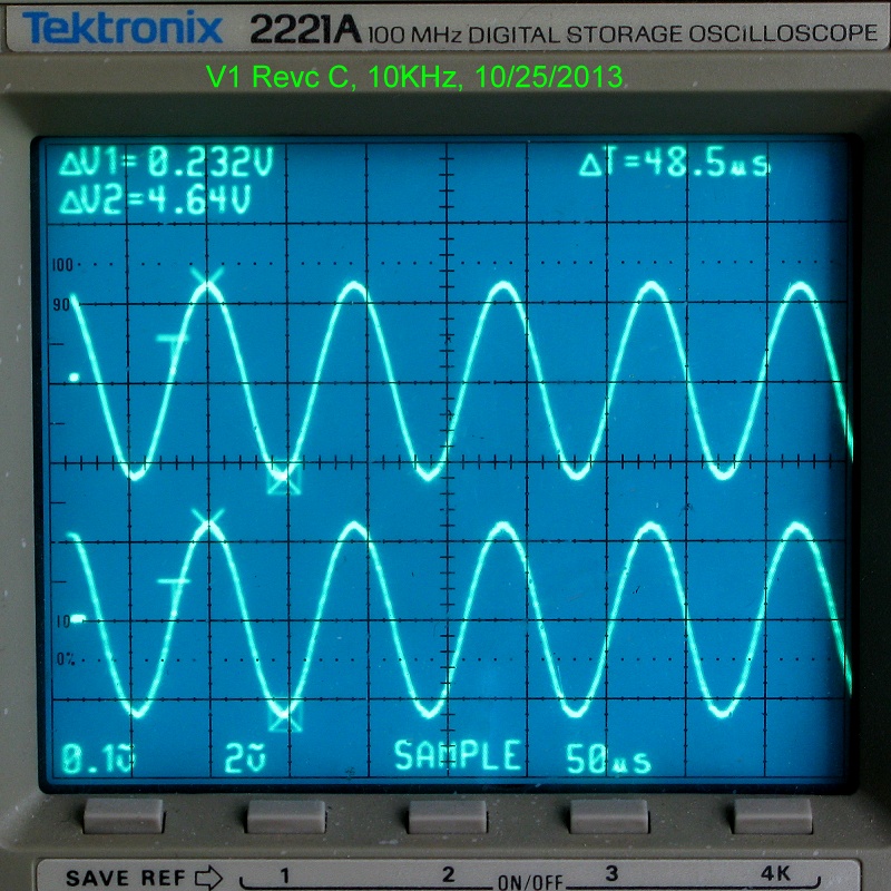

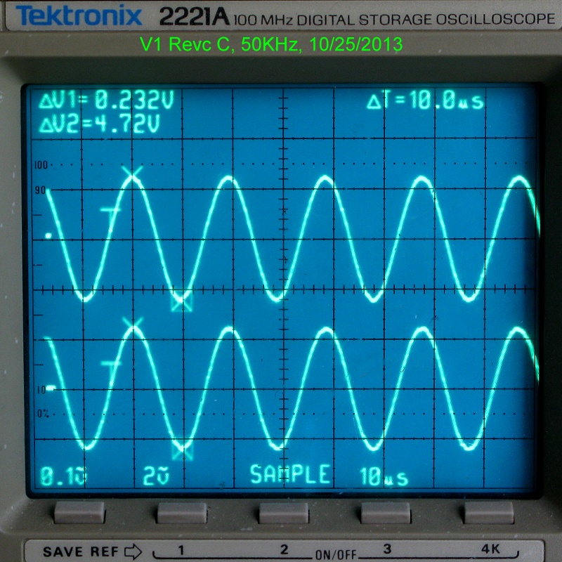

Test Results, basic sine and square wave sweeps
Pics 1-4, simple bandwidth test, 20Hz to 50KHz.
Last Pic, 50KHz square wave.
-3db points look like they are below 5 Hz and above 500KHz. Measuring that accurately will require a little more fiddling with the Wavetek signal generator. Below and above normal audio range, in any case (unless you are a dog... 😀 )
The 50KHz square wave is just starting to show rounded edges. Scope pic also shows about 10 millivolts of noise on the input signal, when the grounds for the signal generator and scope are far apart.

Everything "looks" good here, and sounds excellent, but making good measurements takes time.
The amp has a flat frequency response from 10Hz to well above 50KHz, probably to 300KHz, I think.
Making measurements below 10 Hz, and above 500KHz is difficult with my equipment. Below 10Hz and above 400kHz, my waveform generator is hard to adjust, probably because it is very old. I prefer to make measurements at a small signal level, so that makes it a bit harder, when the gain is around 27db, and I just did not have enough time.
Test conditions and bias:
Supply voltage: ~ +/-30.5V (bench supply for testing)
Zobel not installed yet
Miller compensation caps: 47pF
VAS bias: 13 ma (KSA1381E/KSC3503E) close to what LC specified
KSA1381E and KSC3503E matched for hfe within 5%
Gain: ~26.5db, 10Hz - 50KHz
Front end bias: ~1.9 mA
Offset at Output: 0V+/-3mV
Total idle current: 150mA
(this will be ~180mA at +/-36V supply voltage)
Power @ idle: 9~9.5W/channel
(will be ~13W at +/-36V supply voltage)
Room Temp: ~24C
VAS heatsink: 39C
Main heatsink: 32C
(Temps measured with heatsink flat on the table, which is worst case)
Heatsink temperature is consistent with heatsink rating, 0.65C/watt, free air, and restricted air flow because the fins are facing down. At +/-36V supply, the heatsink will be about 10C above room temperature.
