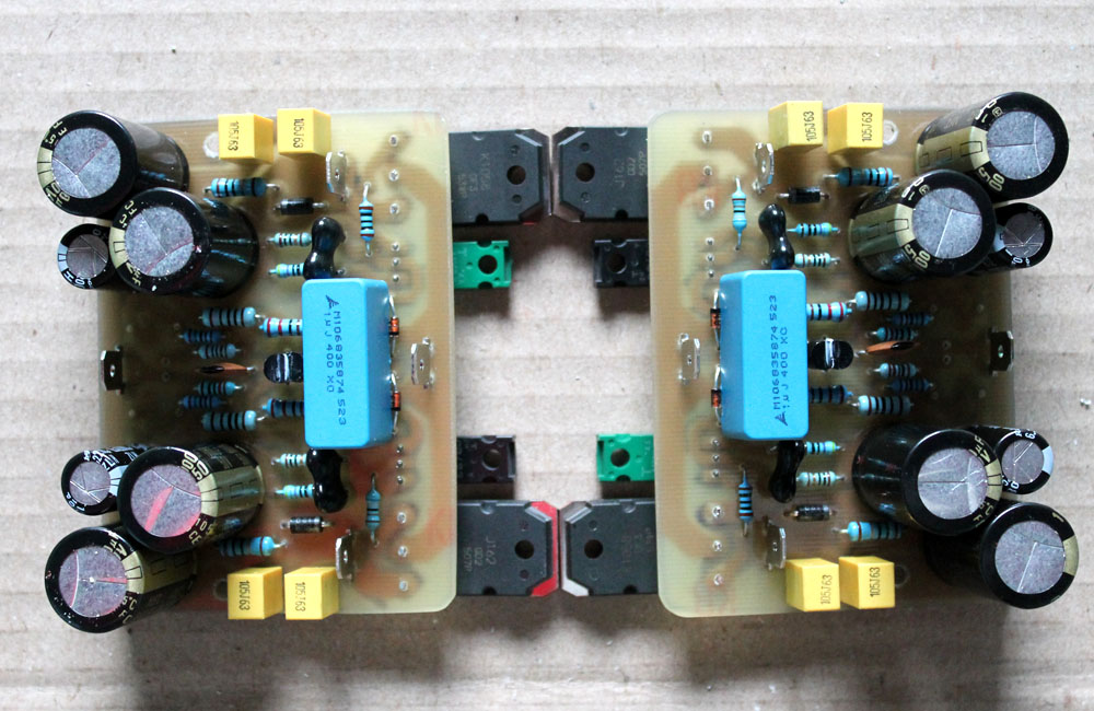

Nice job! Are you building these from the original schematic in this thread?...
I hope can made it soon, comparison is waiting 😀
Hi Pete, I'm planning build the another through hole version tooNice job! Are you building these from the original schematic in this thread?
with more parts count 😀
Yes, it is basic Shann's PeeCeeBee and only additional caps 22pF on vas
68 ohm on J162's gate, 15k offset now with series trimmer so it is so easy to zero the offset.
I will post the BoM that I use, with alternatives substitution.
Also it is nice idea to post schematic with value, I will take Shaan schematic & add the missing value & I hope he doesn't mind 🙂
(where is Shaan btw ? anyone knows?)
I have quick test them & the offset is low but not connected to speakers yet
cos I know it is all fine 😎
(need some flux cleaning)
Tomorrow it will sing I guess 😀 now is late night here

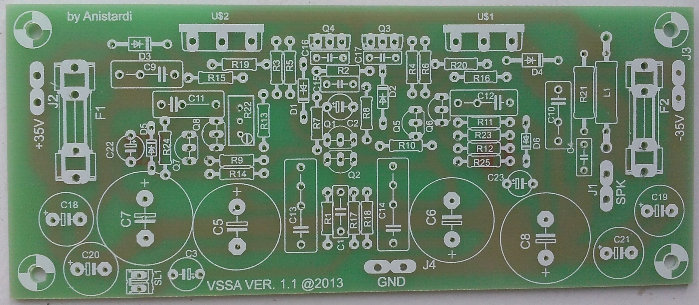

hi john,
i'm going to build your second pcb iteration.
this time with premium parts too. 🙂

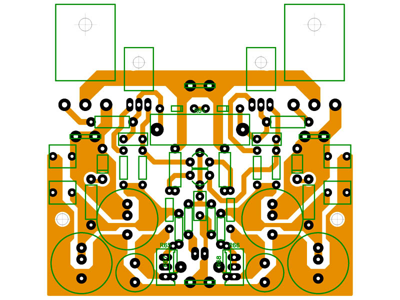

Ok, teasted 🙂

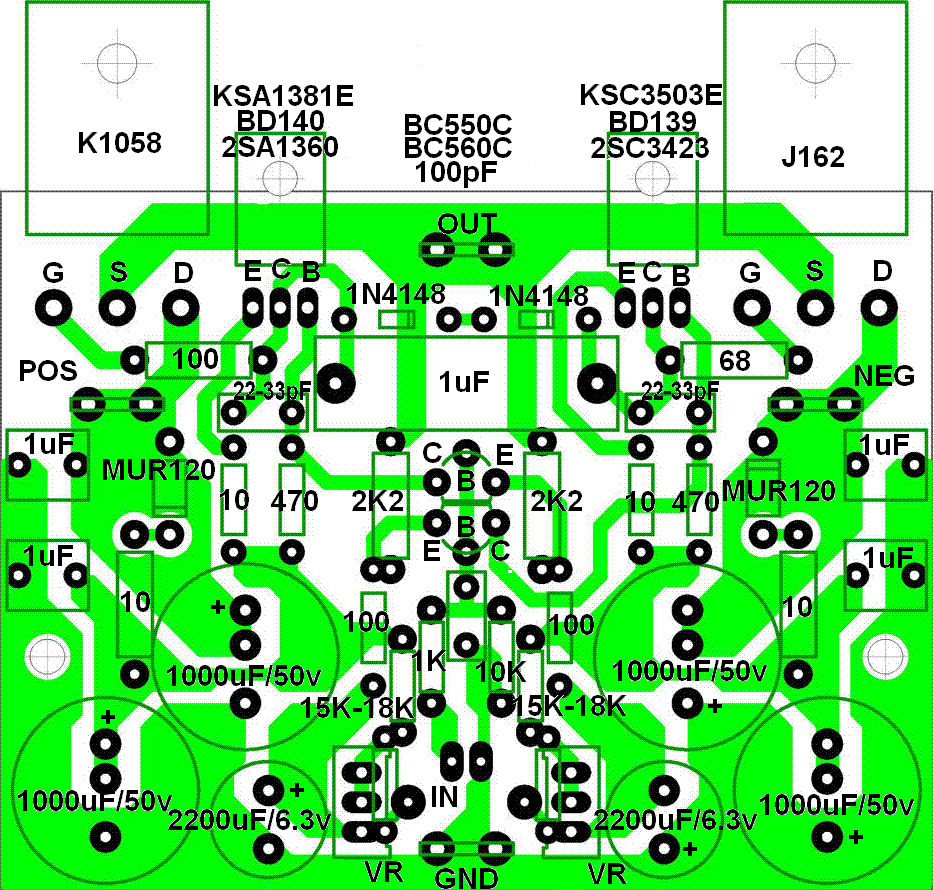

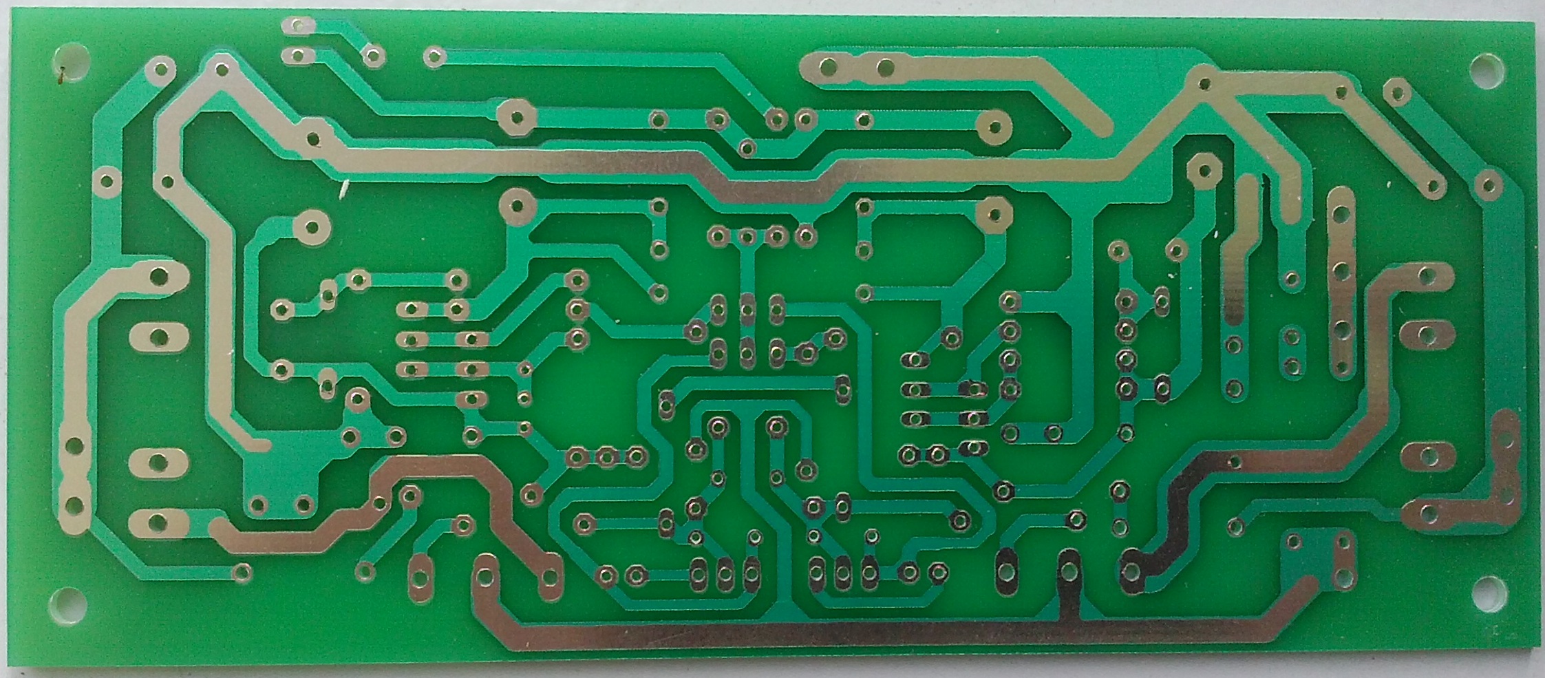

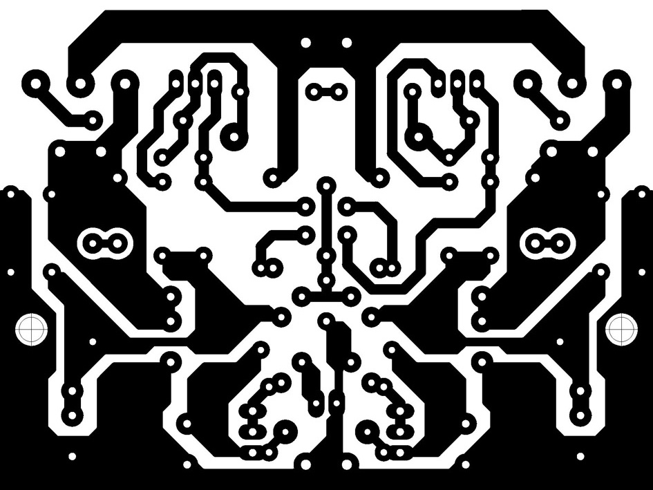

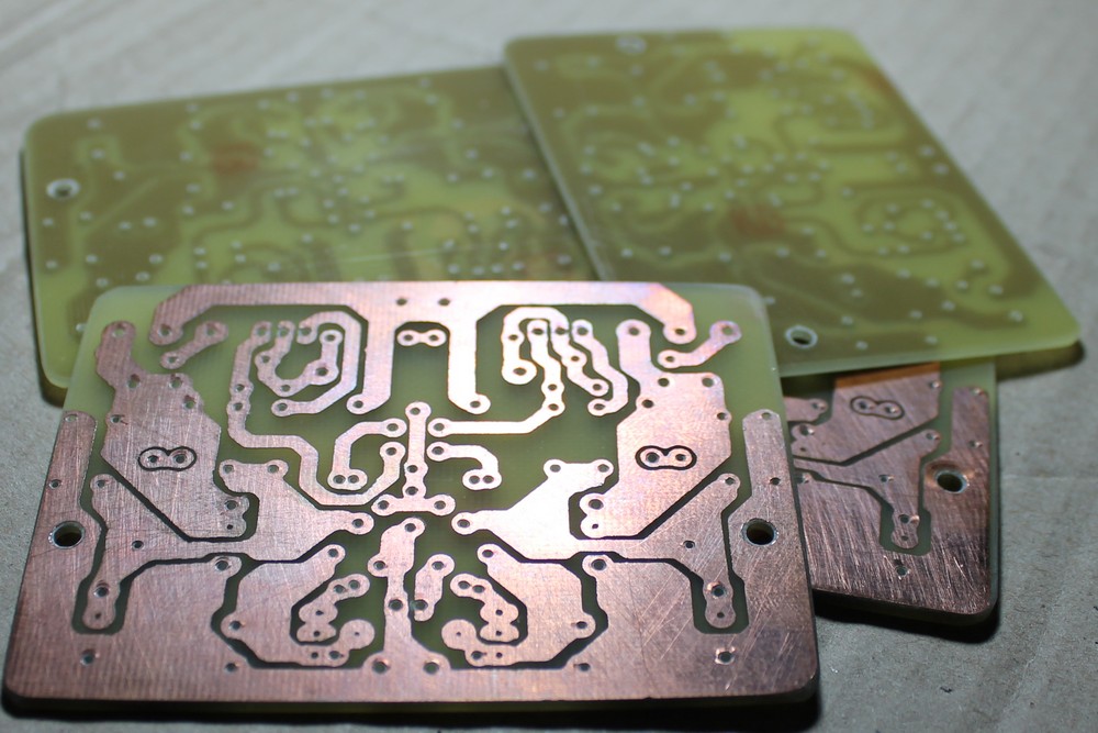

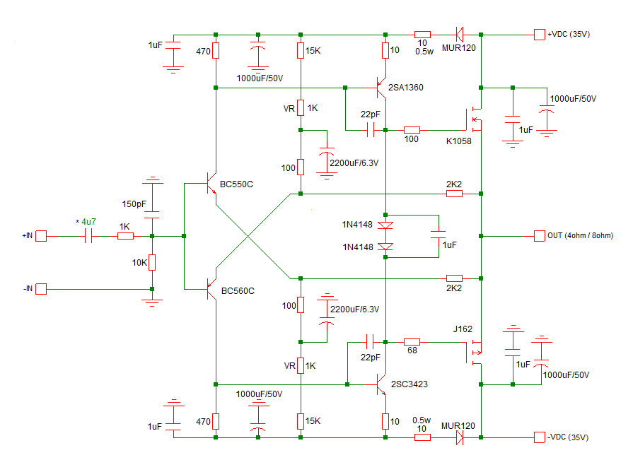

Hi, this PeeCeeBee has been tested...
This is the schematic with value, the top & also bottom layout.
PeeCeeBee size is 80 x 60 mm 🙂
The input cap is out the board 😀 , choose your favorite.
The optimal bias for the Latfet is 160mA + 10mA for VAS + less than 3mA for input pair so if total 175mA current for one channel it is good...
Today I power it up with +/-35VDC, with only 15k resistor I got 200mA total current.
So it is about 176mA quiescent current, this make them hot...
So I try measure at 10 ohm VAS transistor shows 230mV = 23mA for the transistor & it is not good (too much current).
Then I lower the voltage at +/-32VDC & I have better feeling on this 🙂
Total current is 177mA
Bias = 161mA
VAS = 13mA
At 15k resistor is optimal at +/-32VDC (for my set up)
maybe you get another measurement.
Then I put the two 1k trimmer, now it so easy to get zero offset.
When the offset is negative turn the positive side trimmer(increase value) to make zero offset. I'm play with this, try to decrease one 1k & increase another got 99mV offset
With 16k "offset" resistor & +/-35VDC
Bias = 174mA
VAS = 18mA
So I need more than 16k if I use +/-35VDC to make it optimal.
Enough for now,
I thing somebody want to make this PeeCeeBee too...
please enjoy & let me know if it is not work on your building
About the sound it is PeeCeeBee sound 🙂, not connected to my big speakers yet 😀
I thought my previous one sounds better, this one is good too but I feel something is missing.
I start to think the capacitor effect, I don't make a re-forming for the 2200uF caps (maybe I should try to replace them)
I try different caps here but I still have like the one I used before.
Also I add cheap input capacitor, this could be make the sound feel different.
Please take a good quality one at the input caps & don't make it direct coupled.
