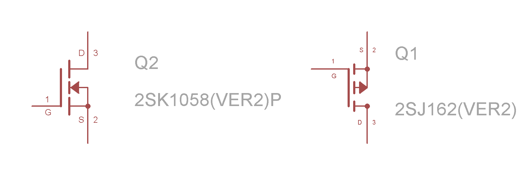

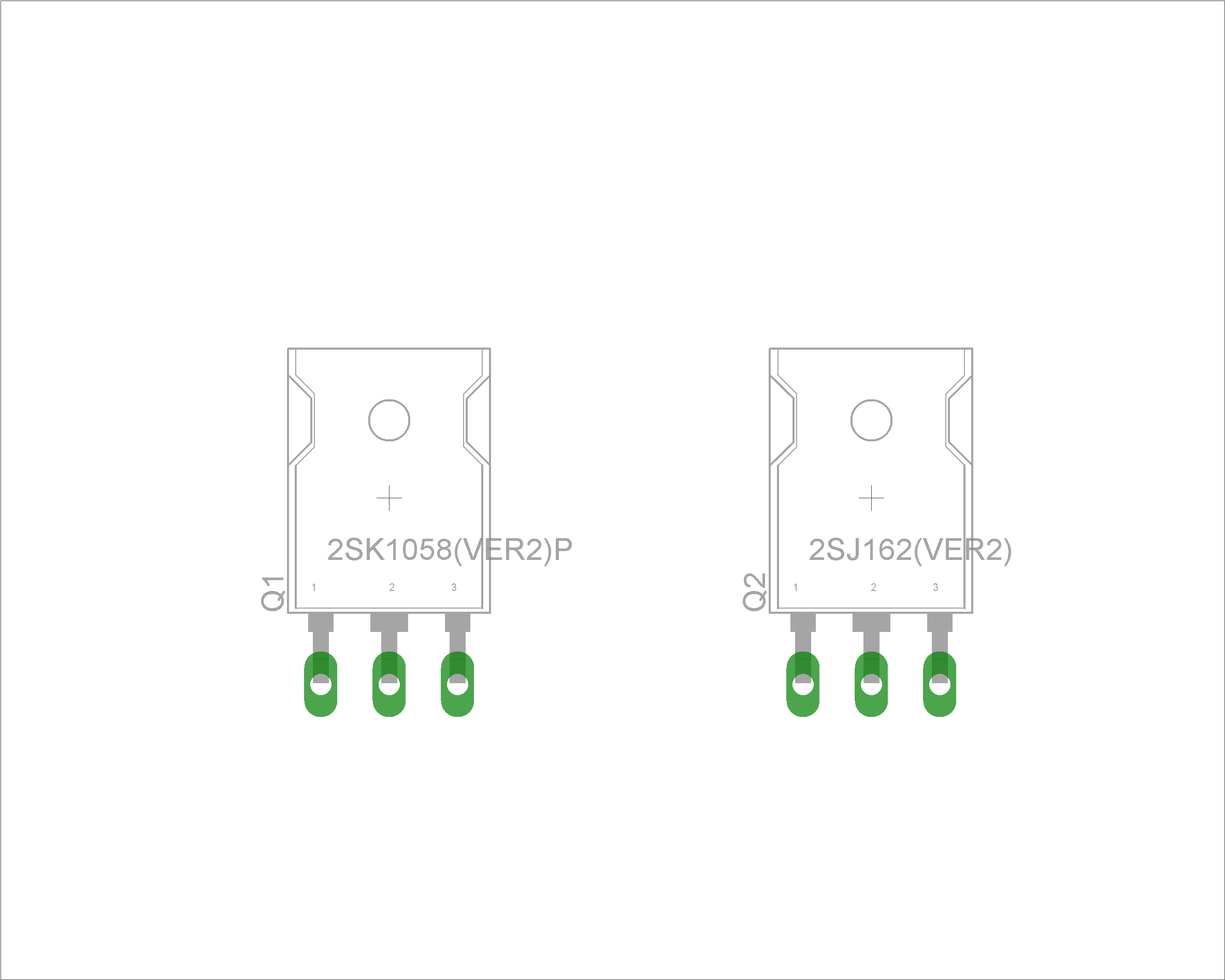

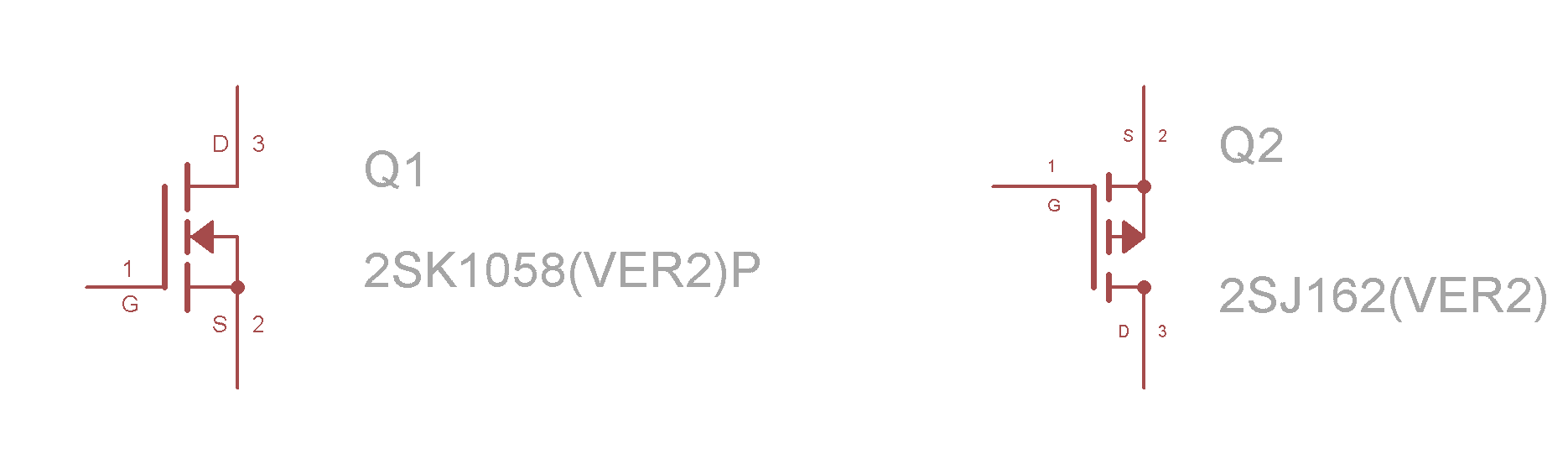

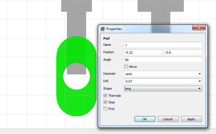

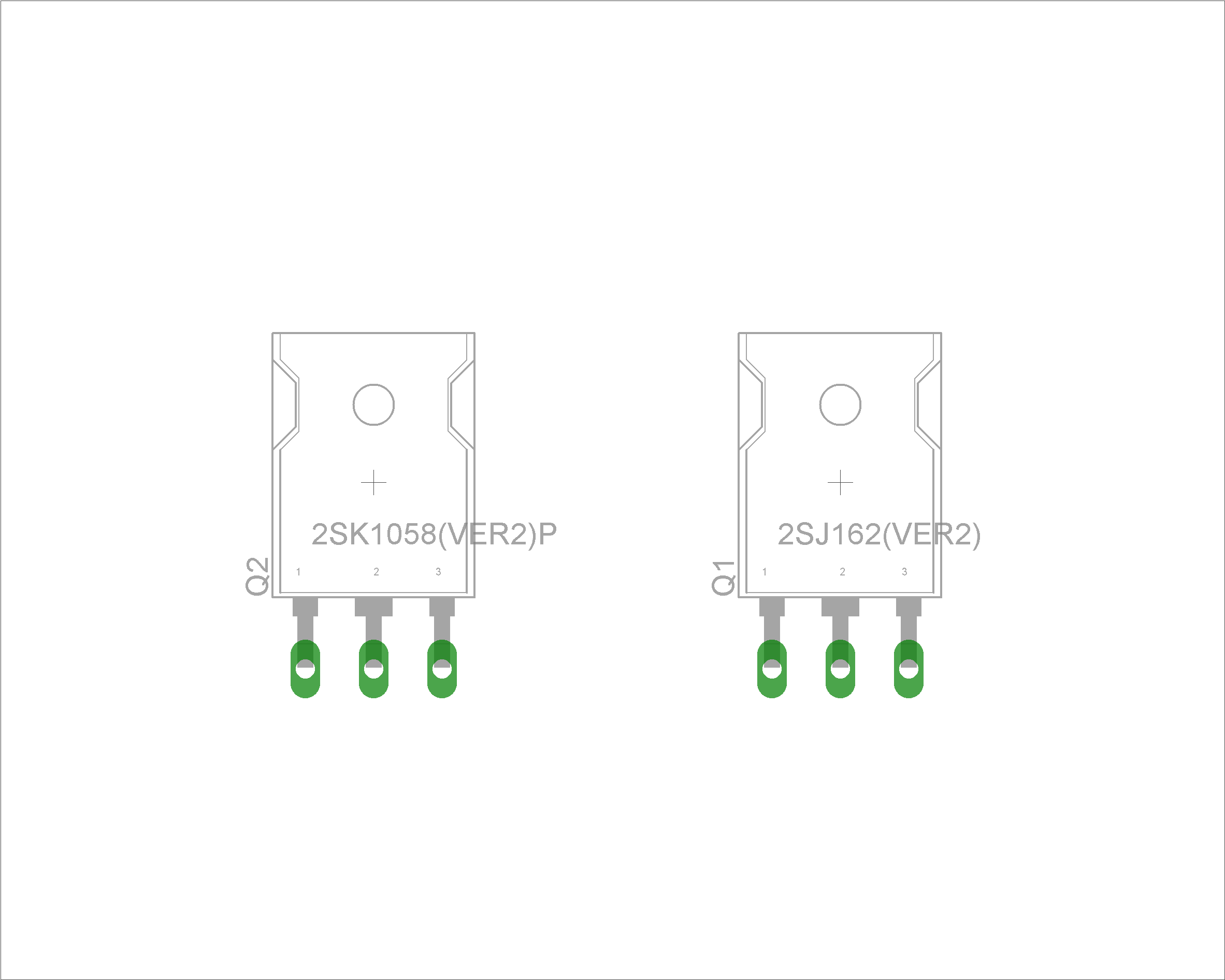

I could not find eagle library files for 2sk1058/2sj162,so i made some of my own.
They have been bodged together from different libraries,so are not exact.
The main thing that got my goat was that eagle has no TO-3P packages like the ones the latfets come in.So,i had to use TO-3P packages from another model.But the packages say that they are TO-3P,and when i overlaid them on the TO-3P of the Hitachis,they look to be only a wee bit more bigger.
I have attached the files,so could anyone please check them for me?
The images show how the symbol looks and how the final package is.I guess they are ok?

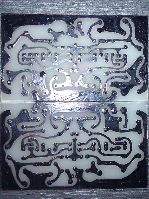

To all those who draw their own boards,especially John Bali,what do you use to draw the tracks?Permanent marker?
I have a marker which says "Permanent OHP Marker",with a fine tip.anything i draw on a pcb gets washed away during etching due to heat leaving nothing on the board.
Make holes a little bit bigger and you can fit all Latfets including Exicons, Magnatecs and Alfets. These have somewhat wider pins than Renesas. Make holes 1,5mm.
Yes permanent marker can be used, the big one for better result.To all those who draw their own boards,especially John Bali,what do you use to draw the tracks?Permanent marker?
With fine tip the ink is not thick enough & they will washed away. 😀 three layer lines draw with fine tip will do fine but single line big permanent marker will be better.
Don't worry to use bigger marker I design with enough clearance so I can still draw it manually. If you draw wrong line or pad use a sharp knife or similar to erase it.
Before used refill the ink in the permanent marker to make something like this:
Please, see post #401 my first PeeCeeBee :
Here a video how to hand made PCB Hand Drawing PCB - YouTube this is the power supply board.
The PeeCeeBee will took a longer video so I don't make the video 🙂
The attached picture will show you how thick from two layer big permanent is done.

The holes are 1.5mm,already,1.6 to be exact.Make holes a little bit bigger and you can fit all Latfets including Exicons, Magnatecs and Alfets. These have somewhat wider pins than Renesas. Make holes 1,5mm.
However,i find locally made through hole plated boards have a reduced diameter compared to the original due to shoddy plating,i raised the drill holes to about 1.8mm diameter.
I havent tested them yet,my only pair of latfets are already on another board.

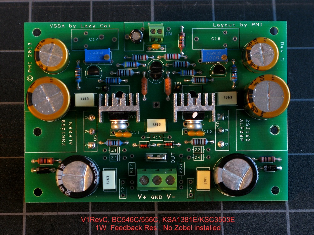

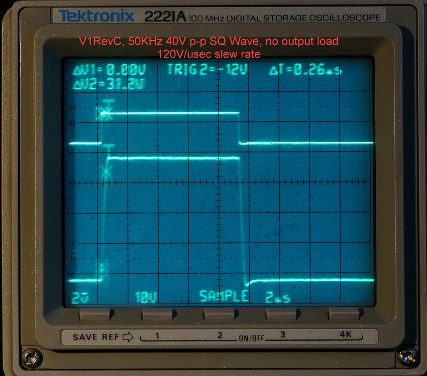

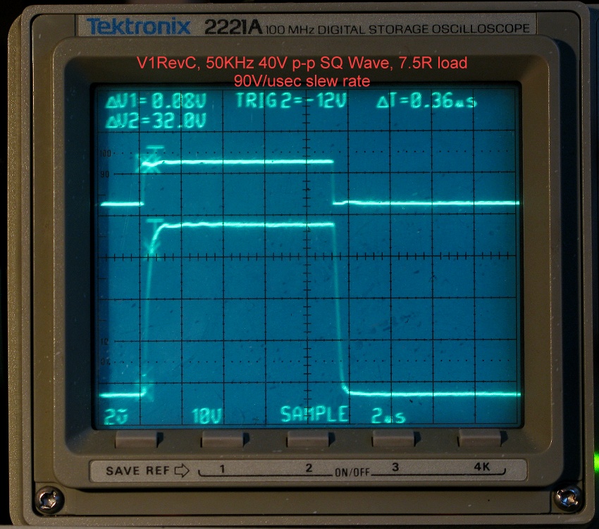

This weekend I finished most of my testing, up to +/-45V supply. Some results with alternative components incl. 22pf compensations caps...:
BC546C/BC556C input
KSA1381E/KSC3503E VAS
1W feedback resistor, and a few other small changes
To answer your earlier question, this board is a little faster w. 22pF caps (higher slew rate), and the output observed running higher frequency square waves is a bit more symmetrical.
Overall no big change, and no problems were observed. No sign of oscillation, instability, or overshoot. Improvements are slight, not enough to warrant changing the parts recommended so far, but I was excited to see >100 KHz slew rate with no instability.
Actual slew rate calculation was 120V/usec with no load, and ~90V/usec with 7.5R resistive load. Test was run with +/- 35V supply, 50KHz 40V pk-to-pk square wave.
No more testing for a few days, need to catch up on other things... 😀
