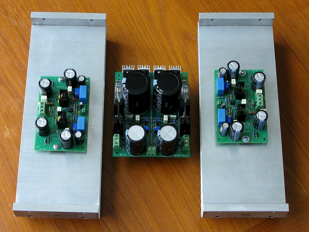

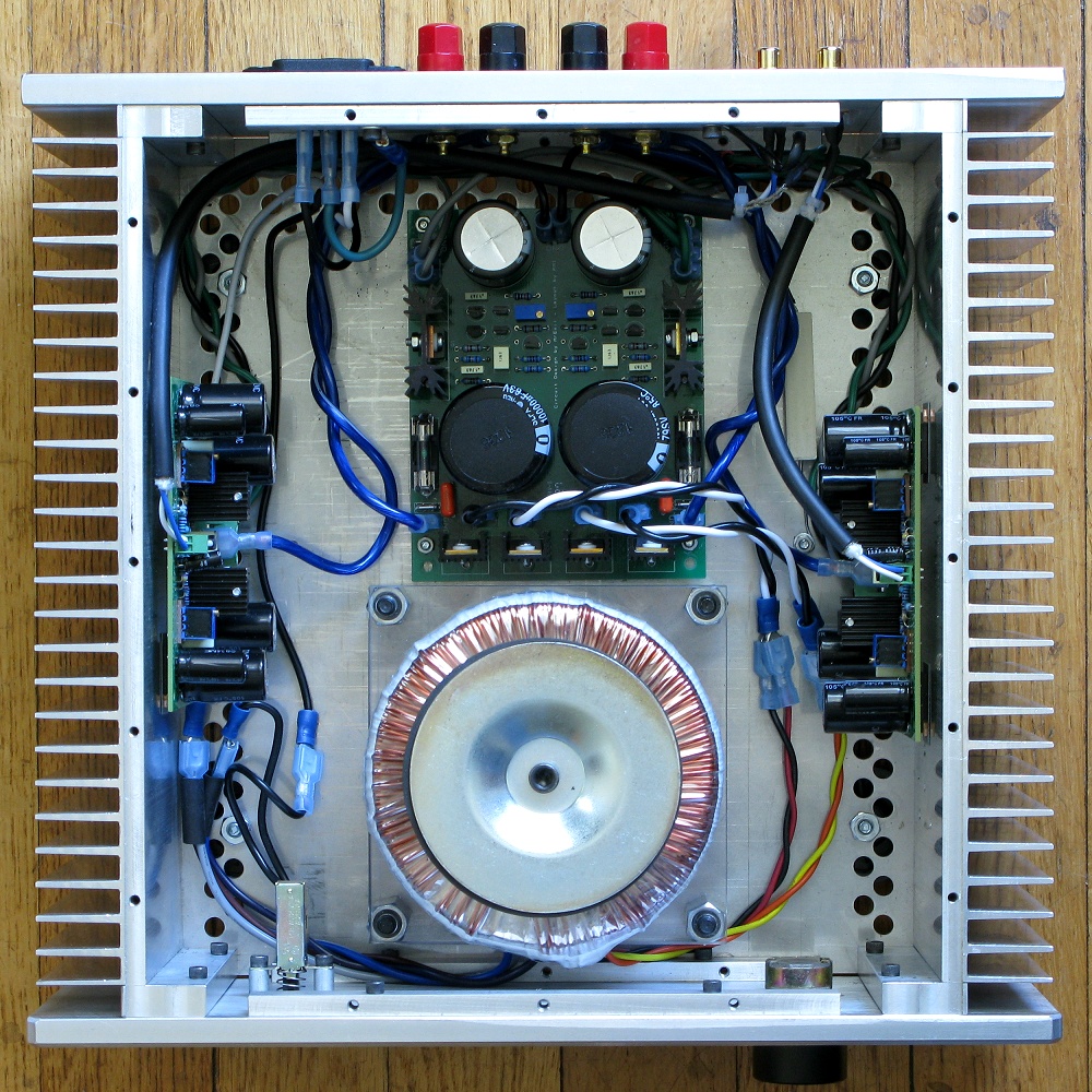

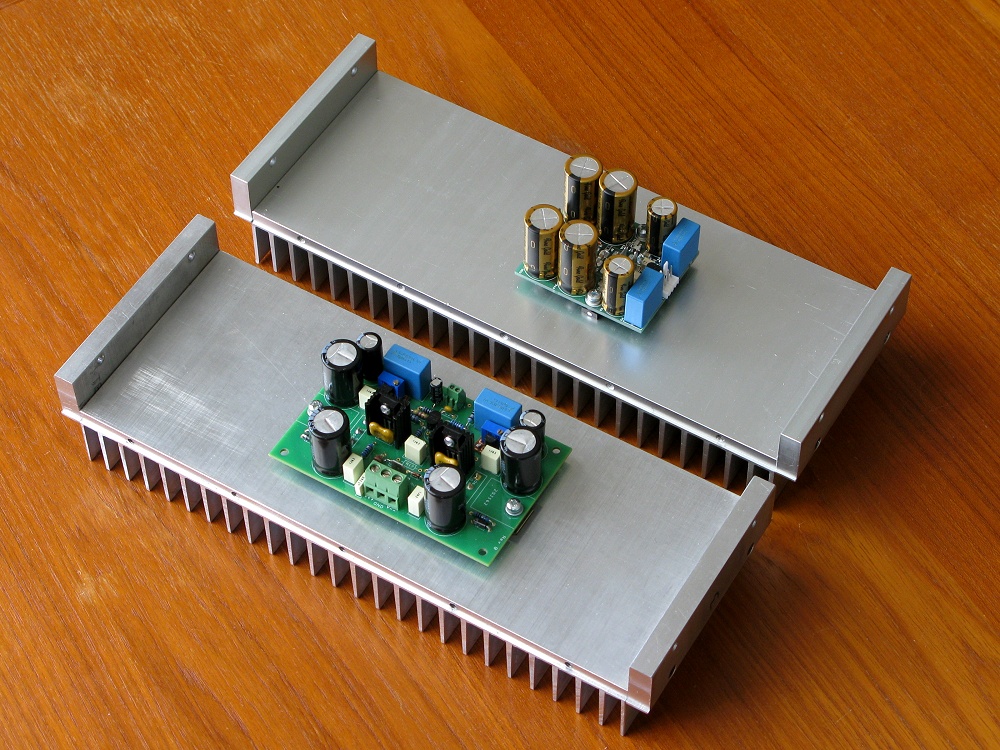

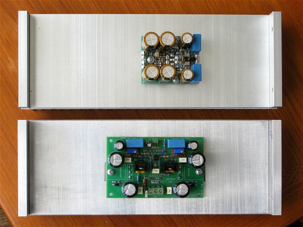

I've had some questions about comparing the different circuit board versions, which is frankly difficult. They all sound very good to my ears, including the simplest version I built which is essentially identical to Shaan's original circuit. Each is a little different, but it takes careful listening, and very good speakers to hear the differences.
You can't beat the compact layout of Lazy Cat's module with SMD components on both sides, and the dual Alfet. (See side-by-side pics below)
My goal was to make a layout which could be built easily, with all through-hole components, and with conventional power transistors like the Renesas parts or the Alfets, and with parts that could all be ordered easily from online distributors. Not to make the smallest board possible.
I hope to have the first manufactured board in my hands by middle of next week, so there are no pics of the new one yet, but the layout of the key components is almost identical to the first version which is shown below.
Test results have been posted in several installments earlier, starting at Post 335.

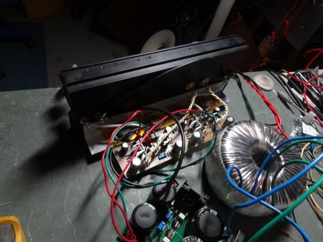

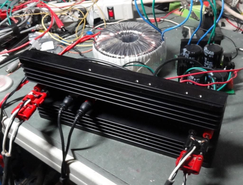

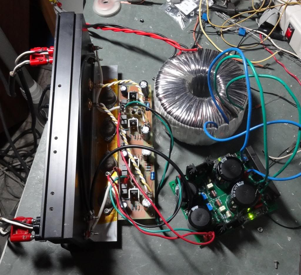

I mounted the boards on a heatsink. It is just ample. The heatsink is running at 40C. The outputs themselves are right at 44C. I can leave a finger right on them indefinitely. What I do think is too hot are the VAS, Those are 55C. Can't leave my finger on them at all. Is there a way to lower the current on those? Maybe I just need to put larger sink on them. I have had it playing all day on 4 ohms. It sounds really nice.
Blessings, Terry
Terry,
The VAS transistors do run fairly warm on these and you are running on the upper end of the recommended supply voltage range. If you can get a voltage measurement across one of the 10 ohm resistors in the one of the VAS transistor emitter circuits you can calculate the VAS current. It should ideally be about 12mA, so to the tune of 120mV across R12 or R16 on the schematic I supplied. These are the 10 ohm resistors found between the electrolytic capacitors on those boards.
If the bias is too high replace the 18k resistors with 20k and recheck. The VAS devices I sent you are pretty hardy and are likely OK as they are. Oh, one other thought, did you use some heat sink compound on them? I don't see the usual signs of thermal paste in the pics.
Any specific thoughts on the sound? I'm very curious as to how these stack up sonically to some of the other projects you have built. As I have mentioned they are my personal favourite.

Nice pics Terry!
If the heatsinks are too hot to leave a finger on them, you should probably lower the current a bit. Shaan, and later Ivan Lukic posted about that.
I would measure the voltage across the 10R which is at the VAS, and estimate the current first. Then decide if, and by how much you want to lower it.
The resistor which is listed as 15K in the original schematic can be adjusted (increased).
Usually that is done to put the VAS current in the proper range at higher supply voltage ranges. I believe that Shaan originally used the 15K at something like +/-25V supply. There have been a few posts on what values correspond to different supply voltages.
Having said that, some of the VAS transistors were originally made for hi-res CRTs, and they were designed to work at higher temps than you might expect in audio.

OK I just measured the 10R resistors and they are 200mv so it looks like I need to change out those 18K. I will do that in the morning and try it again. I'll let yo know how it goes. May need to go even higher than 20K.
Blessings, Terry
You may have to go back through the DC offset adjustment procedure as well after making the swap. Just give it a quick check after changing the resistors, total of four pieces, two per board. You likely won't have to go too high. Try 20k first and then 22k if needed.

20 mA is high, but not terribly excessive. What is the supply voltage?
By the looks of those heatsinks, they are about the same size as some 25C/W heatsinks I have from Aavid-Thermalloy/Mouser.
So, my point is that at say 40V and 20 mA, the heatsink should not be too hot to touch.

In my opinion, 20mA would run the VAS too hard with the type of sinks I supplied. At that level they would need more significant cooling. If brought down to the more usual 12mA the supplied sinks will be fine.
If I recall correctly he has the cap multiplier set to output about 37V. I'm thinking the swap of resistors will do the trick. Hopefully we hear good news from Terry sometime tomorrow.
