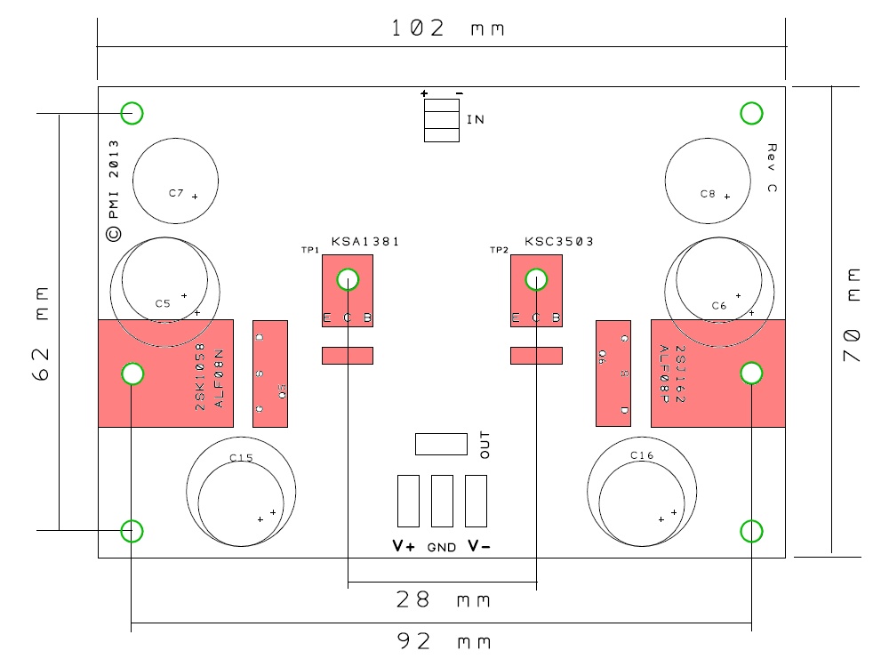

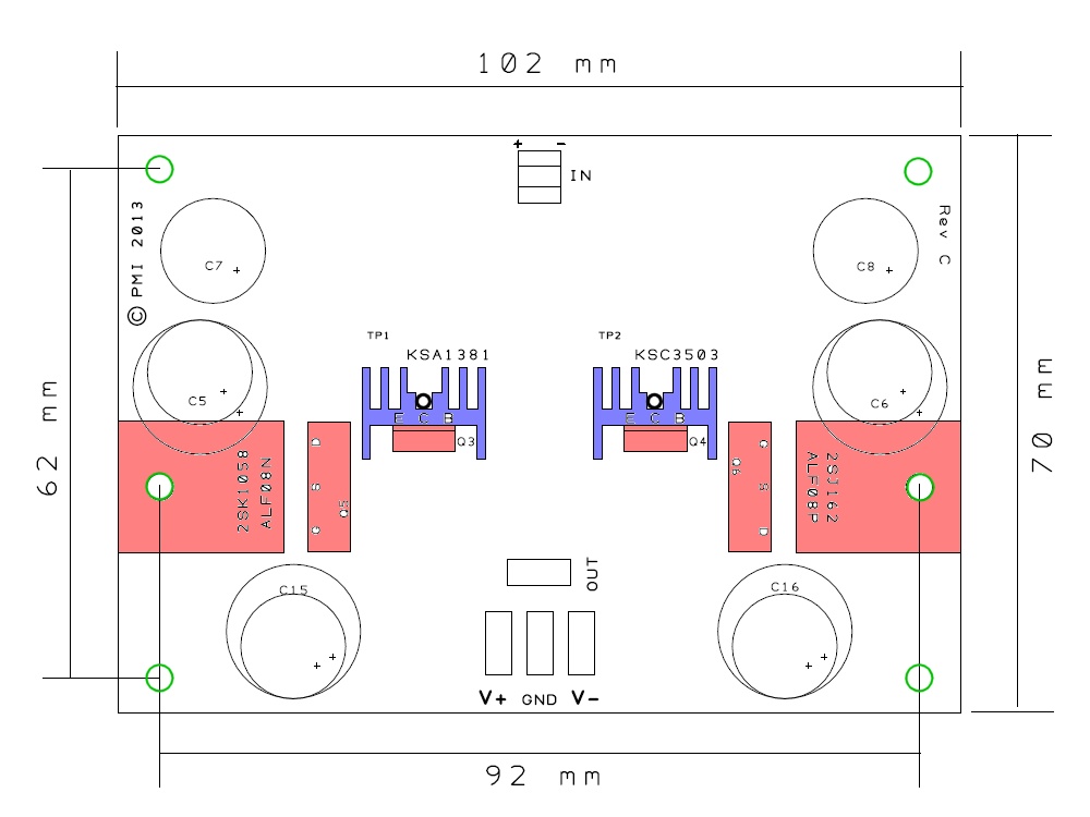

The center distance between those two holes is the same, so you may be able to use the same mounting holes.Pete,
Is the distance between Latfet holes on the new pcb the same as on the previous board so that the heatsinks for the previous board can be used for the new as well?
The board outline is 102x70 mm, compared to 102x64 before. The corner hole locations are different by that amount.
I did not actually use those, even though I designed for them.

I am attaching a couple pics that show the locations of all the mounting holes on the new board. The first pic is the version with VAS transistors and small heatsinks top-side, same configuration that you and I are using now. The second pic is with the VAS transistors under the board. There is a total of 8 holes, four in the corners, 2 for the Latfets, and 2 for the VAS transistors if mounted on the main heatsink. Hopefully nobody will try to use all eight at the same time... 😀Pete,

I agree, but the board can still be used with those, even though space around the part will be smaller. Pads for protection diodes have been added for the Alfets, which apparently do not have internal ones. Sadly the incremental cost is a bit more than 2 cents... 😀My 2 cents : the perfection would be to find place for TO264package and associated hole => Alffet and excicon 16A devices....
Marc
A TO-264 package will fit with the mounting hole just outside the board, and the board will use at least two of the corner mounting holes to keep it in place. I moved some of the parts around so there would be a little more room around the TO-3P outline, and TO-264 will use all of that.
The double-die parts are one of the things that prompted the option to mount the VAS transistors on the main heatsink. I also made sure I had the 2SC3503E on hand for people who want to use a supply voltage over 35V, at least for the first few dozen boards.
TO-3P and TO-247 are almost identical, and the pads have been moved a bit and enlarged compared to the last version, to make it easier for both to fit.
The holes have been made larger for the TO-264 leads. Using the double-die parts implies a higher supply voltage, so the voltage specs for the caps and for the input stage transistors have to be higher also. If using the top-side VAS heatsink, one of the larger (or taller) versions will probably have to be used.

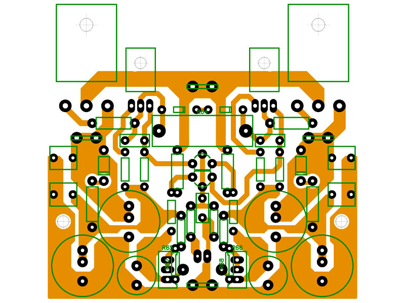

Hi Thiagomogi,Hello guys, does buz900d/buz901d serves this amp?
yes you can use any lateral mosfet, that one must be replacement for the old to-3 one...
You can build the one like Terry/still4given done, layout by Jason post #405 all you need is there.
Or you can build the one with J162/K1058 like me 😀 ...
btw, this is my new PeeCeeBee for easy mounting on heatsink.
Not tested yet, but if you want you can try it 🙂
see attachment!

Hi Jason,
Same with me...
I will build again too...
with nicer parts too I guess 😀 & I guess it matters a bit 😎
Regards
John
Edit:
the new layout use serial trimmer resistor so this one easier to set DC offset(tested when my last build)...
You only need very low value 100-500 ohm trimmer, can use cheap one & replace with resistor when everything fixed.
Please double check also cos I don't build it yet 😀
