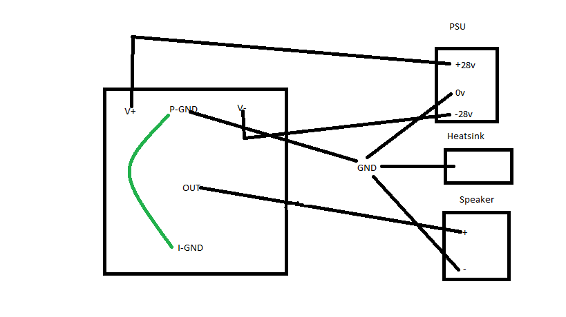

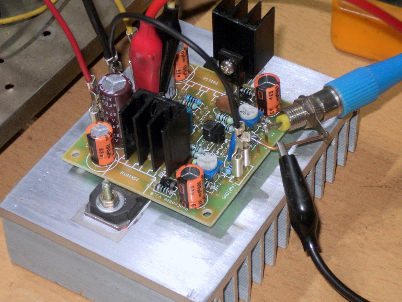

Hello, that's a pic of my PCB v3 on my test bench.
and a pic of the wiring diagram ( this wiring diagram cause the v3 to oscillate ).

Do you hear anything from speaker? Did you measure oscillation frequency? Are the MOSFETs getting hot?
Edit: What value are VAS and MOSFETs biased at?
What I meant by speaker is a 4ohms resistor. no I didn't measure the oscillation because the amp starts to drain a lot of current .. like 750ma per side. yes the mosfets gets hot .
the vas are biased at 10ma and mosfets 50ma.
Can you try this?
Replace 1R zobel with 10R. Remove the 4R resistor (load). Open all connections from the hanging star ground and route all ground wires directly to PSU board's ground with as short wires as possible (including heatsink ground). Turn on amplifier and see if the MOSFETs still draw lot of current. Turn it off. Connect 4R(load). Turn on and see for the same.

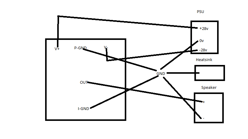

That's the wiring diagram that doesn't oscillates for me.
the input GND wire joins with the power GND ( some amps does that so I tried ). however the thd is very bad.
I'm not sure if the Mosfets got damaged already due the my test that caused oscillation.

Can you try this?
the v3 I'm testing is using a 10R on the Zobel. the only difference is it has a trimmer instead of the diodes to bias the mosfets.
OK, I will try to re-wire all to the PSU and short the GND wire.

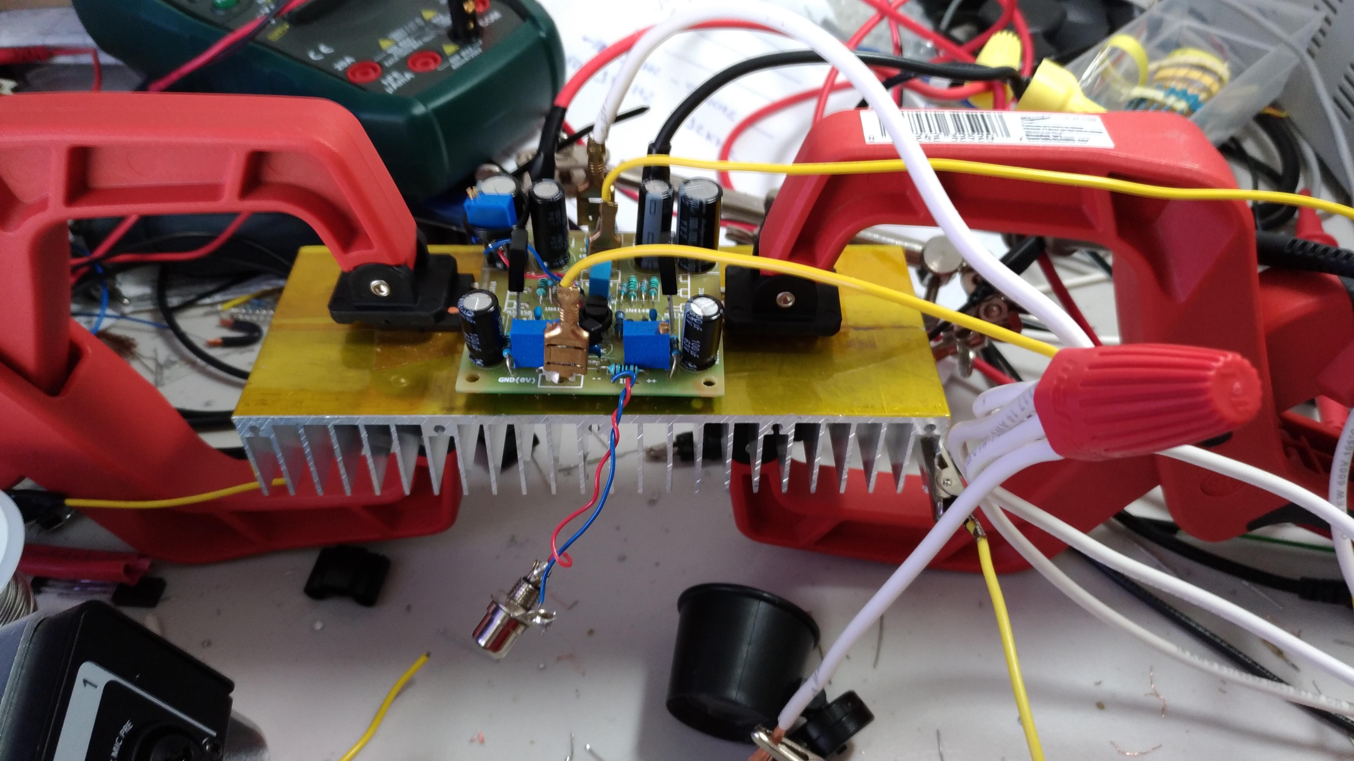

Hi Sebastian.
Is the ground tab near input connected to PSU ground? Is the heatsink shorted to PSU ground?
For proper 15V operation you will need to decrease the two 22K resistors to 10K for a more stable LED reference.
What voltage LEDs are you using? The standard brightness ones have 1.8V drop.
Did you start the amp with VR1 and VR2 trimmed to maximum resistance and VR3 to minimum?
p.s. can you upload a couple pictures?
