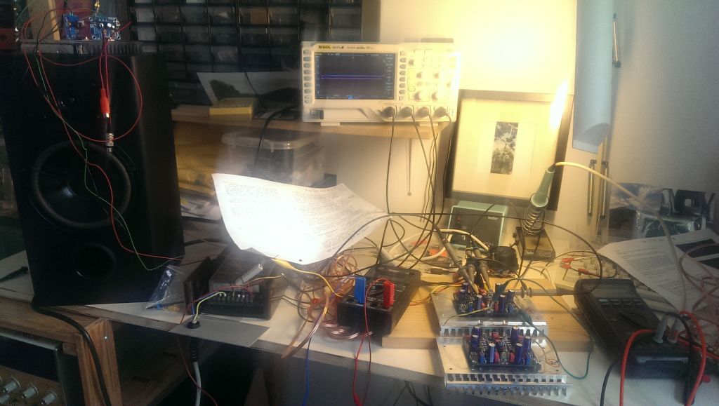

Indeed I have everything in the correct place, the trimmers look right, and all GNDs are connected.
I got standart 5mm LEDs in place, should be around 1,8 Votl, got green and red ones.
I suppose the 10k is not mandatory, but helps for accuracy, so I think I wont solder a new resistor in there until it runs at least for a bit of time.

Please connect the SGND to PGND with a small wire or SGND directly to PSU ground with a separate wire.
Re-check the small-signal transistors and the VAS transistors. If all of them are okay then the amp should be running normally. Also check all the resistors if there have been any mistake in placing.
Do you read any oscillation in the output? Does turning VR1 and VR2 have any effect on VAS bias and output offset?

Ok I did the seperate wire to PSU gnd.
gotta recheck the small signal ones, I just to the quick diode testing on them:
No oscillations on the output, I can ajust the output with VR3 ( just realized you did not mean that) anyway, output signal offset can be varies withing roughly 300 mV, but as I turn the VR3 up, the measured current also rises, from 300mA to 450 mA, then I did stop again, since I fear longer on times will hurt some resistors in my PCB, they get quite hot as the high current implies.
VR1 andVR2 dont do anything on the output voltage, I cannot alter anything by turning them, at least it seems so.
Gonna check the Transistors now and will reply soon.
Thanks for your help already.
All transistors read perfectly with the diode test between base collector, base emitter, i did check thrugh all resistors again, couldnt find any anomalies.

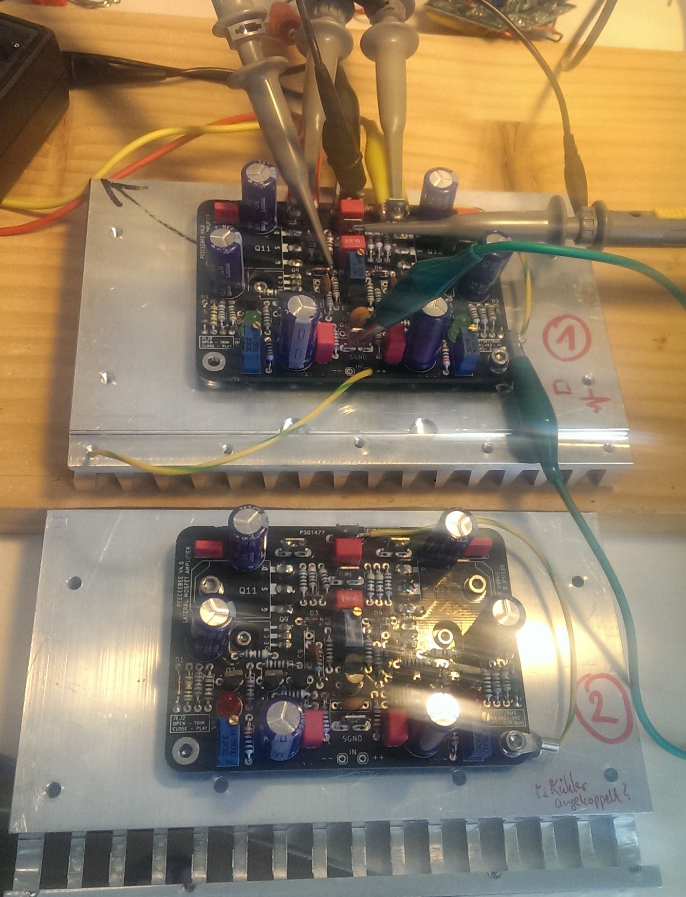

So right now I did manage to at leats produce some magic smoke with one PCB, my supply rails are from a Traco +-15V , but I did connect some 8R2 10W rated in series, so the Peeceebee sees kind of +-11 V, due to the voltage loss, so I thought maybe the whole PCB just hangs up cause of the lack of supply, well I guess I was wrong witht hat thought 🙂
PCB was powered with almost +-15V but after around 20seconds some smoke did appear, so I stopped the measurments , for sure the Q3 did loose its purpose and Q5 also.
I will do some quick checks and replace those.
Ah the death was probably cause, since I did try to play with VR3 to change some offset or at leasts ee anything on the output, then I thought maybe the output signal started oscilating, but I hadnt enough time playing with the scope, adjusting the right timing, before the smoke appeared.
Another strange thing is that the Q9 BD140 is measring 0,694V across collecotr emitter, but I guess that could be some traces around that part, cause I did check another BD140 which isnt soldered in yet and it does not measure such voltages.
With R3 and R4 (2K2) intact that can only happen through Q3 and Q5's base emitter channel. And a faulty VAS transistor and/or oscillation can make it happen.
The 0.694V across collector and emitter seems to indicate that it's either dead or pushed to some out-of-spec state. Can you check continuity between the VAS transistors' collector pins and the heatsink?
ok. Wow, that did suprise me.
On the broken PCB the VAS BD140 indeed has 1R to the heatsink, both of them do.
On the still working PCB they dont.
I dont see any clue why this could happen, but I think you already know why that is?
What puzzles me is that both PCBs show the same ill not working behaviour, but now that something is broken the VAS Collector is connected to heatsink.
The VCE I assume is due to the resistor diode resistor resisto connection in parallel to my measuring points, if you can follow 🙂 So I assume this is correct.
VAS transistors' backs should not be shorted to heatsink. Did you use mica or other insulator between the transistors/MOSFETs and heatsink? If yes then there might be some faults in the insulator and it broke allowing the back of the transistors to touch the heatsink.
The 4148 diodes are reverse biased relative to the power supply polarities. So you can measure a voltage from collector to emitter (red probe to collector and black to emitter), but the same should not happen by probing emitter to collector if the VAS transistors are okay.

If the VAS transistors were touching the heatsink anytime when power was on then this can be the sole reason behind all the distress.

Holy crap, Shaan, I think I found something 😛
But sadly it is kind of a error on your side 🙂
In the schematic and board, I guess you did switch Q1 and Q2 somewhere int he process.
It does make perfect sense, all uneven and even Qs are PNP and NPN type respectively, but in the circuit diagram you did name the transistors wrong.
And guess who just found out that his input "differential" pair ( as it looks like it to me ) is simply wrong transistors.
I did look at your board picture for a while, and di the manual tracing from Q1 the collector is going to R18 and to its negative supply.
Q2 collector is going to R17 and the positive supply, but in your schematic its simply wrong.
I gotta say, this whole thing could have been avoided if you would have made the effort of putting the board files up, instead of those pictures...
But then again, this is diy and I still appreciate your work, just stating what helps to make things easier.
What really wonders me right now, so many PCBs got sold, like over 100, right?
Did really noone else find out that your Q1 and Q2 are switched, so I have to assume there are 98 builders which simply are naturally more intelligent than I am 😉
cannot wait to resolder and write if this did then finally work.

Ok, I did switch Q1 and Q2 on both PCBs and for now, no more excessive current drawn, looks pretty good until now.
I will start the biasing procedure now and will get back when I produced my first sounds.

Indeed! Q1 and Q2 designation have been swapped in the schematic. My apologies. Things would not have been this bad for you if that blunder didn't happen in the schematic which you've been following all this time. Great job finding out the mistake. Congrats and thank you.

im too lazy right now, but i got some scope shots and measurments ready maybe upload tomorrow.
Thats it for now, call it a day, thanks a lot for the day support shaan, glad that i could test some sounds at last, feels good.
