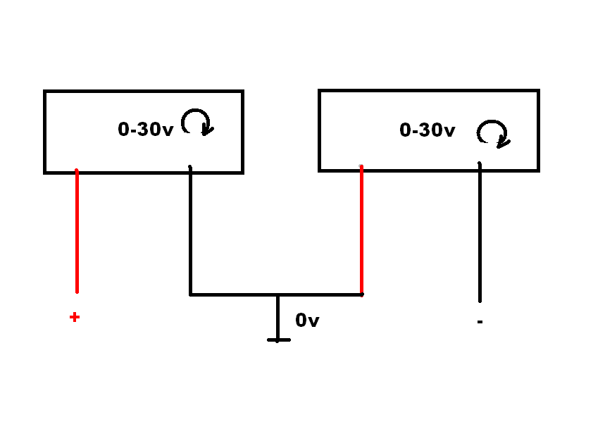

If you have a new pair of these output fets,fit them,only ONE pair.
Test with a lower voltage using the same protection.
If two regulated power supplies(With the adjustability of the current limiter) are available, use them.
One power supply for eatch rail.Start from 10V(look at the Amperometers).

No,i don't mean Variac.Hi thimios,
I always fit MBT before testing any ckt. Plus the 10r for this Amp.
Unfortunately I don't have any more of o/p device. I so probably take a break and look to order more.
No variac for available with me😱
I mean two separate adjustable power supplies.
Do you hear a continuous beep when testing output fets using DMM?
No my dear friend, I don't have those unfortunately. Can you suggest a ckt?
Use two lm317 circuits if two transformers or a transformer with two separate windings available.No my dear friend, I don't have those unfortunately. Can you suggest a ckt?
