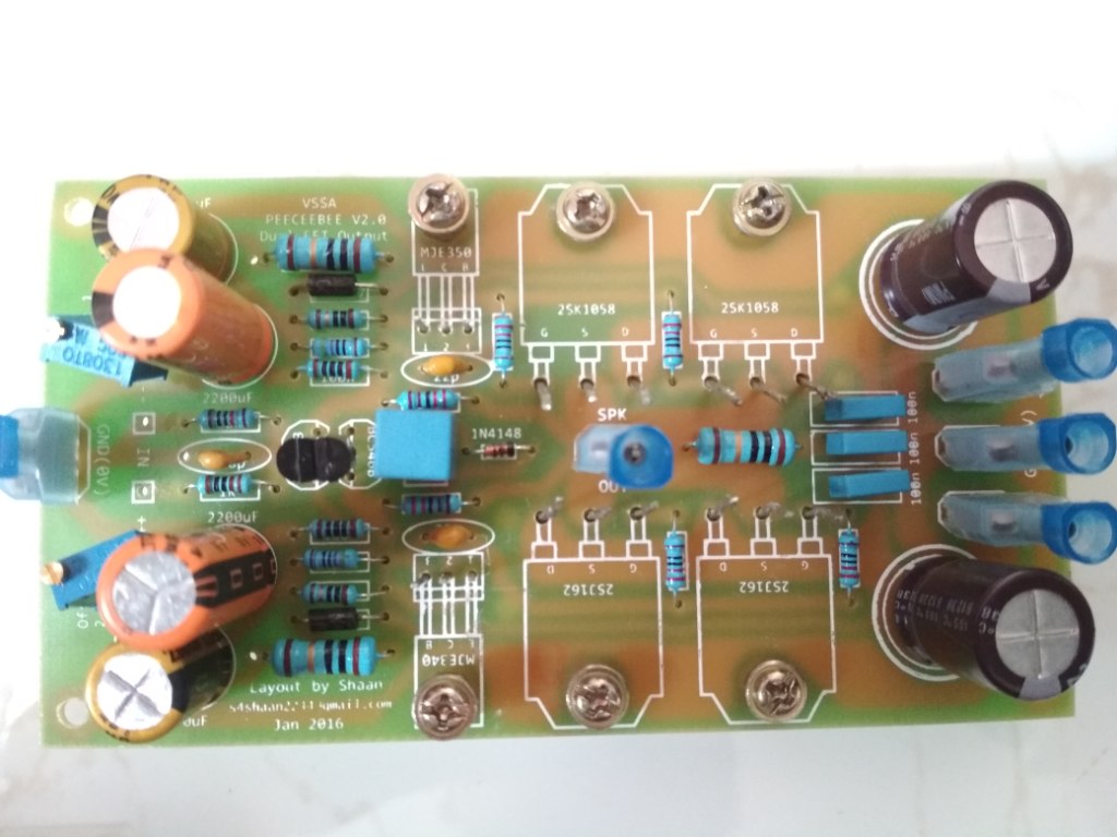

Here is my V2 build.
used nichicon 220uF 63V for rail decoupling
i/p decoupling, used nichicon gold kz 220uF 63V
and for feedback, used keltron 2200 uf 16V.
funny, esr was lowest for keltron😕 and value was very very close to the nominal value🙂..
just finished soldering , yet to clean the bottom😱. I hope I dont run into problems. fingers crossed for testing.

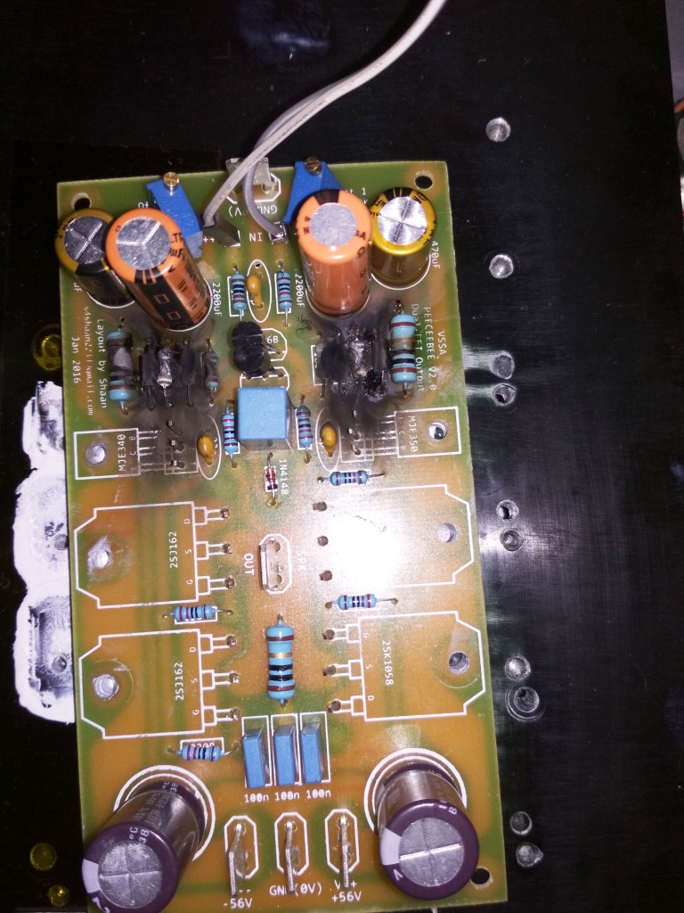

I would like to know whether the bias is ok for v2. seems much much less as compared to V1.😕
I thought lats have optimum bias at 160 mA. VSSA, PEECEEBEE and Apex FX-8 that i built used about 130 -200 mA.
the joy was somewhat short lived.

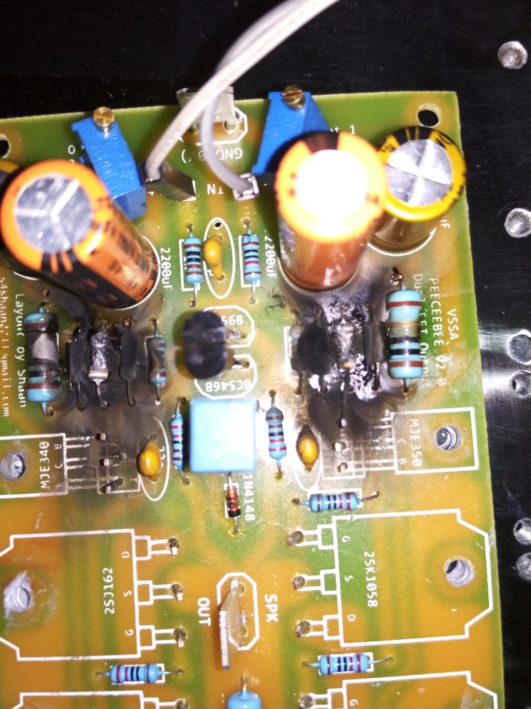

while listening music, there was some sound and fire😀. I immediately hit the main switch.
bad resistors that shorted?😕
or problem with MJE's?

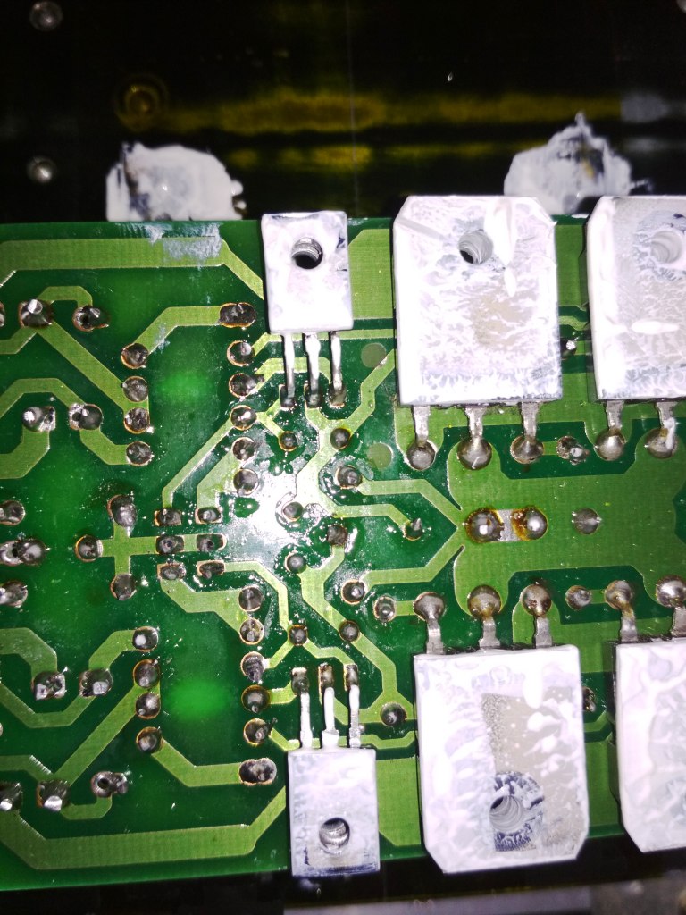

bottom side is quite fine.
same pattern of burning on both sides!!
