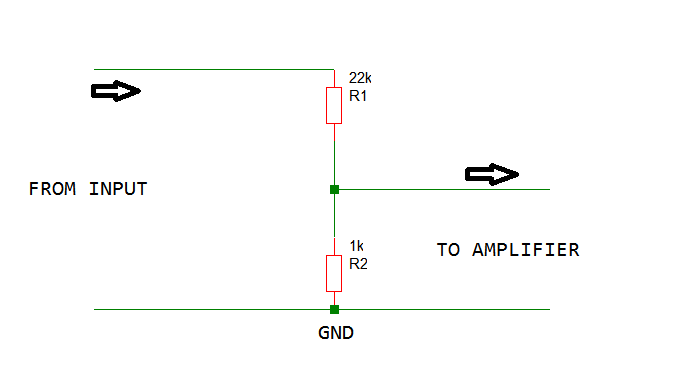

please tell me, does the lower gain of this amp increase the stability? i drive horn speakers with vssa and would like to lower the overall gain, to say x5 or even less.

Lower gain in this amp will decrease stability. If you want lower effective gain from the amplifier then I would suggest you keep the amplifier's internal gain at default 23 and use a resistive divider with 22k+1k at the input. This configuration will make the amplifier behave like a unity gain follower.
Procedure: Join one end of both resistors to each other. Connect the external input signal wire to the open end of 22k. Connect the amplifier input to the two resistors' joint. Connect the 1k resistor's open end to ground.
See attachment for illustration.
