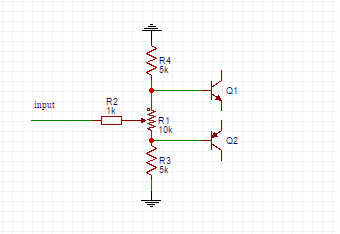

Hello guys.
Alert !! Beginners question on amplifier design:
I found that the challenge of building a VSSA is the matching of transistors.
So my question is did someone already: to put a trimmer between the input of the first BJTs, and the idea is to not put the 2k2 feedback resistors. So one could adjust first the trimmer to account for mismatches on the BJTs and mosfets included. So only after the trimmer adjustment the 2k2 feedback resistors would be put in place.
is this idea work?

Capacitor coupling at input might be inevitable.
IME, trimming without the feedback resistors is extremely hard or nearly impossible as without them the amplifier is working with its full OLG and the output will stick to one of the two rails.
You may want to try this idea with the feedback resistors installed and turning the trimmer to find the sweet-spot while looking at the 1KHz spectrum on a PC based analyzer.
Matching of the input and VAS BJTs is good but extreme matching is not necessary. A difference of +/-5% will be no problem in this amplifier.
The two trimmers on the PCBs does the same thing as R1 in your attachment, but work in the emitter nodes which is much safer and also doesn't demand capacitor at input.

Interesting. the idea is to have the amp on a lab psu during the adjustment phase and the tests should be with no load. and oscilloscope is somehow also needed to help with the adjustment or detect any sticking to rails.
I got like more around of 200 bc560c/bc550c already .. and best match I got was ~15%.
So I'm a bit frustrated. 🙂
Thanks for your explanation.
