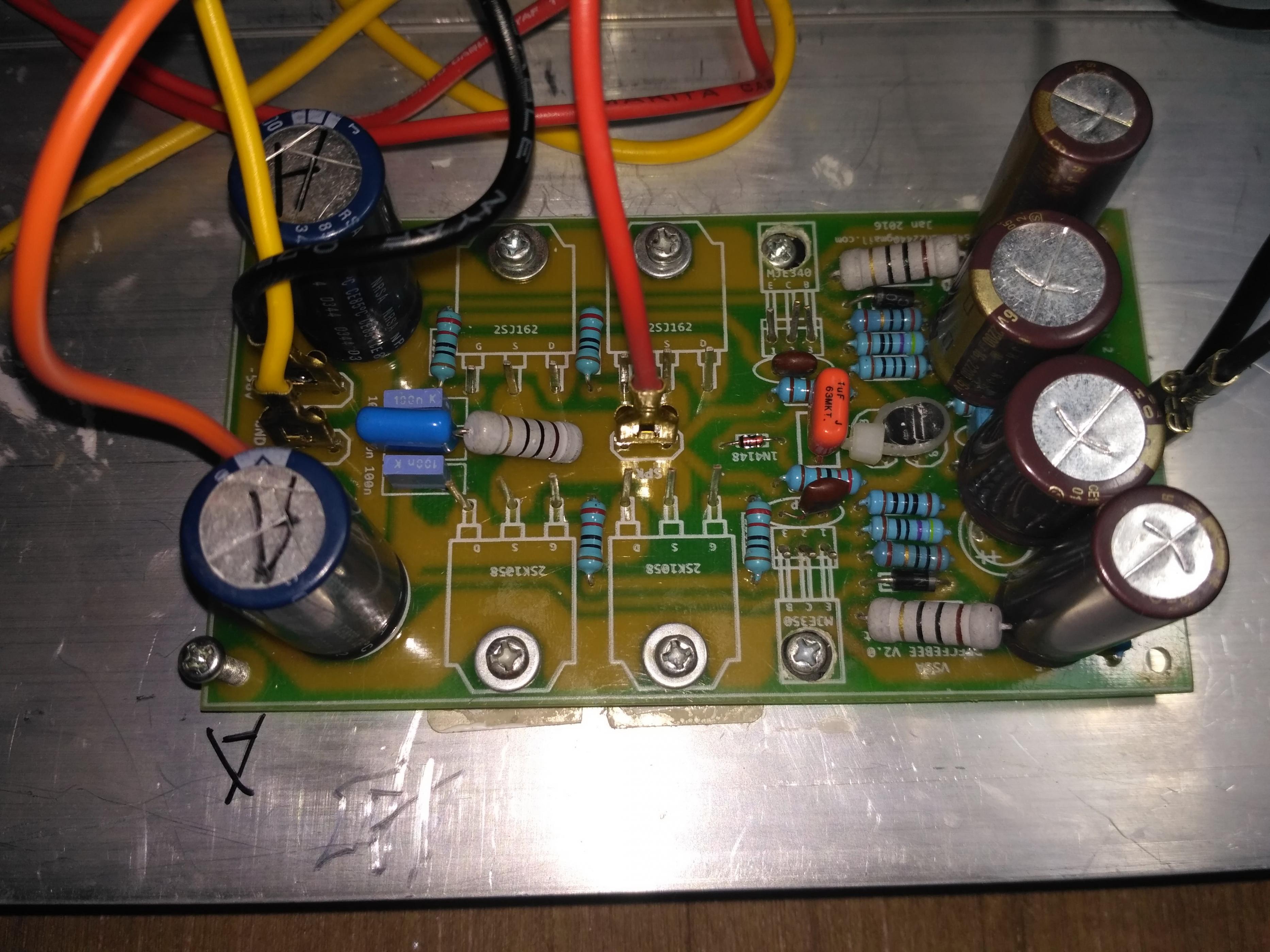

Ok i will measure the diode this afternoon. What is the voltage should read across that one?
Between 600mV and 800mV.

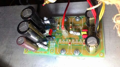

AwesomeHad been having a hard time with time. One of the boards gets populated, ready to be tortured.
Looks good eh? 🙂

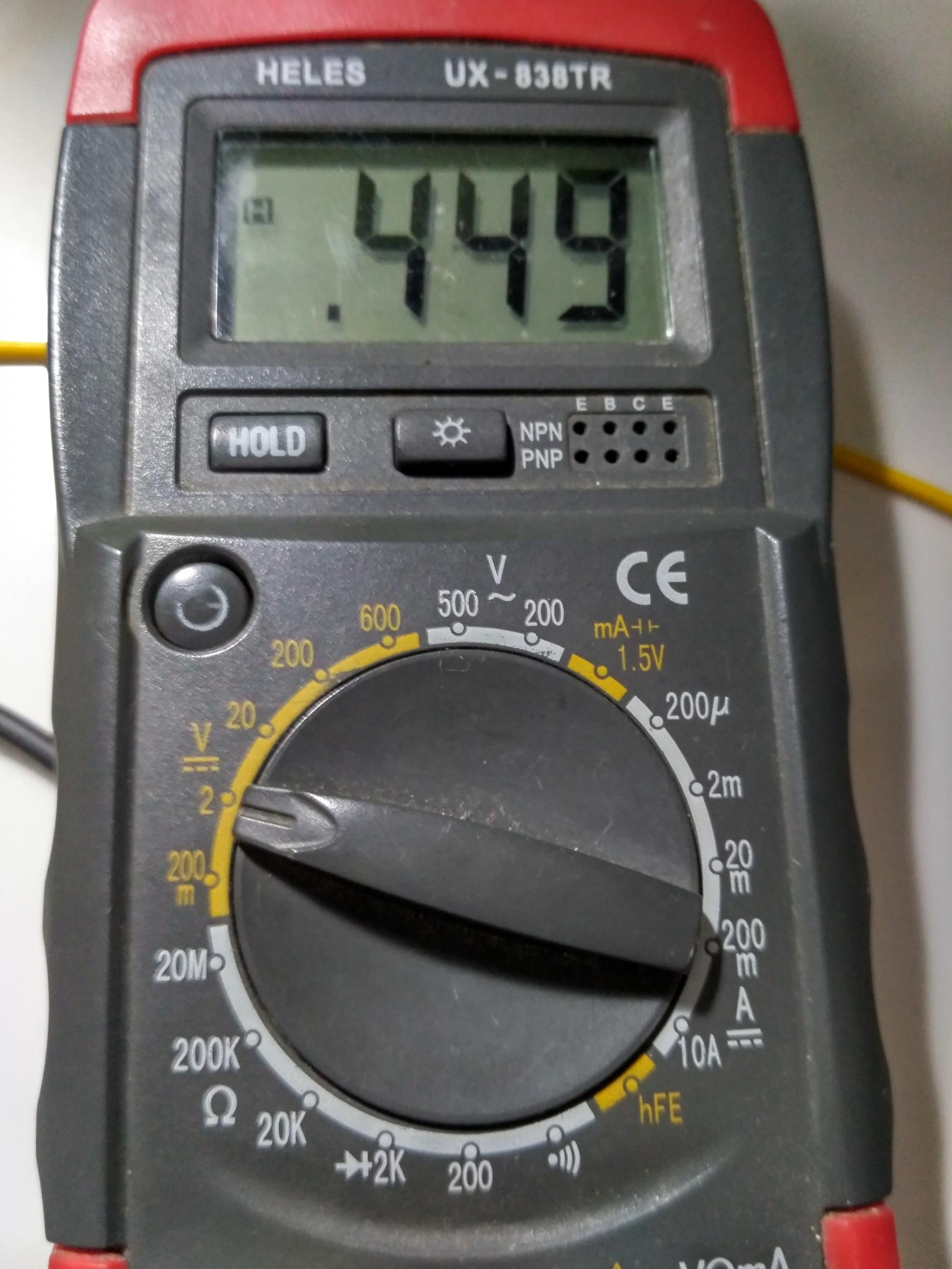

Measurement I conducted last night. 449mV across diode 4148

This voltage indicates less than 0.1mA bias in VAS section, which is too low.
Check the voltage around two 10R/1W resistors near the VAS transistors. Measured voltage should be 100mV for 10mA VAS bias. You will need to turn the two trimmers to get the VAS bias to 10mA. If bias don't get near 10mA even after turning the two trimmers to zero resistance then turn them back to maximum resistance and change the two 27K resistors to the next lower standard value i.e. 22K and then check the two 10R/1W resistors for voltage drop again.
With proper VAS bias the amplifier will sound pleasing even with 30mA MOSFET bias.

thank you so much for your advice Shaan..highly appreciated...
Best Regards

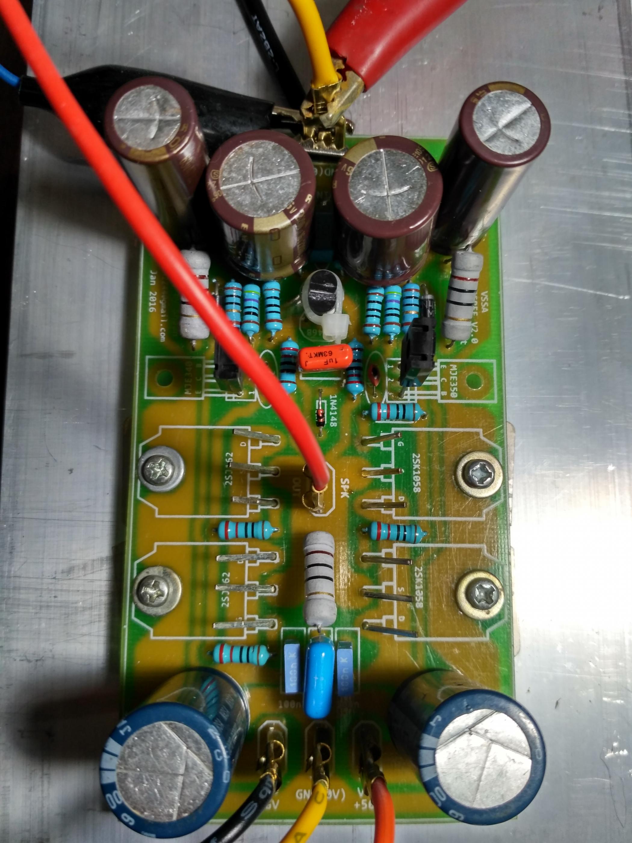

My VSSSA has 80mV across 10R/1W... my mistake, I put 33K resistors at previous. I replaced the 33K resistors with 27K. The mje’s now are installed bellow pcb because they are getting hot at 80mV. Heat sinks are a little bit warm.
I will try to set bias into 100mV later. Is it possible to rise bias more than standard and what is the advantage?

In simple terms, A higher VAS bias keeps THD low by allowing the MOSFET gates charge/discharge fast. 10mA-15mA is sufficient for these MOSFETs.

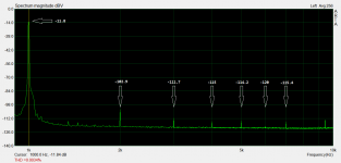

Today I did the first spectrum analysis of the new V4 PCBs.
This wasn't to happen until I got a 1KHz sine source which had extremely low THD. Yesterday the diy signal source was finished and measured 0.002%. Finally a low distortion reference for the new boards.
All got plugged in today and I took some measurements at 10WRMS (9VRMS) into 8ohm resistive load.
Total harmonic distortion is about 0.0014% (measured THD minus source THD). Well that is a very good looking number I know but the distribution of harmonic levels is what seemed interesting to me. If anything, this time H2 seems dominant.
Off to test 1W and 55W levels.

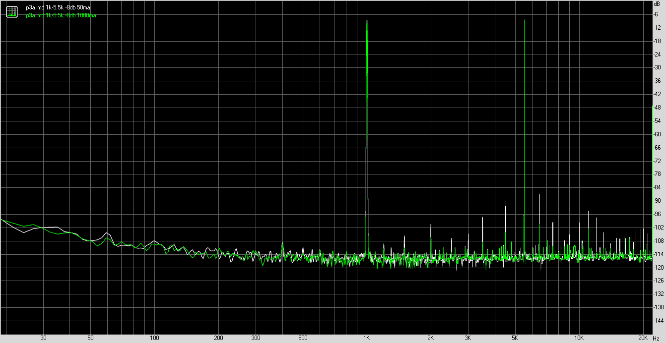

I did run this imd test against my test p3a -
1k and 5.5k at -8db it gave a 5vpp signal @ 4ohms
two tests 50ma and 1 amp biasing.
