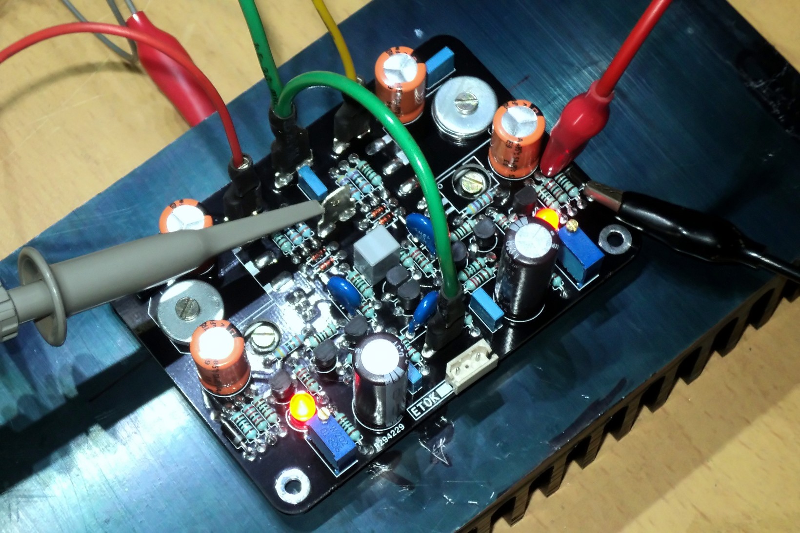

PeeCeeBee V4 PCB powered-up and running! 🙂
Some initial data,
NPN small signal BJT average hFE: 300
PNP small signal BJT average hFE: 350
NPN VAS BJT hFE: 180
PNP VAS BJT hFE: 150
Matching = Non-existent. 😀

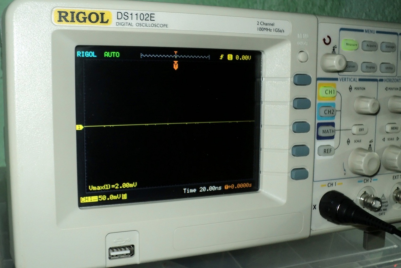

The miller caps are double of the required value. I don't like it but I haven't any 47pF left! Time to order a box. Btw, no clicks no pops no noise no hum no oscillation. Input BJT pair not thermally coupled. Zobel resistor(s) cold.
Offset at cold-start with both trimmers set to 700ohm: -55mV (trimmed to +2mV)
Cold phase offset: +2mV
Warm phase offset: +6mV
Cold phase VAS bias: 9.9mA
Warm phase VAS bias: 10.1mA

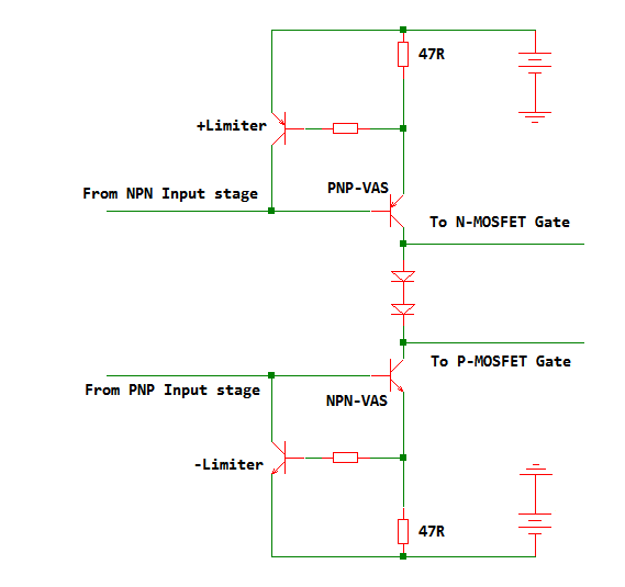

I was experimenting with the VAS current limiter transistors and found that while the two small signal BJTs perfectly limit VAS current to a very safe 16mA (47R VAS emitter resistors), they cause some problem if they are left "active" during playback. The problem they cause is a huge decrease in slew-rate; in the order of 2-3V/uS!!!
The solution is simple and easy - turning off the limiters after the amplifier has been fully set-up and ready to play music. For this, a pair of single-position DIP switches that short the base-emitter pins of the limiters will be added to the final V4 PCB.
The switches would be set to "open" when first-time setting up the amplifier, letting the limiters monitor VAS bias. After trimming VAS bias and offset, the switches would be "closed" to turn off the limiters and let the amplifier work with its highest slew-rate. Bias increase in VAS due to limiters turning off is about 100uA-150uA which is no problem. Offset will also change a few millivolts but can be safely trimmed back to zero without any chance of VAS over-current.

Why keep the those current limiter if they will be used only for setup? can you limit the current by using a psu with current limiter during the initial setup?
Please see the attachment. These limiters do not limit overall amplifier current. They only work to save the VAS transistors from burning-up in case someone accidentally turned the Input bias too high. The symmetrical VAS used in this kind of amplifiers is often feared for its bias being directly dependent on the input-stage bias. The limiters make sure that after a fixed maximum VAS bias current has been reached, any extra current coming from the input stages is prevented from entering the VAS transistors' bases and VAS current can't increase any more. For this the limiters need to be active during set-up.
Their downside is as previously mentioned, slowing down the amplifier too much. And for this they should be turned off after setup is done.

the 47r in the base to emitter of the protection transistor will start to turn on when 8.5mA flows through this resistance and it will have reached full limiting when the current is trying to hit 12.8mA.
If that 8.5mA is too low to allow the circuit/VAS to operate correctly, then change the BE resistor to a lower value than 47r.
Let's suppose the VAS needs a degeneration value of 47r, then split that resistor.
28r between the base and emitter and the remainder of 18r or 20r on the emitter of the VAS.
You can choose any two resistor combination that adds up to the required degeneration value.

I noticed that the VAS current can be increased to over 15mA with the protection transistors installed. I think the Philips BC5xxB transistors I am using have a higher vBE than the usually expected 600mV.
Even if we split the resistor, there might be situation that the combination of these resistors needs to be changed (either one of them or both). If both needs to be changed then double the mess, and if only one then its the same as changing the single 47R to like 39R for a higher ceiling. And as there is almost no free space on the board to add a pair extra resistors near the limiters it seems practical not to split the emitter resistors. (I really really don't want to make the board any bigger that it is now. (about 91mmx63mm))

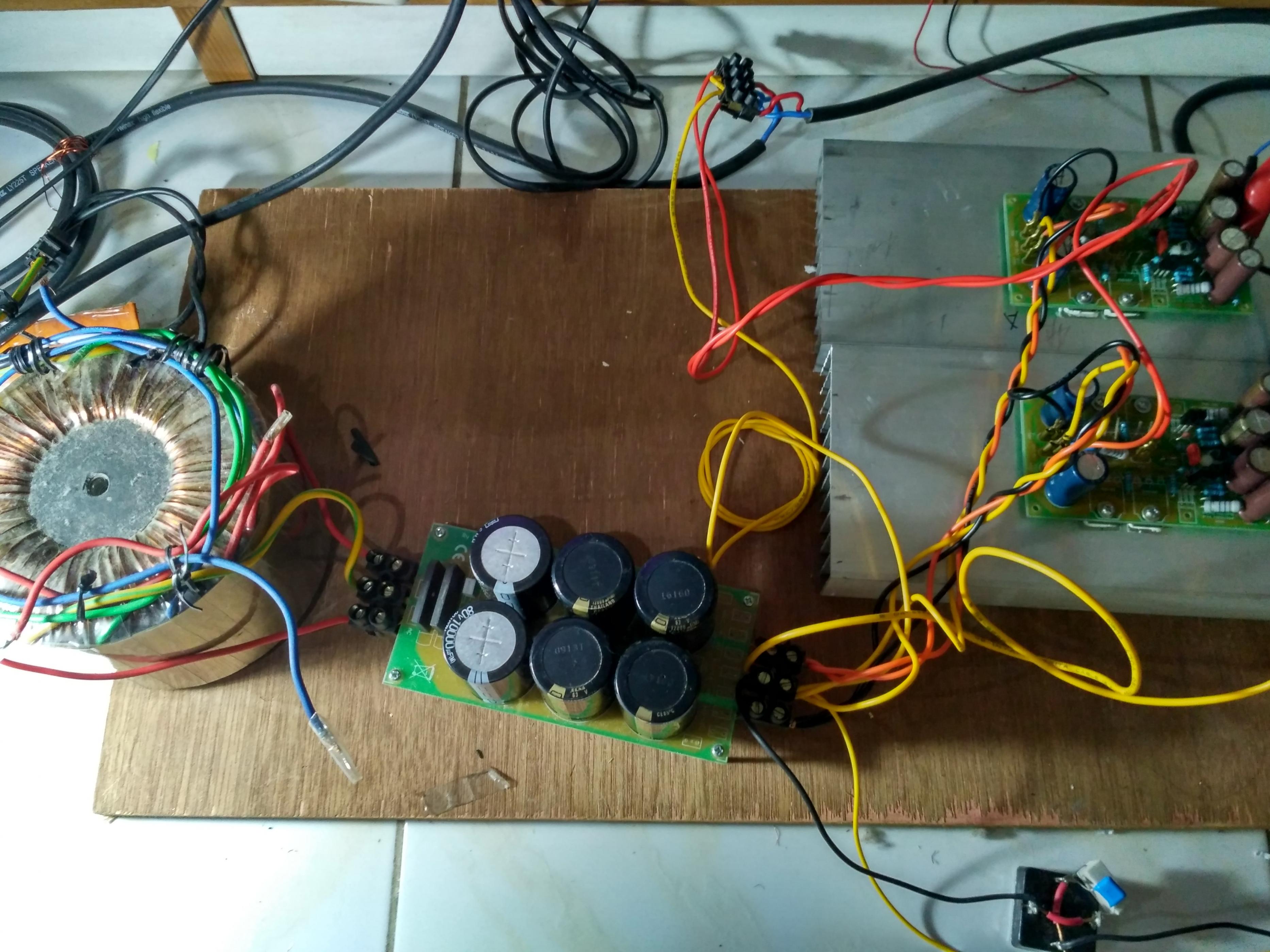

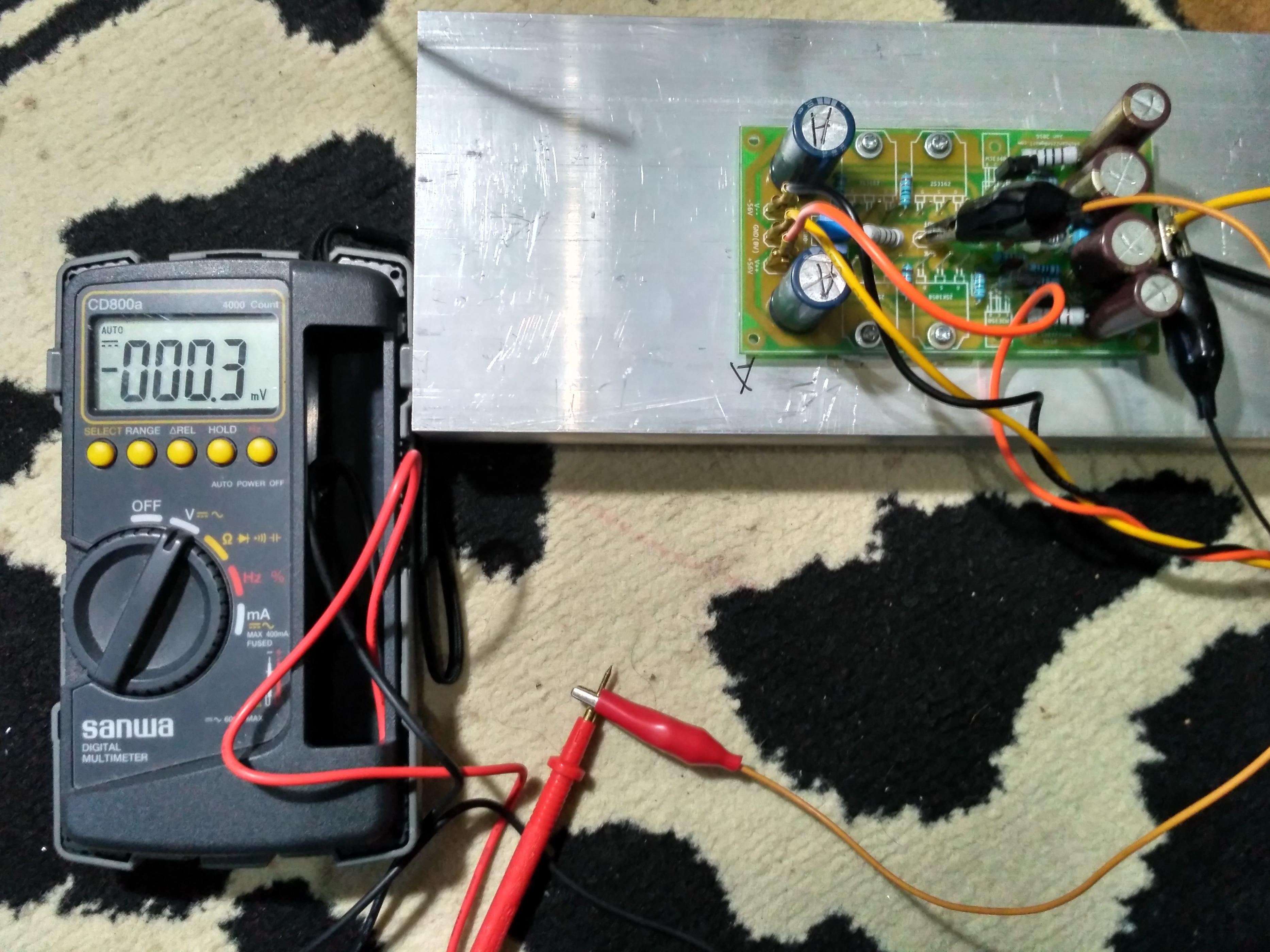

I have just finished building my second VSSA V2, supplied by 40 then 38Vac. But the heat sinks still cold not even a little bit warm after some tracks.. need your advice. Thank you
testing board, sorry for cable mess,

...the heat sinks still cold not even a little bit warm after some tracks..
The MOSFETs are probably running at zero bias.
When the amp is on, what voltage do you read around the 1N4148 diode?
Can you upload a sharp close shot of the boards?
Ok i will measure the diode this afternoon. What is the voltage should read across that one?
