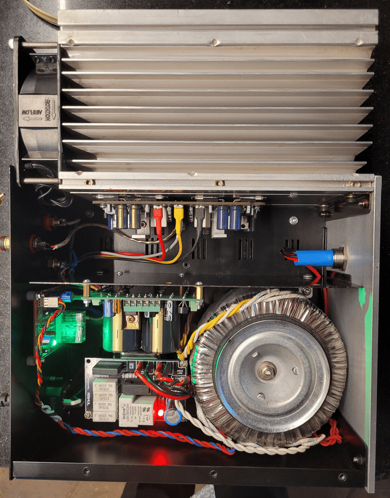

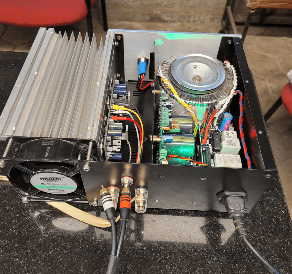

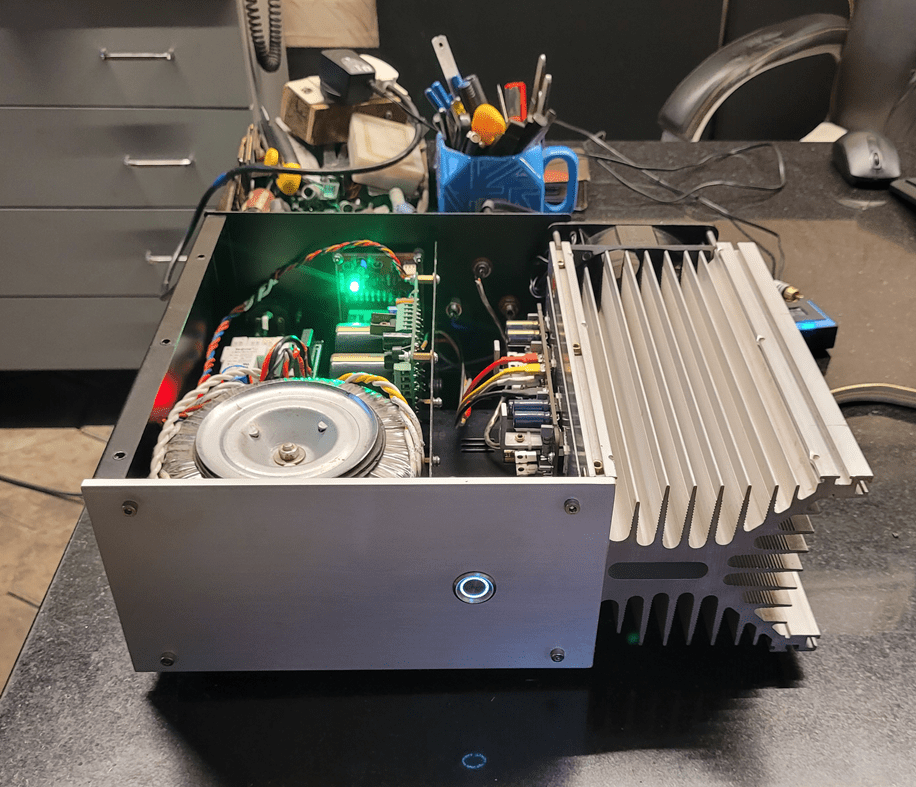

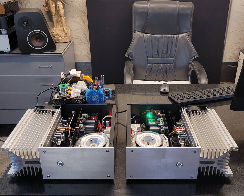

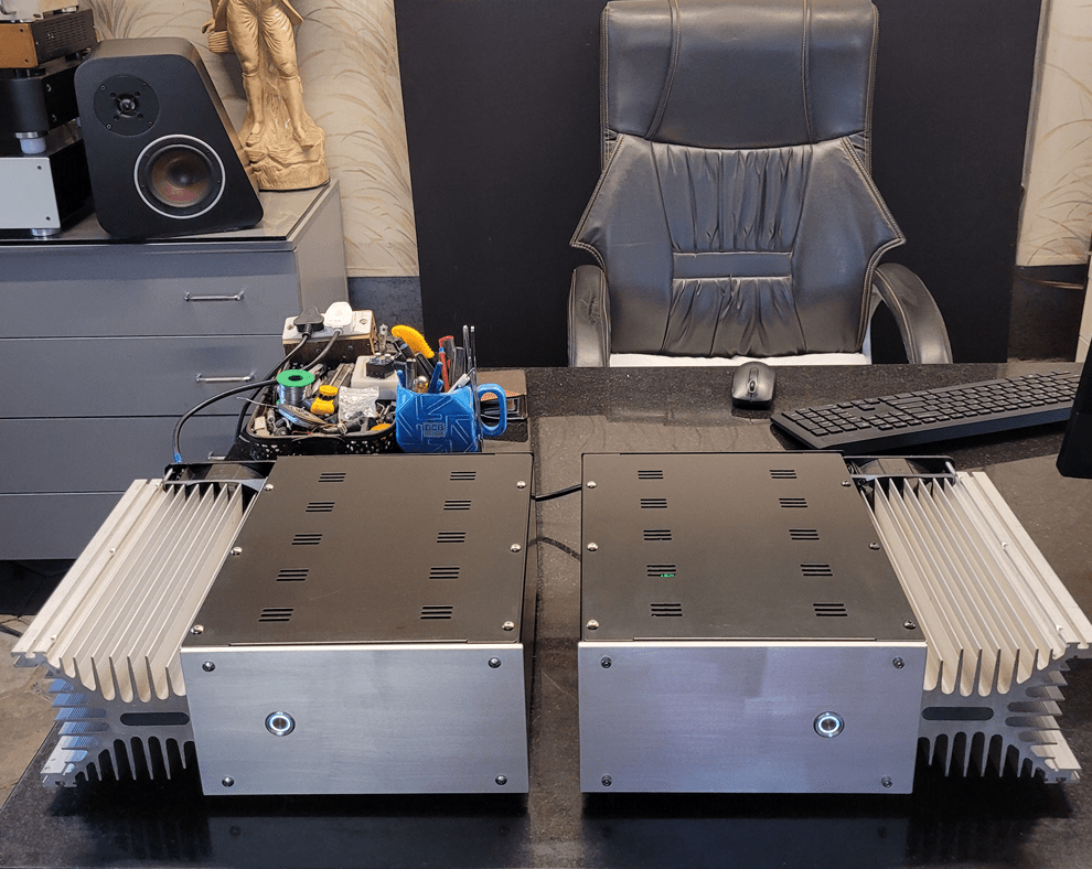

Finally completed the mono blocks build... mighty pleased with the final outcome.

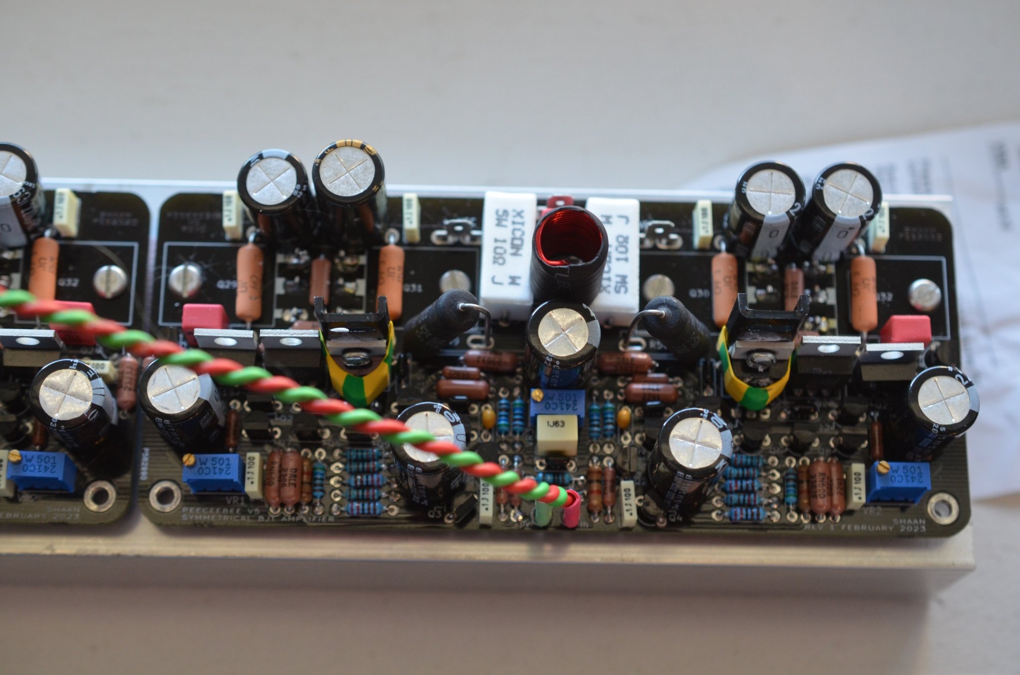

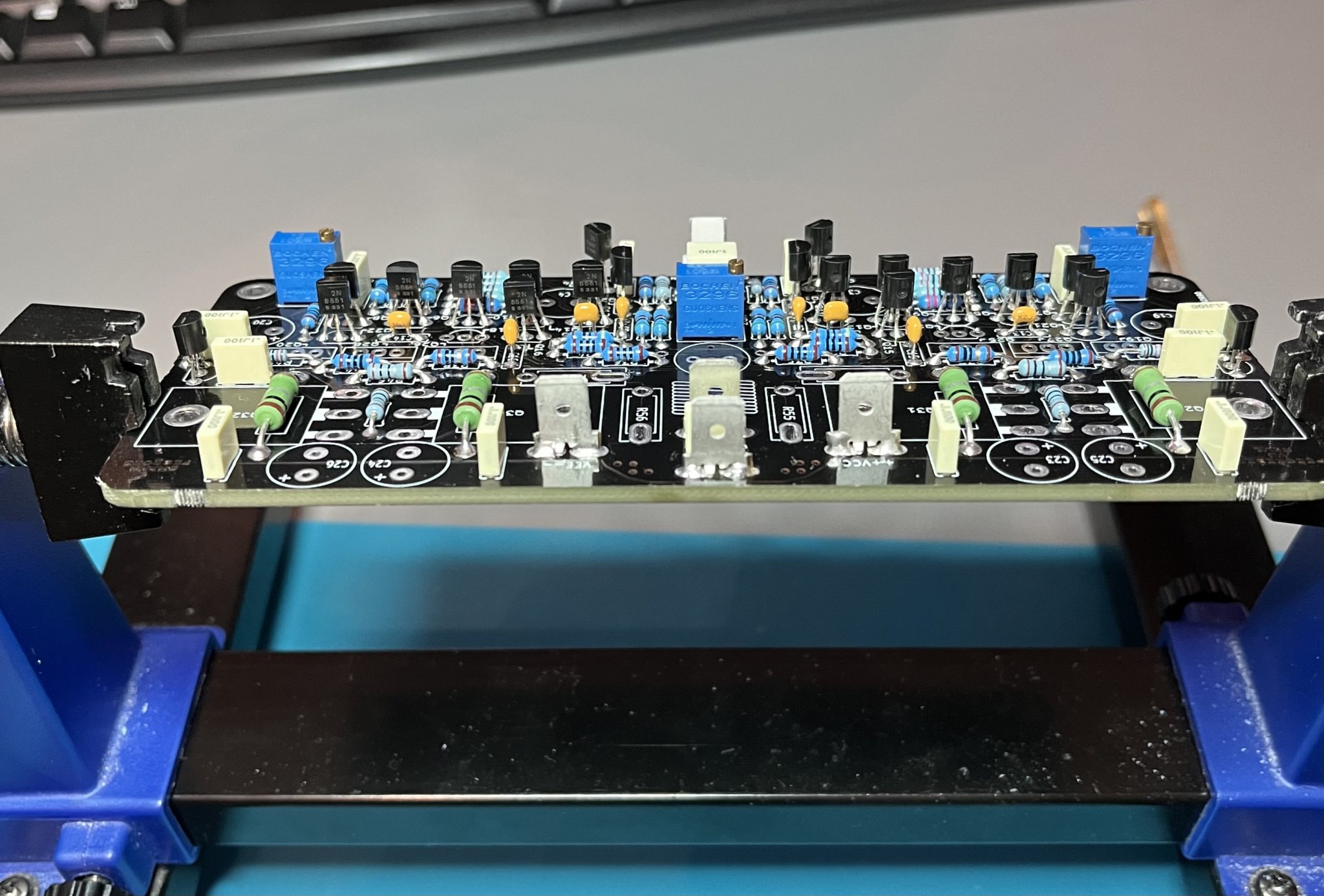

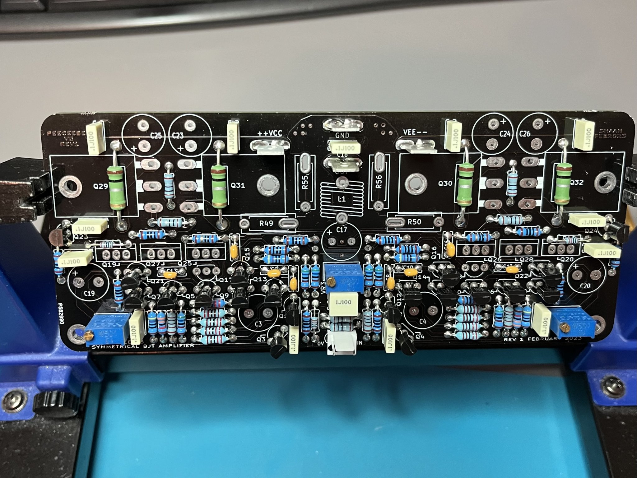

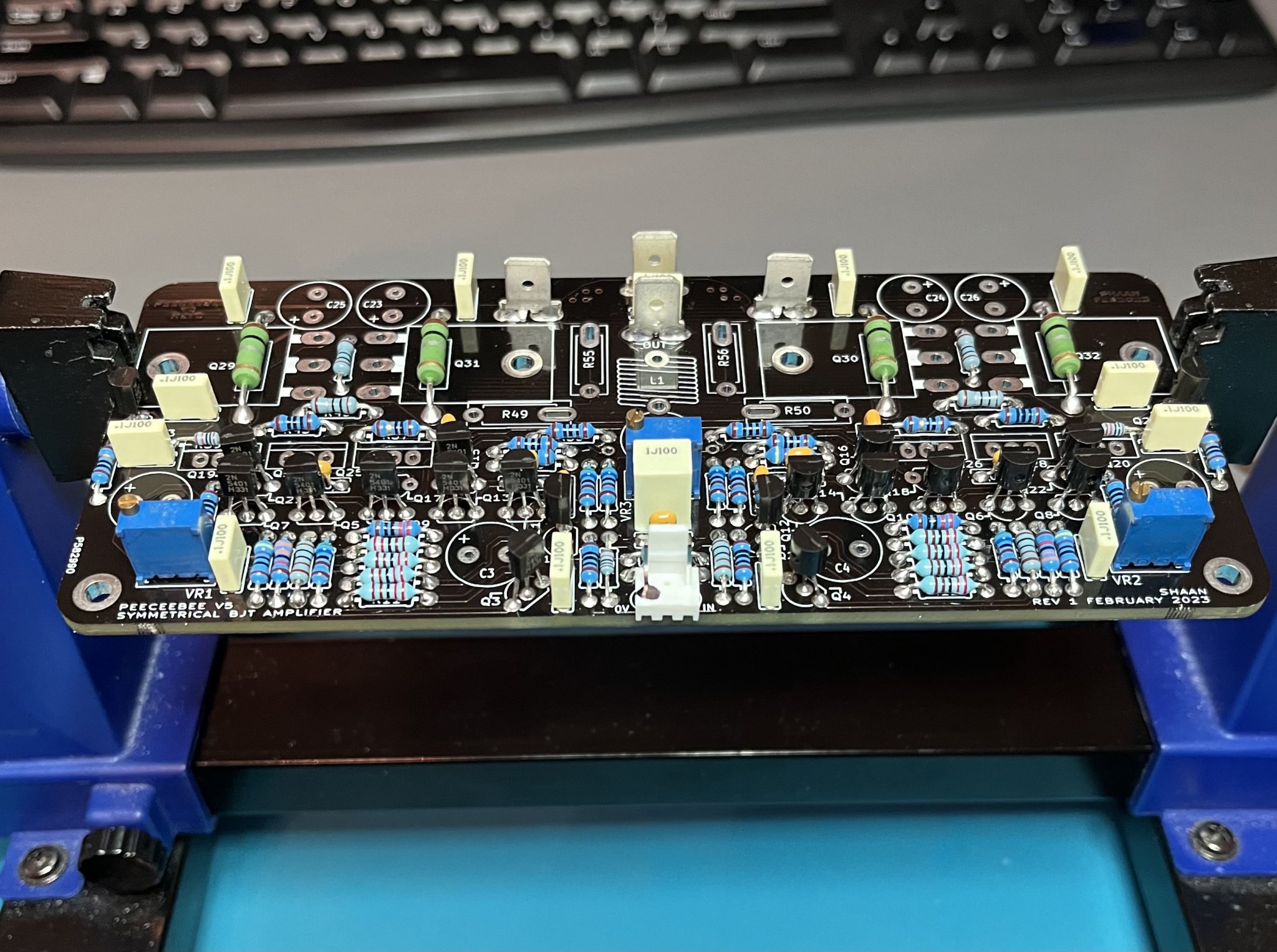

Couple pics of my first channel in progress

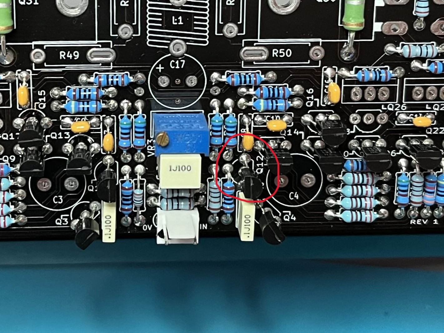

Well got one channel up and running and only one issue - I had 40V on the output when I powered it on for the first time. If you look closely at my pictures (can't believe I did it) but I placed Q2 in backwards. Found the issue as soon as I applied power to set the VAS current, glad I had a second DMM on the output.
Easy enough to fix, but takes a lot of heat to get all the solder out of the holes on these boards - a minor blow to my ego, thought I was going to be perfect on this one??!! (yeah right!!)
Easy to set the VAS, but the DC wanders a bit, same thing when setting the BIAS, the bias and DC tended to wonder a bit - took about 30-mins after an initial 30-mins of warm-up to get Bias set and be pretty stable +/-10mV at 145mA (or 145mV across a 1-ohm resistor on the -VEE).

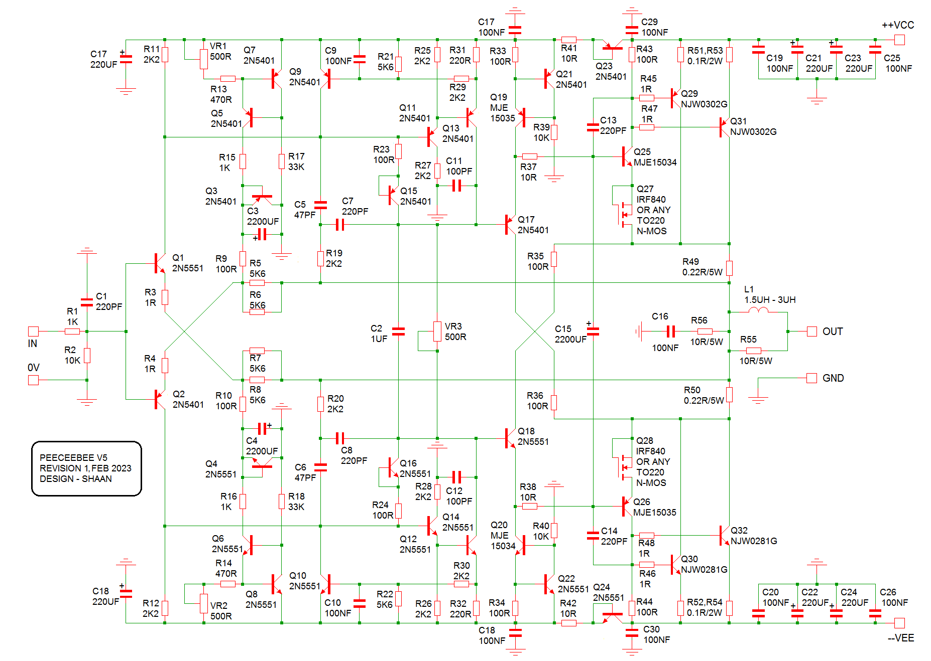

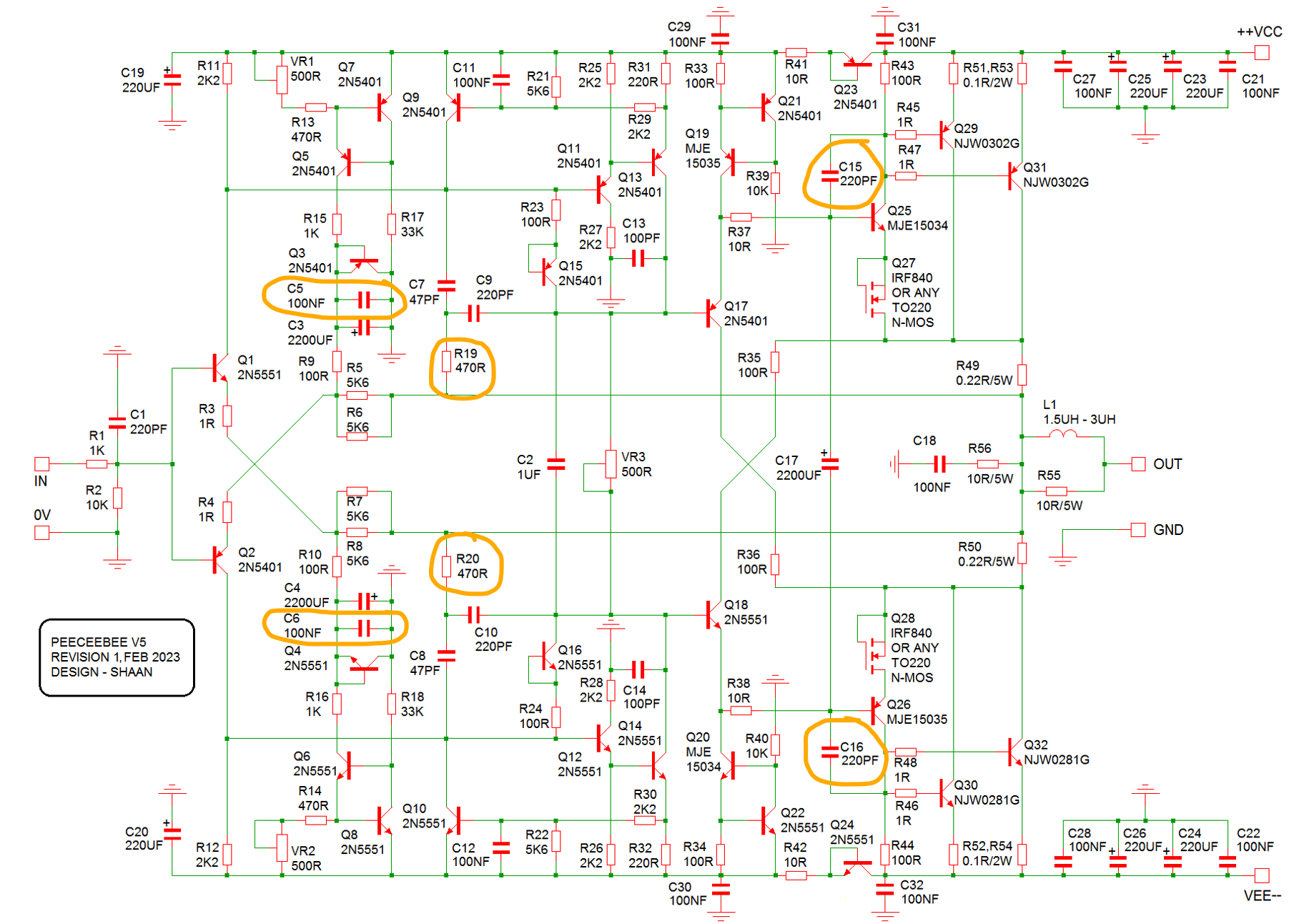

I don't know if we're talking about the exact same thing but this somewhat odd HF behaviour was gone after changing the two 470R resistors to 1K/2K2 (either is fine) (R19/20) and the two 220pF capacitors to 100pF (C13/14). It's basically a slight ringing due to a combination of VAS loading and the baxandall compensation network characteristics. With these changes of components, it has been tranquil around here.
I will update the schematic and BOM with these parameters. I am trying to give Q25 and 26 some space without omitting the mosfets (for easier heatsink attachment). I have tested the amp with discrete 1A rated fast diodes in their place but ended up going back to the MOSFETs' parasitic diodes. I was about to omit the two trimmers VR1 and VR2 as the VAS bias can be permanently set to a safe bias using 270R or 330R instead of the trimmers (due to the limiters), but this takes away the offset control so the idea got discarded. All component markings on the PCB remain unchanged.
View attachment 1328183 View attachment 1328186 View attachment 1328187

@shaan I built my 2nd channel board and have been listening tin stereo the last couple days and on my test speakers everything sounds fine, but after changing to my reference speakers (more reveling in mids and highs) there is something missing in the midrange, and a scratchy harshness in the upper midrange. Test speakers have a pretty good "smile" frequency response, where my reference speakers are close to flat from 100Hz-14kHz
I want try your suggestions above before I make any final listening impression comments, but a little confusion on my as-built schematic (attached) and the one in Post #1 of this thread.
1) Post #1 schematic appears to have omitted C5/C6 (100nF) which alters the Capacitor numbering. When you mention C13/C14 being changed from 220pF to 100pF, would that be C15/C16 on the attached schematic? Both schematics have the same disclaimer - Revision 1 and Feb 2023?
2) Post #1 schematic has R19/R20 as 2k2, but you mention 1k and 2k2 above and previous thread post. Do you have a preference/recommendation since I have both resistors on hand.
3) Thoughts on C5/C6 being omitted in the Post 1 schematic - should those be removed from my boards as well?

Wanted to come back after making the suggested changes to C5/C16 (220pf to 100pf) and R19/R20 (470r to 1k). I'm still trying to find time to get some hours of real listening sessions in... but the upper-mid harshness is gone, replaced by a crystal clear, revealing nature to what I've heard so far.
I suggest if you have not done these changes, to do them - the sounds difference was immediately noticeable in my system.
