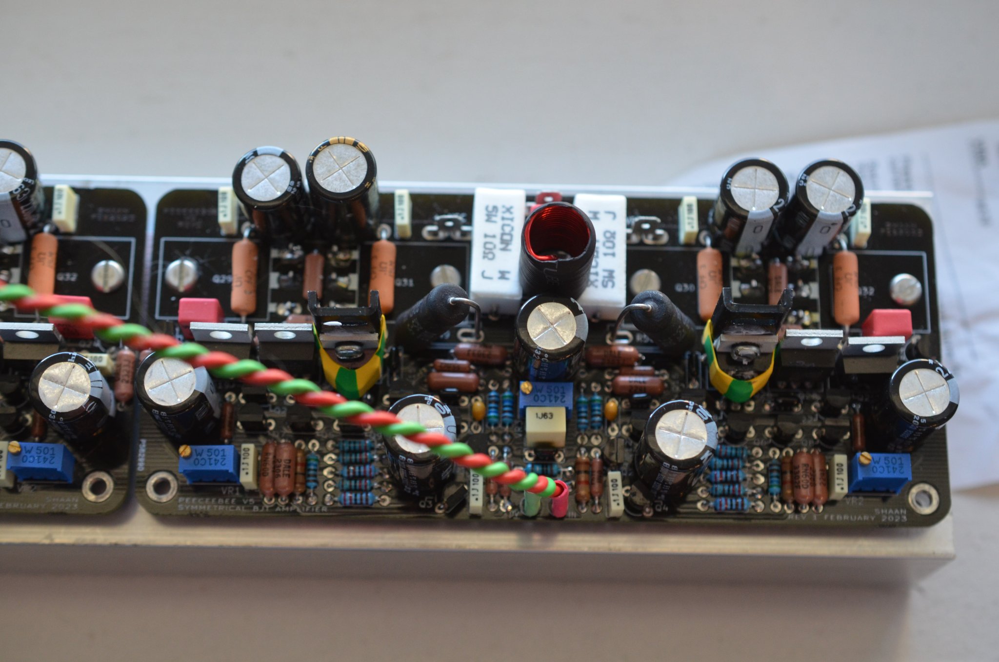

I have a question about big transistor mounting. Is it recommended to:
- bend the transistors flat against the board, then put the screw through both the PCB and the part? or
- Leave space between the transistor and the PCB, and only run the screw through the transistor. The screw head would be between the PCB and the transistor, and the screwdriver would go through hole in the PCB?
Just put an old bd139 or so between PCB and power transistor . This way you've your space and also a firm mounting .I have a question about big transistor mounting. Is it recommended to:

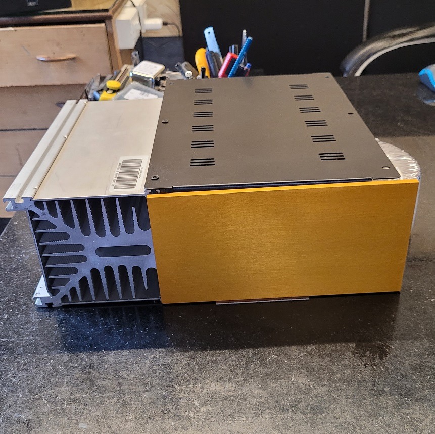

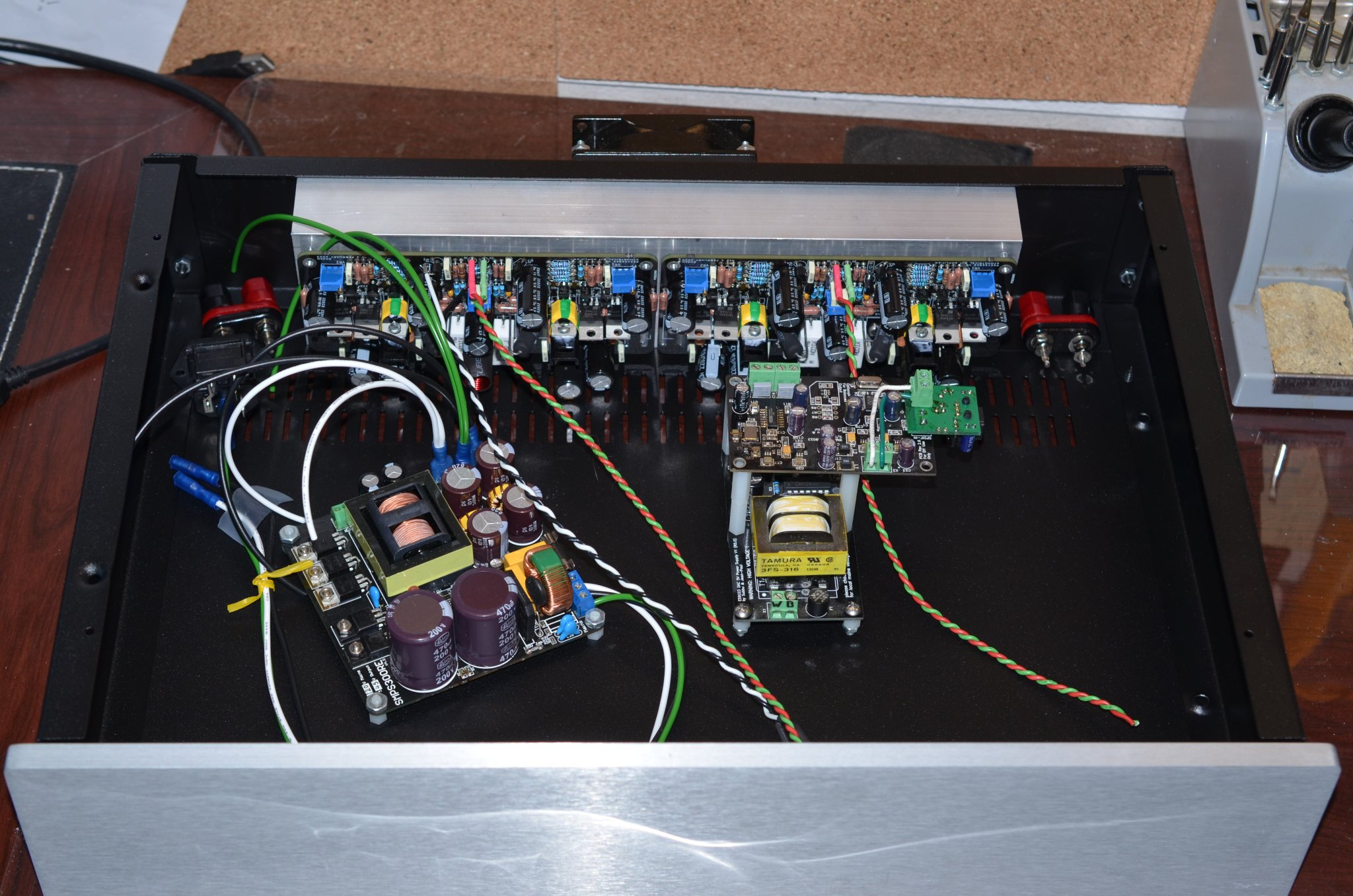

As promised. Here is my progress on the PeeCeeBee V5.
- Case is the Pesante 2U from Modushop by HiFi2000.
- The heatsinks will be flat against the back of the chassis, with a fan forcing outside air through the heatsink channels
- I'm using the SMPS300RE switching power supply from Connex Electronic.
- I also have the Subbu DAC, a group buy from 2013 Subbu DAC with an old Twisted Pear TORX unit, So the only input will be S/PDIF

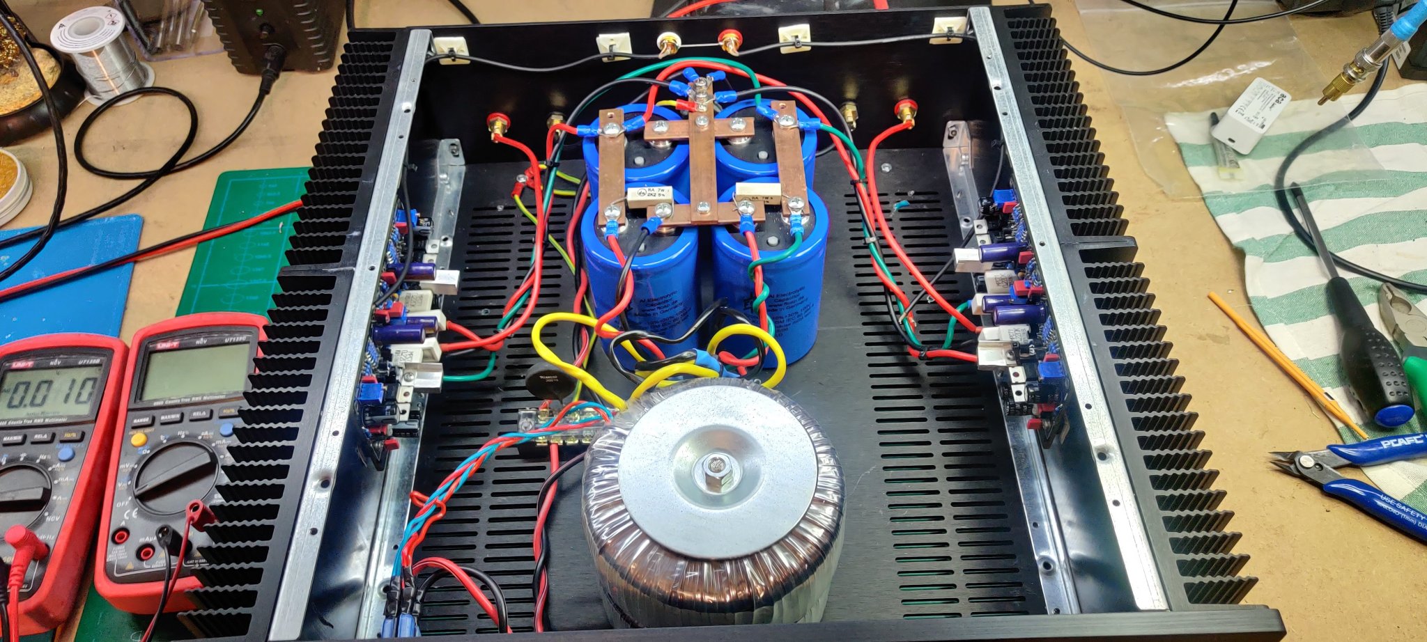

Hi all,

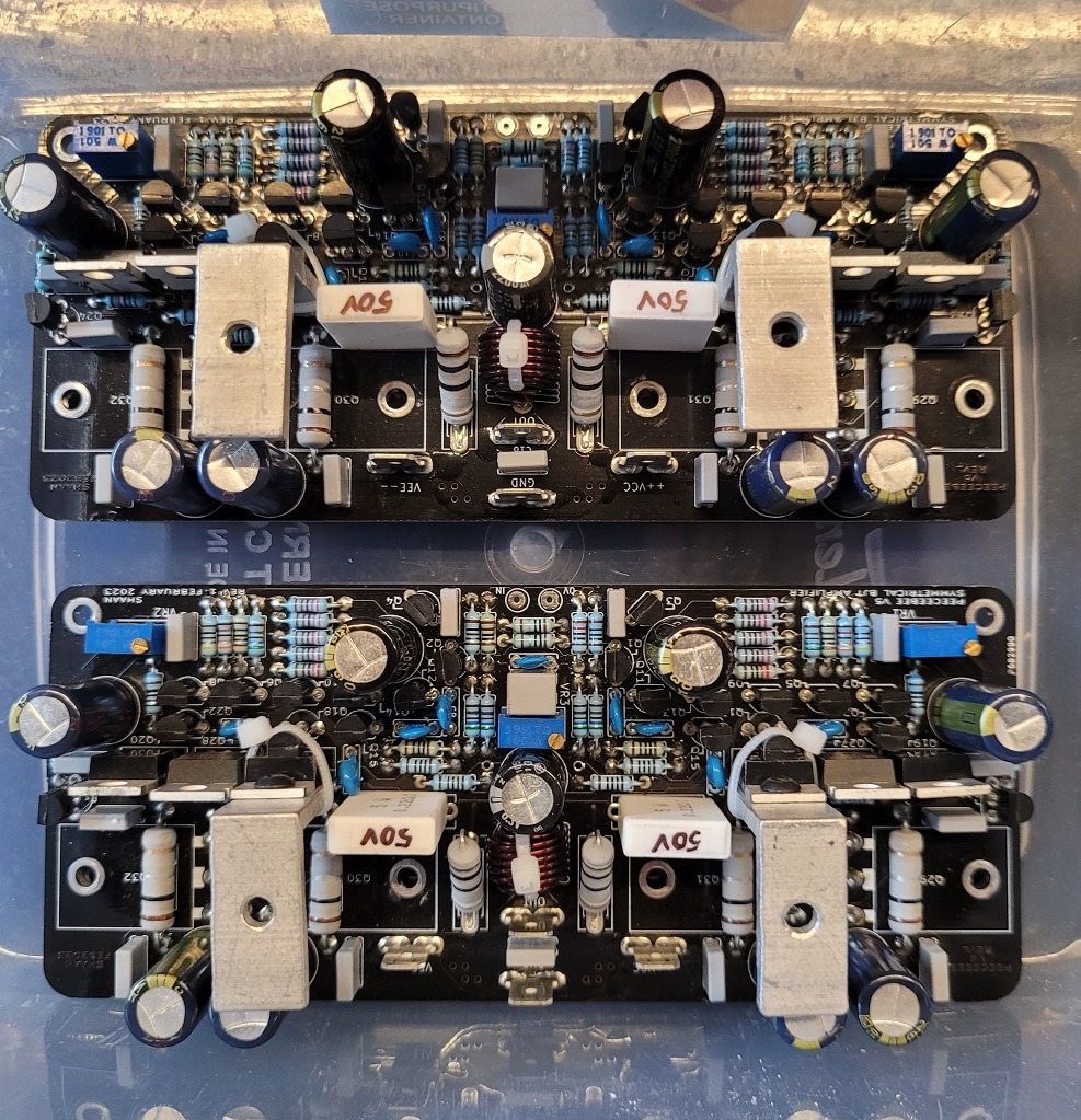

Recd the V5 amp modules some time back... will start the build soon.

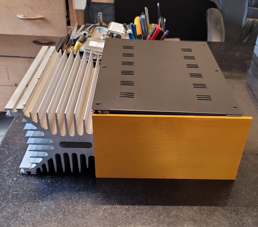

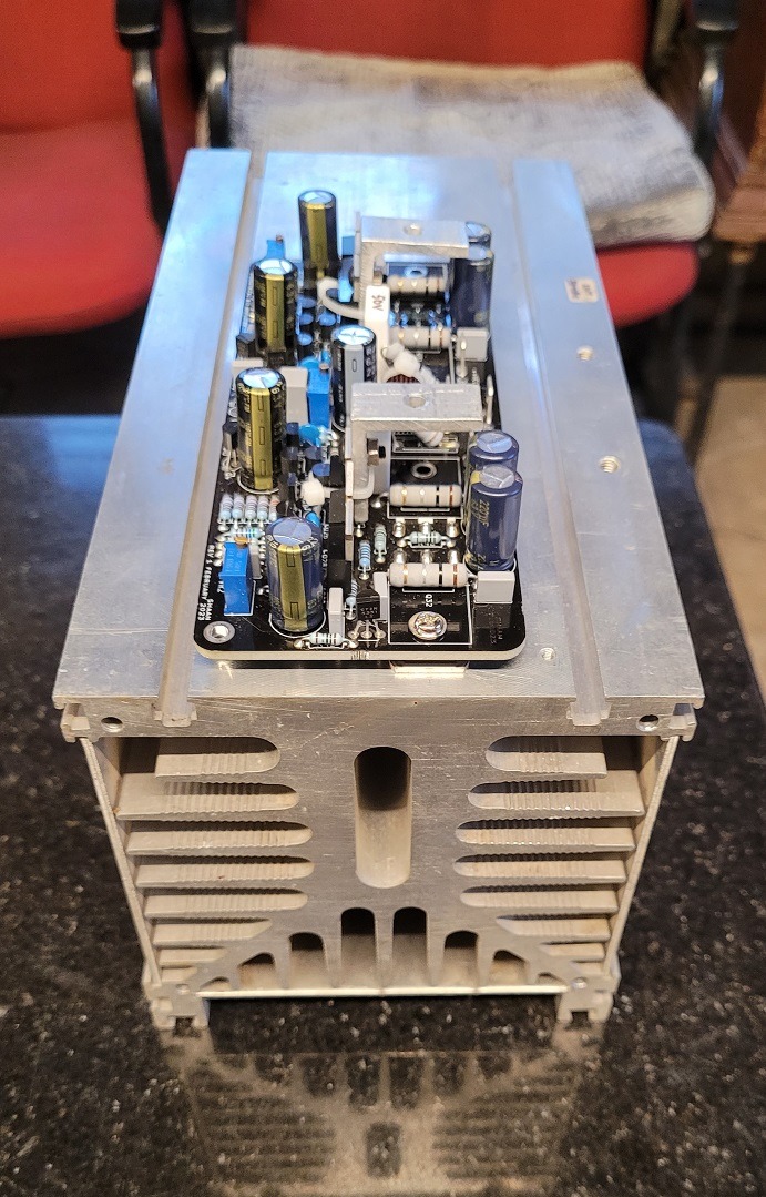

The heat sink... BTW planning to build mono blocks.

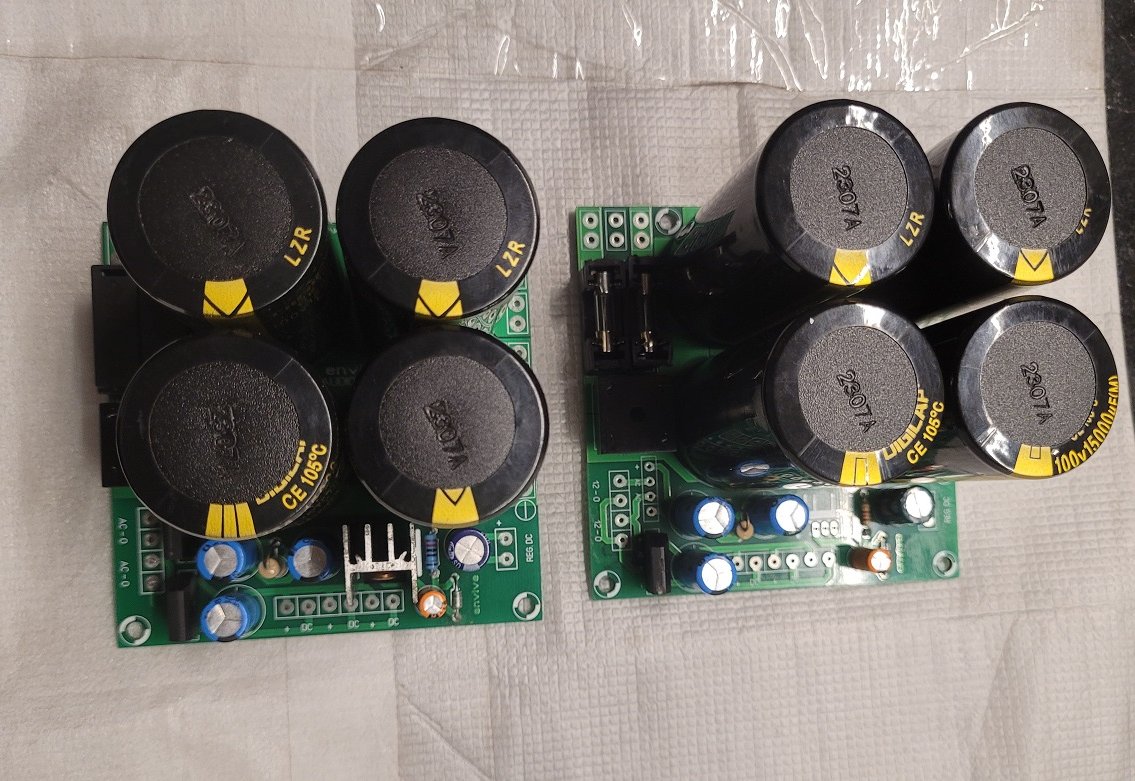

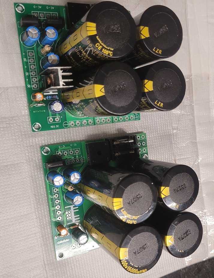

PSU modules: 4x15000 uf 100vdc... trafo will be 35-0-35 600va on each channel.

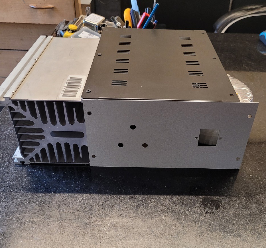

Proposed chassis: front view.
Rear view: yet to get them made.
Nice build George! particularly the bus bar arrangement... can't see the capacitor bank tethering to chassis though... what is the trafo rating and capacitor values?
It seems to be… a big heatsink?
(Which is good as in this position airflow will be suboptimal…)
