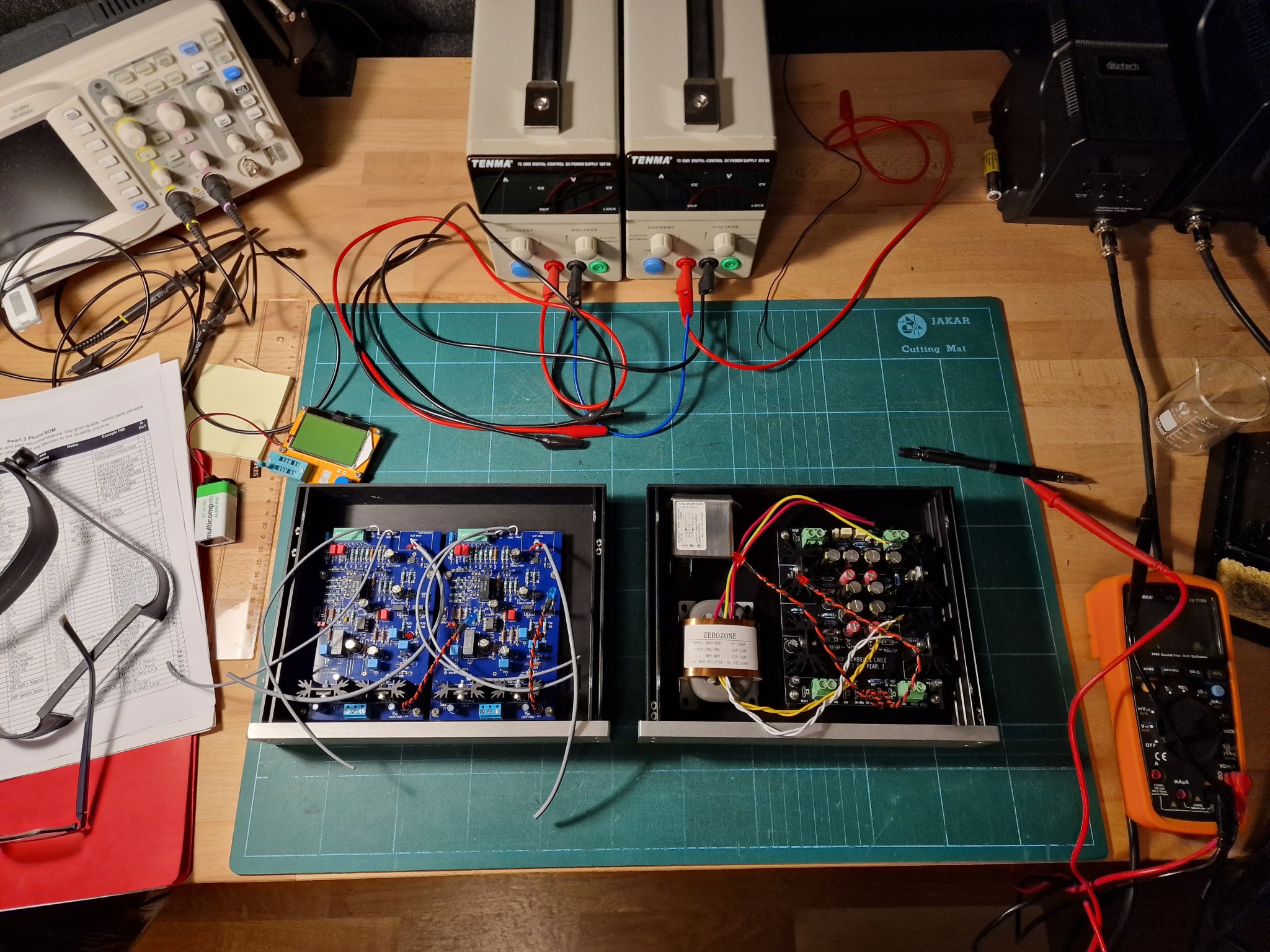

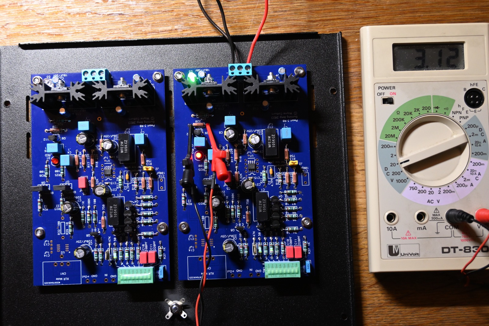

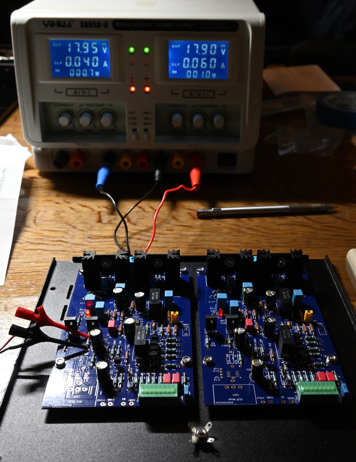

I did some quick DC measurements at both P3 boards using Lab-supply set to -+18VDC.
At opamp I measure V+ = 15.2V and V- = -14.9V at both boards.
Lab supply shows 0.8W from positive and 0.5W from negative. I think 50 mA vs. 30 mA.

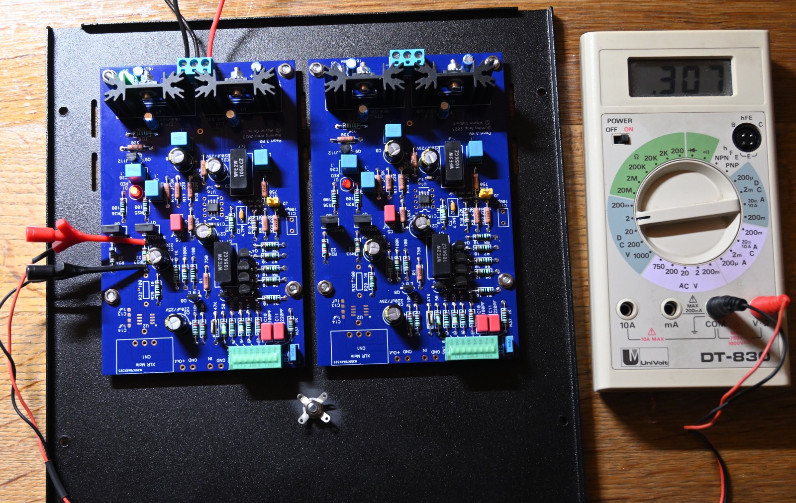

CCS shows just above 3mA at one board and just below 3mA at other board (3.1V vs. 3.0V over 1k resistor).
Red D1 led lights. I measure 2mV DC offset at out+.
For JFETs I measure 32 mV over 10R source resistors. So 3.2 mA bias for each JFET.
Over R8 I measure 126mV vs. 121mV. So about 12mA in total.
What did not work was output LED D3. I found out I reversed it on both boards.
I may have been confused at the +sign at PCB and put anode there but I can see that symbol at PCB has a "flat side" and that means Cathode I just verified using google 🙂
So that is the job for today to correct this error and test again.......😡
