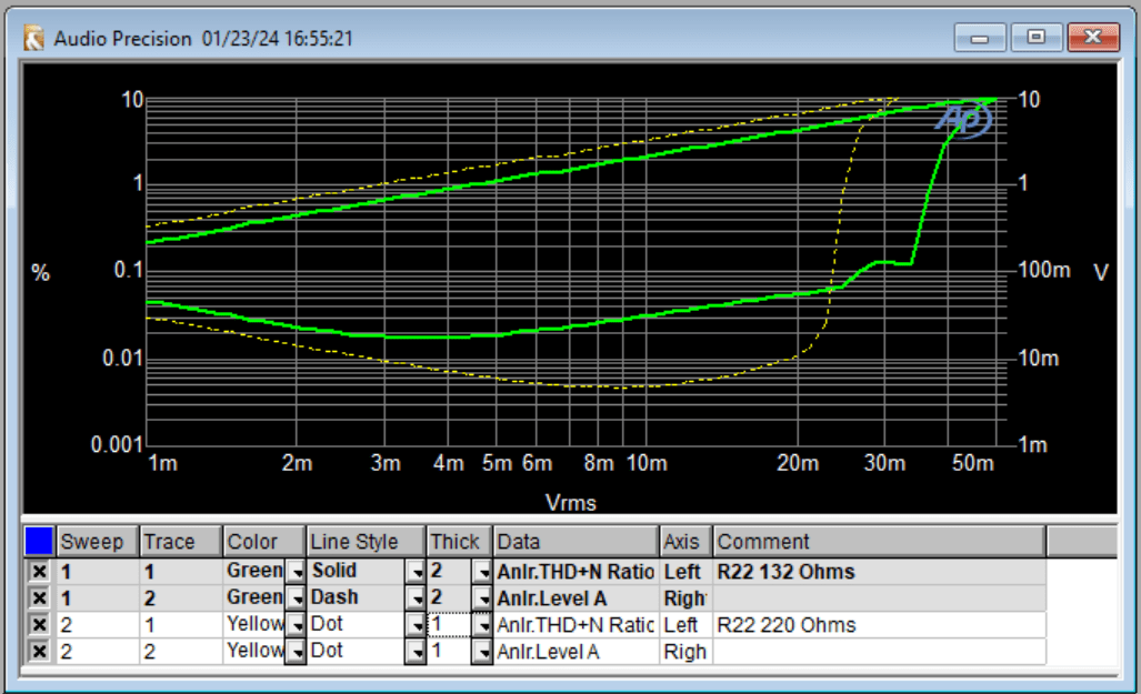

Is it @1kHz? And how much gain was P3 set to?
Excellent question.
The MM (Rfb=220R||2.2k) is specified at 49dB and mine is running hot at 50+ owing to the high gfs of the selected 2SK170's I chose. You only need 40dB for moving magnet carts.
Yes it is at 1kHz.
Tomorrow will adjust Rf for 40dB gain, and run the test at both1kHz and 20kHz.

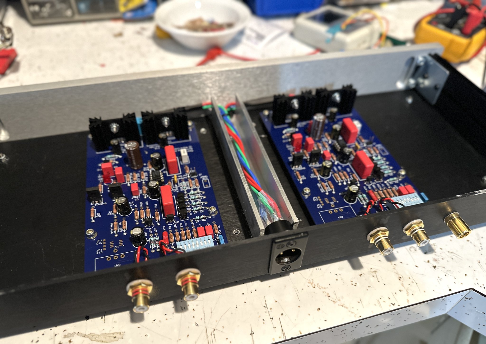

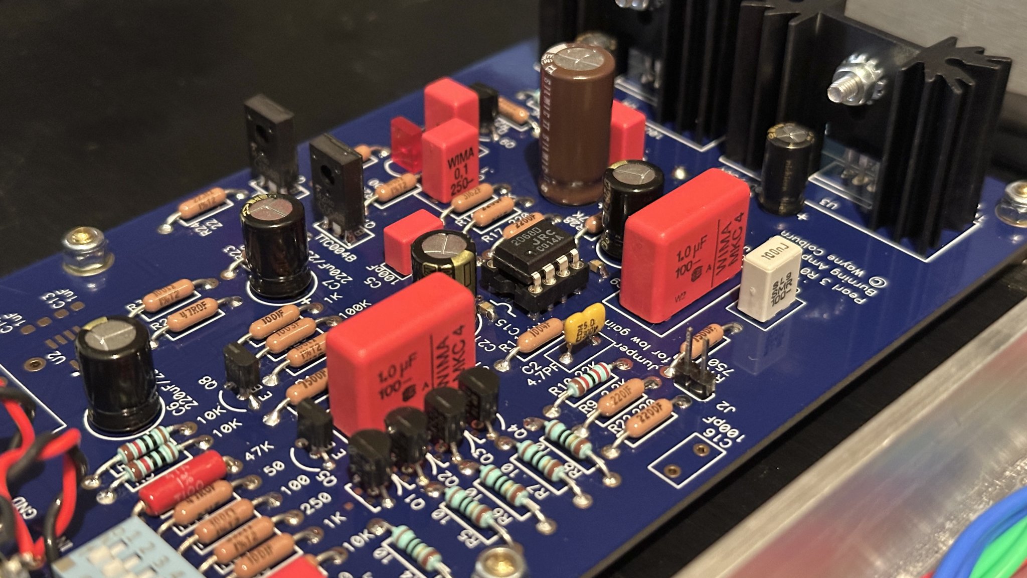

Another Pearl 3 birthed. I salvaged a chassis, K170’s, etc from my Pearl 2 build. The small boards are nice, so I want to go with a smaller, steel chassis in the future and optimize my wiring scheme a bit. Using a simple CRC outboard supply for now, also from Pearl 2 (though I downsized the toroid). Anyways, it’s done and sounds great - thanks Wayne and co for your efforts!

Thanks fellas. I'm definitely preferring it to my old Pearl 2, which was no slouch. For those still building, I had to adjust R27 to set my opamp bias properly, so it could be wise to solder in some pin sockets there, then once you find the right value, solder them in. Or better yet, do all that testing/measuring before bolting everything together (I'm bad at this step)
