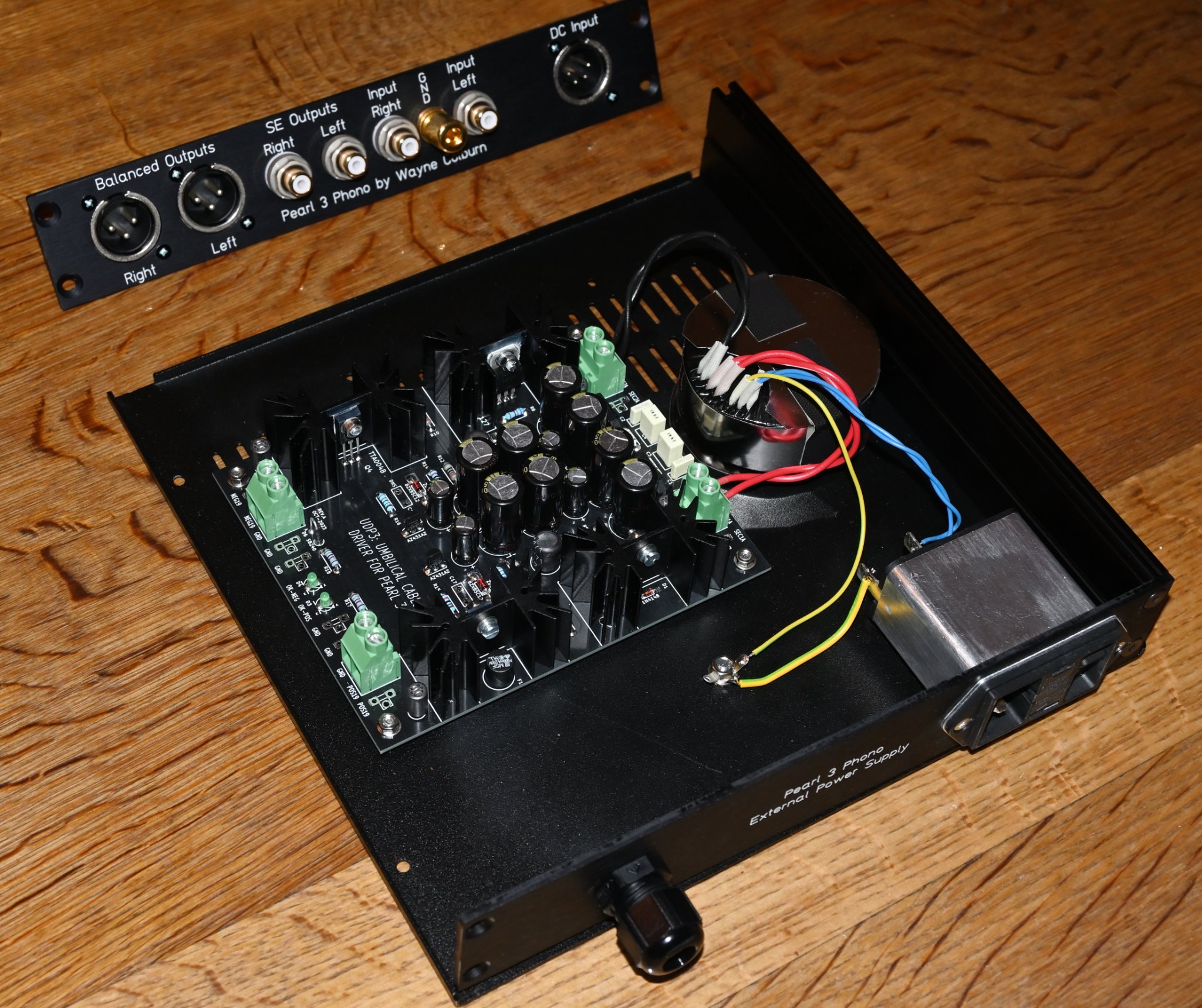

Two issues to deal with, magnetic and electrical.I wasn’t able to make a single-box Pearl 3, with a transformer PSU, quiet enough for MC. Now I’ll be the first to admit that my tolerance for hum is essentially zero, when turned all the way up, far, far, past listening levels.
<SNIP>
You can try orienting the transformer to minimize the magnetic field impinging on the PCB -- and in this regard note that the P3 pcb is much less a "receiving antenna" than the P2 pcb. You can try a different transformer, say an EI vs toroid. You can encapsulate the transformer in a soup-can which is bi-metallic. (A 28 oz tomato can works well, need not be San Marzano!) . You can get a sample kit from muShield, or try the magnetic shielding tape from 3M.
Morrison's book which I cited last week (unlike Harvard, I cite my references) has a lot of detail on reducing magnetic interference, but I don't expect you to go to Ebay to find a copy! Perhaps some duplicative language of Morrison's explanation would be in order.
Electrical is almost always a grounding issue.
I tried to cover the Toroidy transformer as much as possible with Permalloy I think it is called (to my knowledge same as mu-metal).
Toroidy already has magnetic and static shield (according to spec) but I thought it could not harm to do a little more.
Next step would be to attached the umbilical and then assemble it fully. Then I am ready for the P3 kit.
