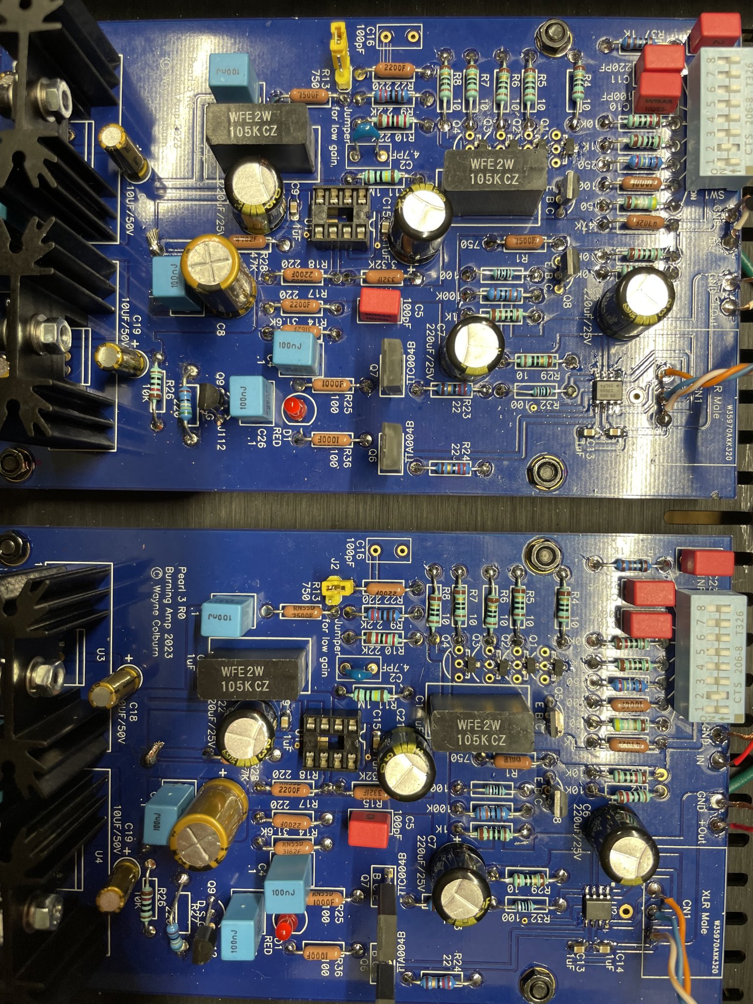

Many MM carts work at 47k, but optimal loading can vary from 22k to 100k.
Looking at the schematic -- and please correct me if I'm missing something -- I don't see why one couldn't substitute any useful R or C values for the DIP switch. Depends what carts you're going to run and how much cart rolling you expect to do.
Nice to have this option on the board. I just had my own boards fabbed for adding adjustable loading on some other phono stage projects.
If you want to redo the DIP Loading you need to update R12 (now 47k) and resistors for DIP switch positions 1-6.
It's a matter of doing a parallel resistor calculation of whatever you put in R12 with whatever DIP positions are turned on.
The default is set for 47k and a range for MC carts. But there's nothing stopping anyone for making it set up for a range of potential values for MM carts bewteen 22-100k. It comes down to doing a bit of math (excel is helpful here...) and then swap to the desired resistors.

The sockets I had on my boards are good for standard op amps, but not for the SOIC adapters I made. So just swapped out sockets. Time to op amp roll. Mouser p/n is on the bag in the pic.
Opa1612 is the first to try.
