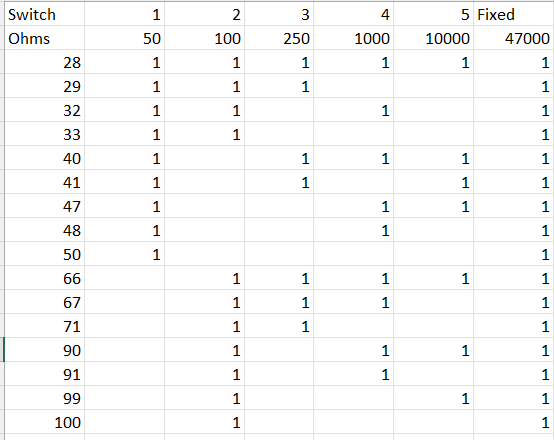

@Toys4Boys - for 2 Ohms I'd try settings between 20-40, then ramp it up towards 100. It will likely get better and better than trail off to worse sounding. You'll have to find that sweet spot.
The build guide doesn't have every permutation for the switches. Here's a little more granularity running up to 100 Ohm you can try.
1 = switch ON. 47k is always on. It's fixed in the circuit.

Which Rothwell do you have? It looks like they have multiple models with different ratios.
For fine tuning you can calculate a resistor to put in parallel to the 47k on a MM phono stage that optimizes cart, MC SUT, and the MM Preamp. That's what those calculators help you figure out.
