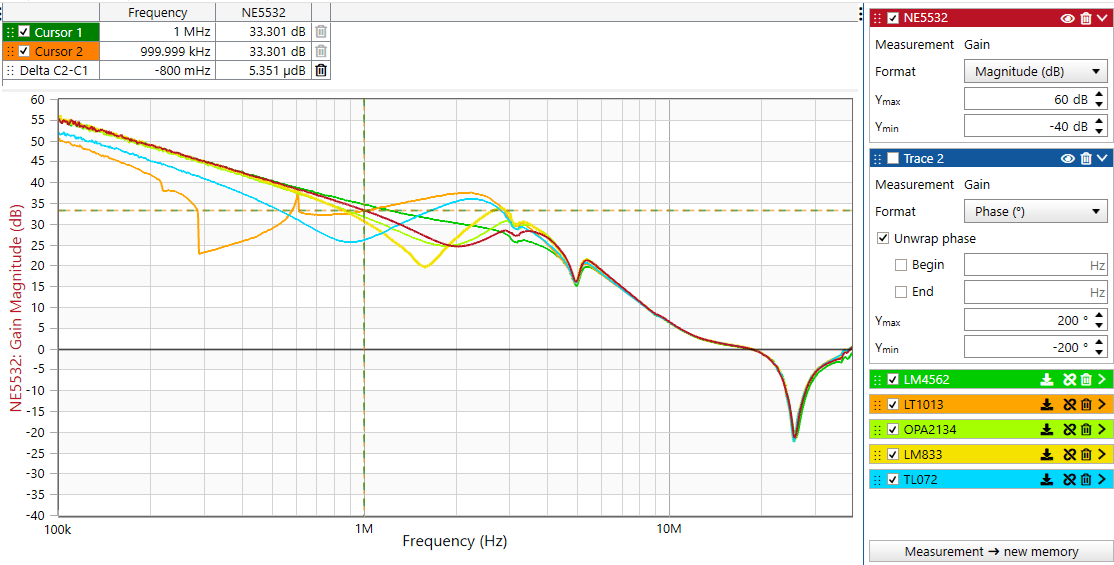

Mr. Bode found that the LM4562 seems to behave quite nicely and that the LT1113 is not well behaved. Mind you, this is just for the first amplification section of the P3 driving the 75us pole and second half opamp. Disregard the data above 20MHzSo what did you and Bode find?

I should note that the graph was done in the low gain setting of the first stage. Will repeat with the high gain setting tomorrow.

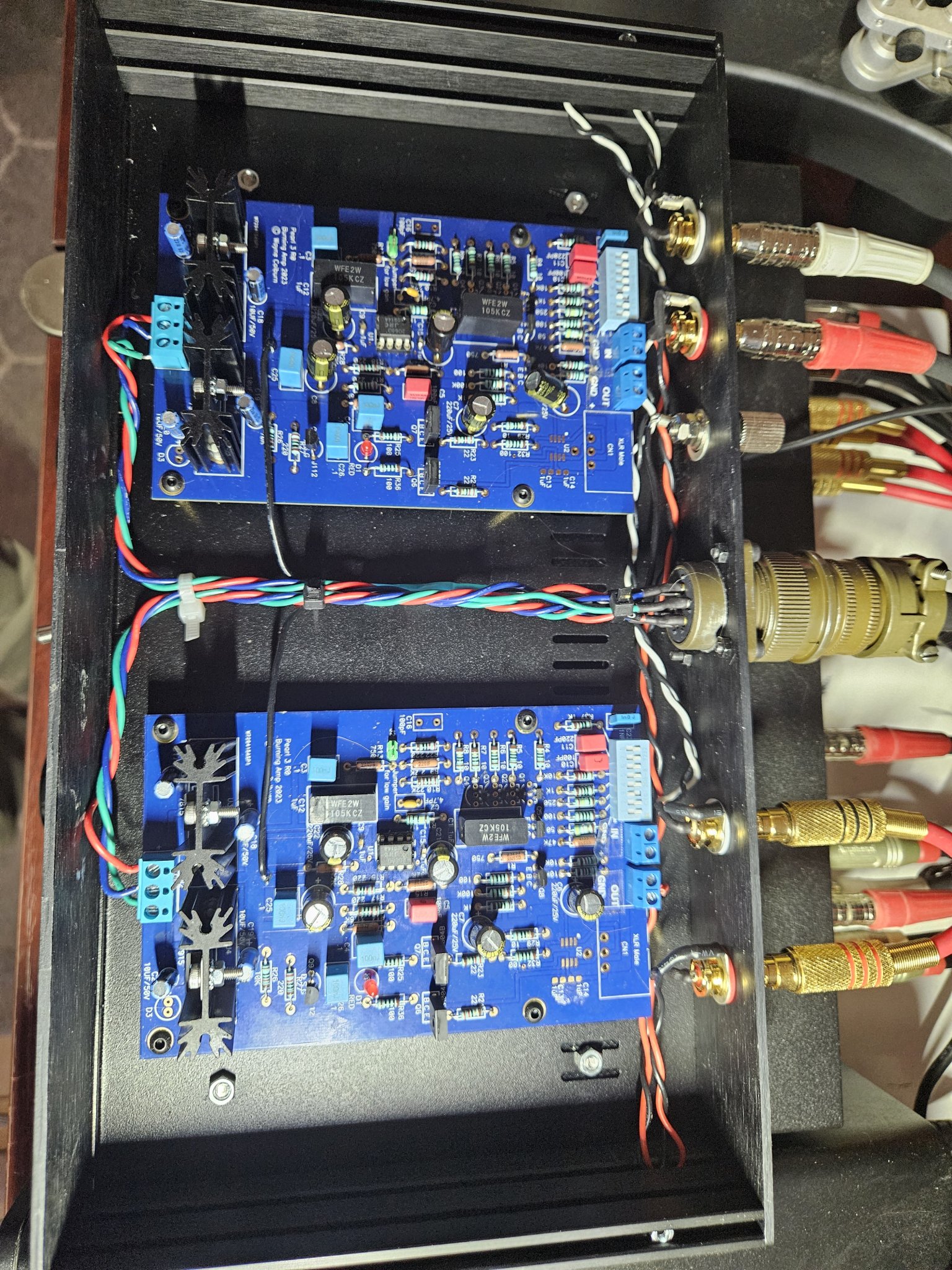

Just a quick FYI concerning dual PSU builds.
Finished the first P3 build 3 weeks ago with the kit, single PSU. The sound was so good I ordered a another kit for my second VPI Prime stereo rig. Since the transformers for the kit PCB are not currently available decided to use 2 18V+- ones I had gotten from Randy. Just finished this second P3 build and can report that the 2 PSUs provide a significant improvement over the first build. Have only listened for a day but note the improved soundstage clarity and positioning, a certain secure fullness to the timbral accuracy, and a deathly quiet to all -- so much so that it rivals CDs. New vinyl (such as the just released rsd of Ronstadt's Asylum years -- 4 albums) sound stunning. Of sourse YMMV but in my case am going to retrofit the first build to another dual PSU combo.

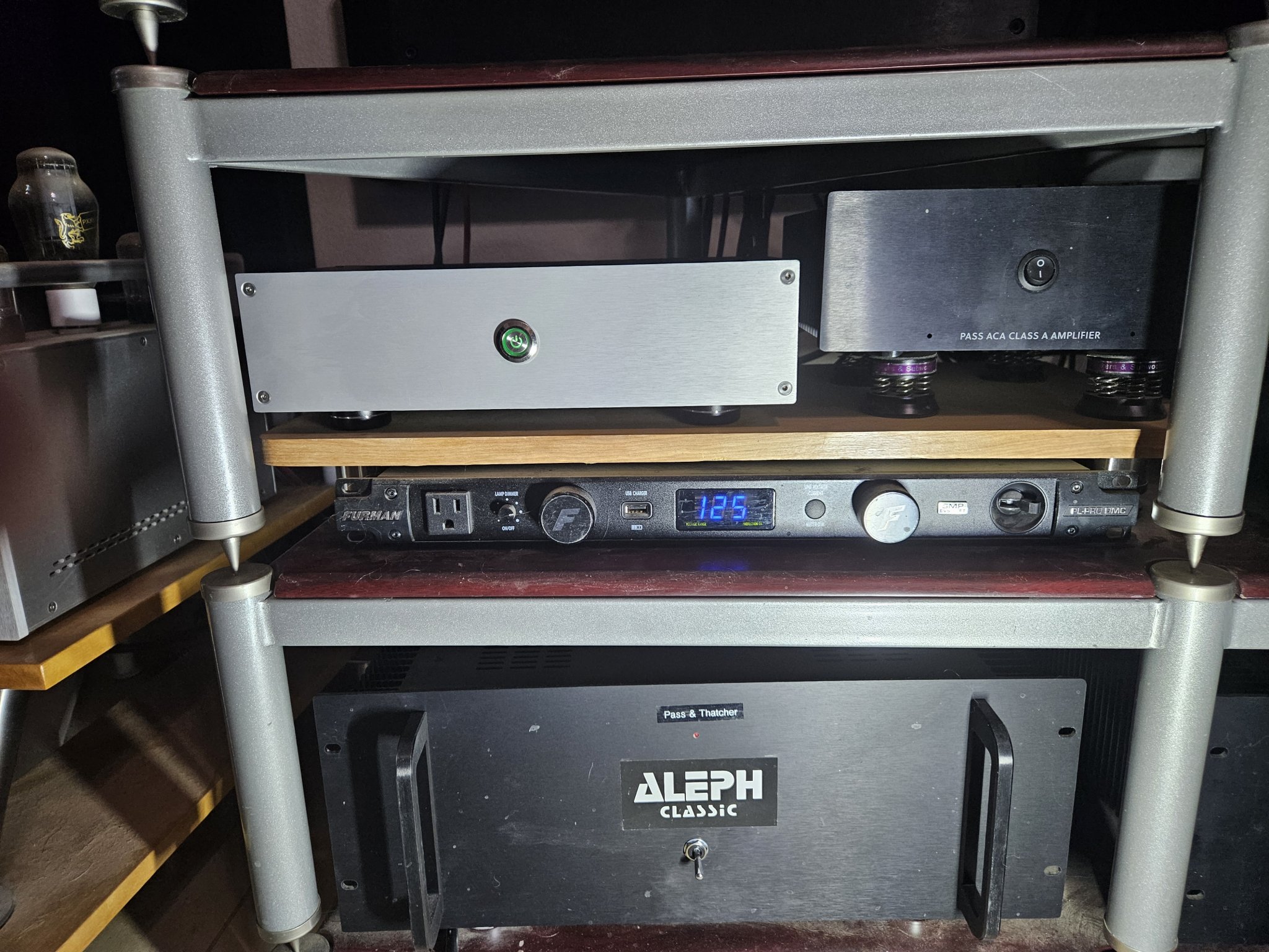

@mhenschel: Took the duplication back to a single outlook in (see the attached). Thought about two AC ins and guessed that because of the low amperage the AC in did not need to be duplicated. The 6 prong umbilical terminals are from Mouser and are expensive -- but I use this on my preamp design to send both polar and non-polar DC current from the outboard PSU to the preamp chassis. The P3 attaches to a 20 amp Furman power conditioner that also runs the 5 sets of power amplifiers I switch to with a system I call "active amp listening." Jim has been sent photos of this preamp design and it, too, uses Wayne's preamp board. Would love to learn more about his background since he is so obviously a brilliant mind.

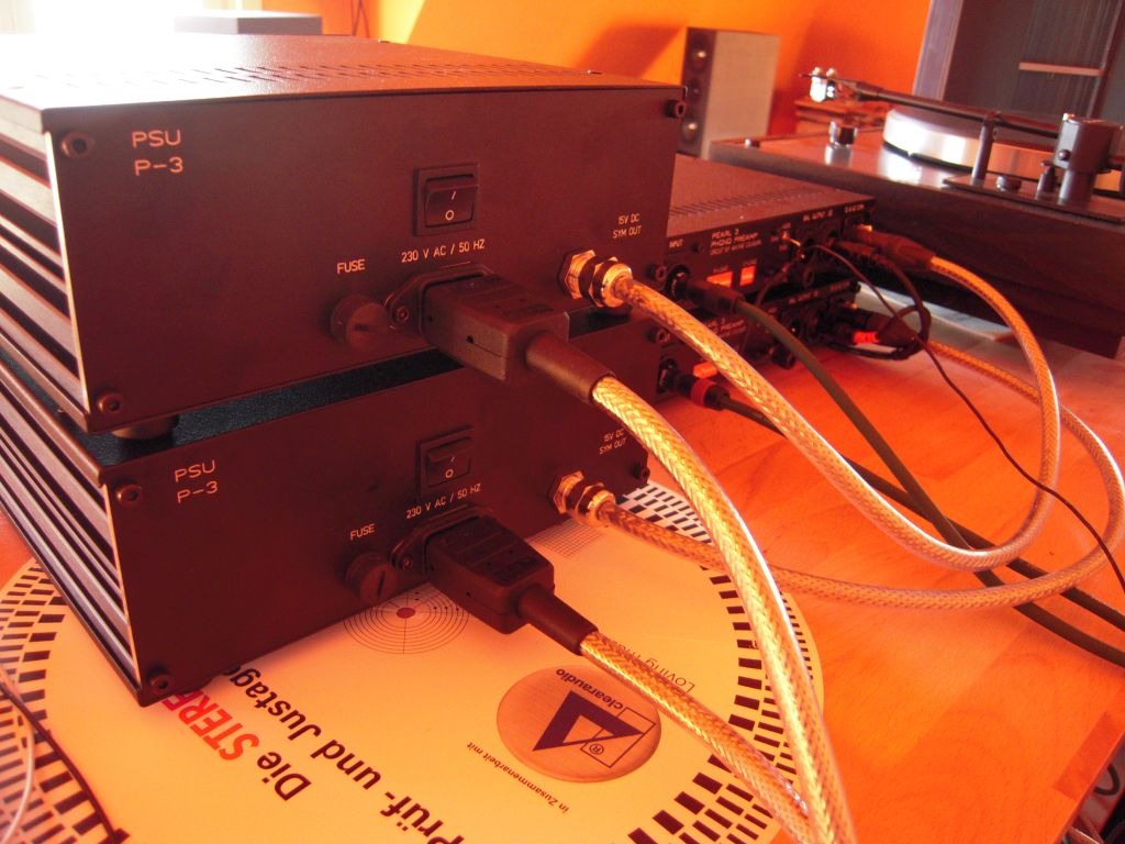

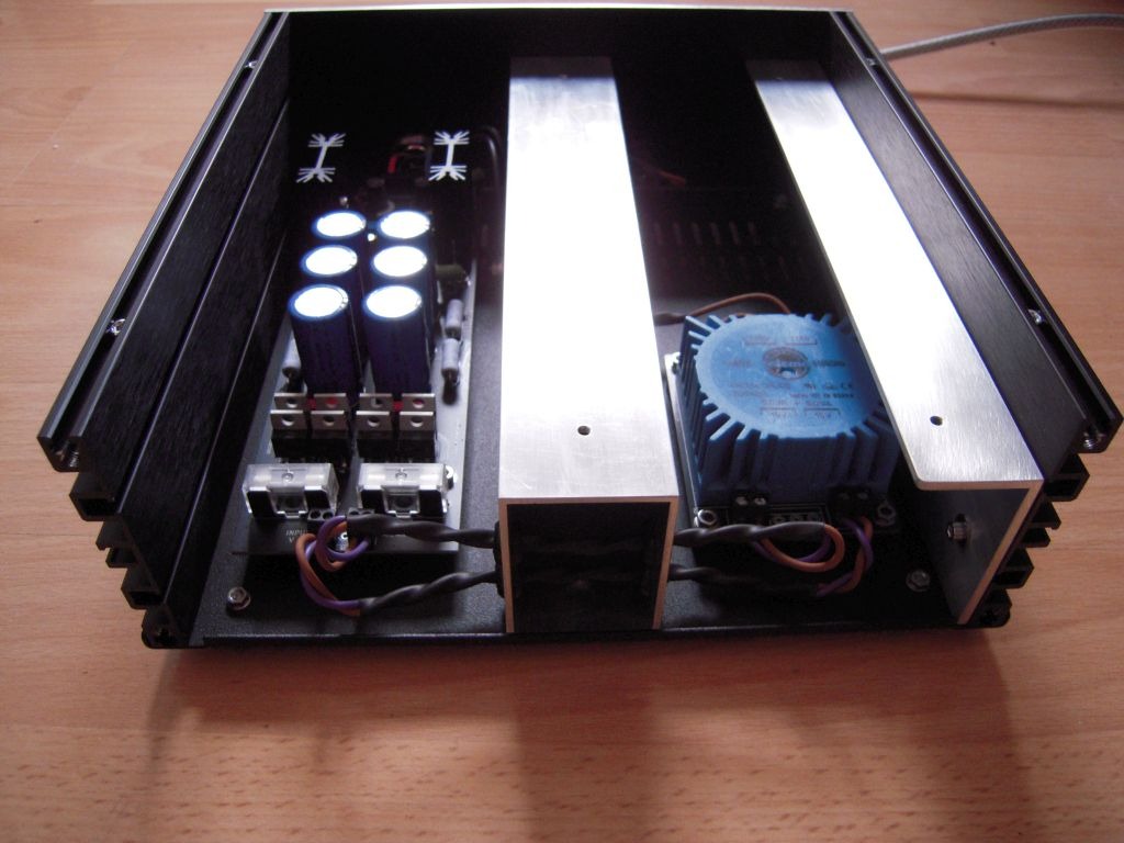

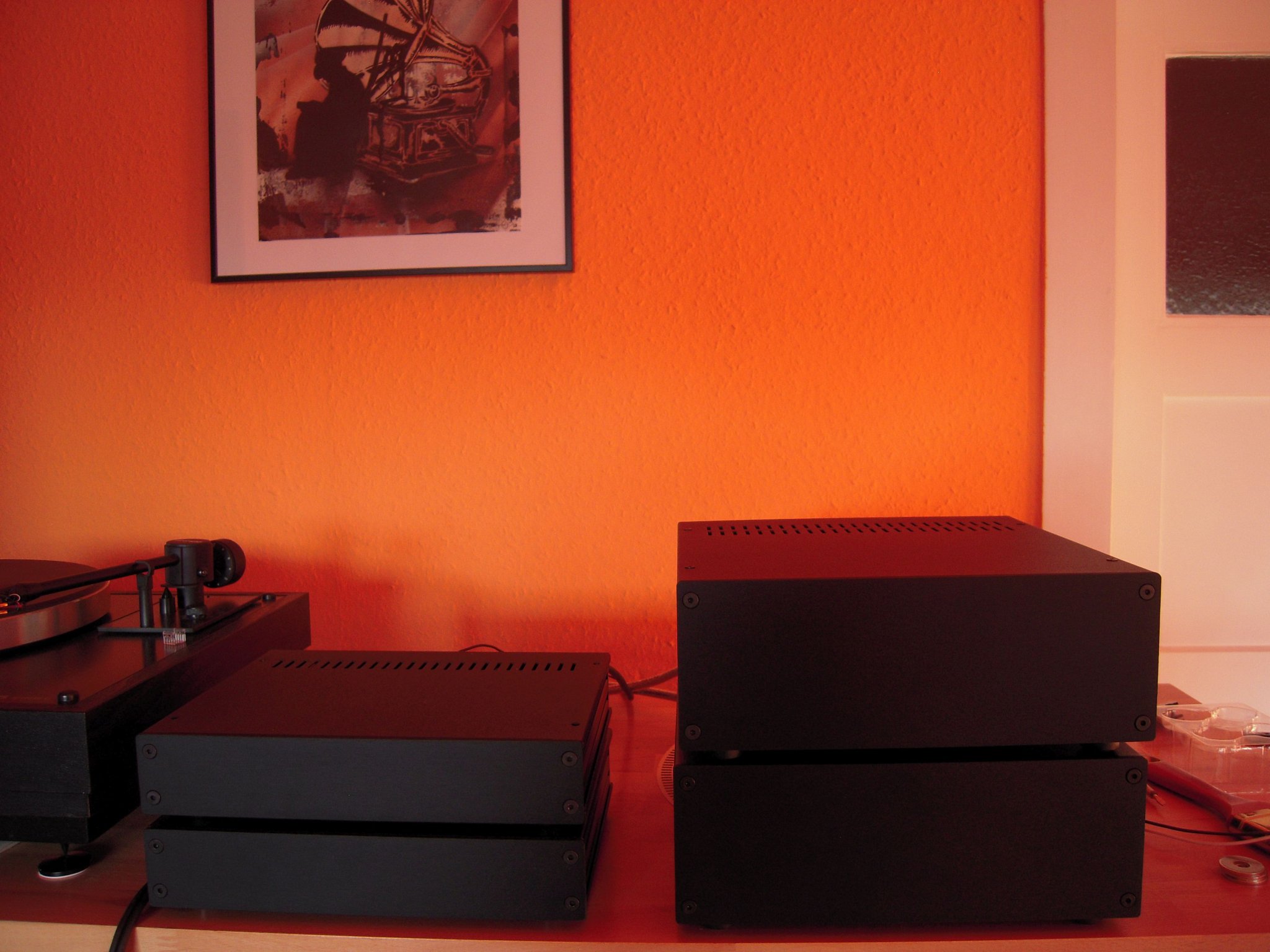

Hello Craigl59,
I fully agree with your impressions. I've built 3 versions of the PEARL 3. During the 'test phase' on the wooden board I used a PSU with one transformer followed by two seperated filterboards. Then I switched to a complete
dual mono build.
My impressions are also a better stereo imaging and a better listen into the depth of the recording room.
That is the reason why I have built a few Preamps (Waynes Line Stage, BA-3-pre, Frontend2022, PEARL 2)
and a few poweramps (Mono blocks) in complete dual mono configuration.
This is a lot of effort and costs are going up. For me well worth the expense.
Cheers
Dirk 😉

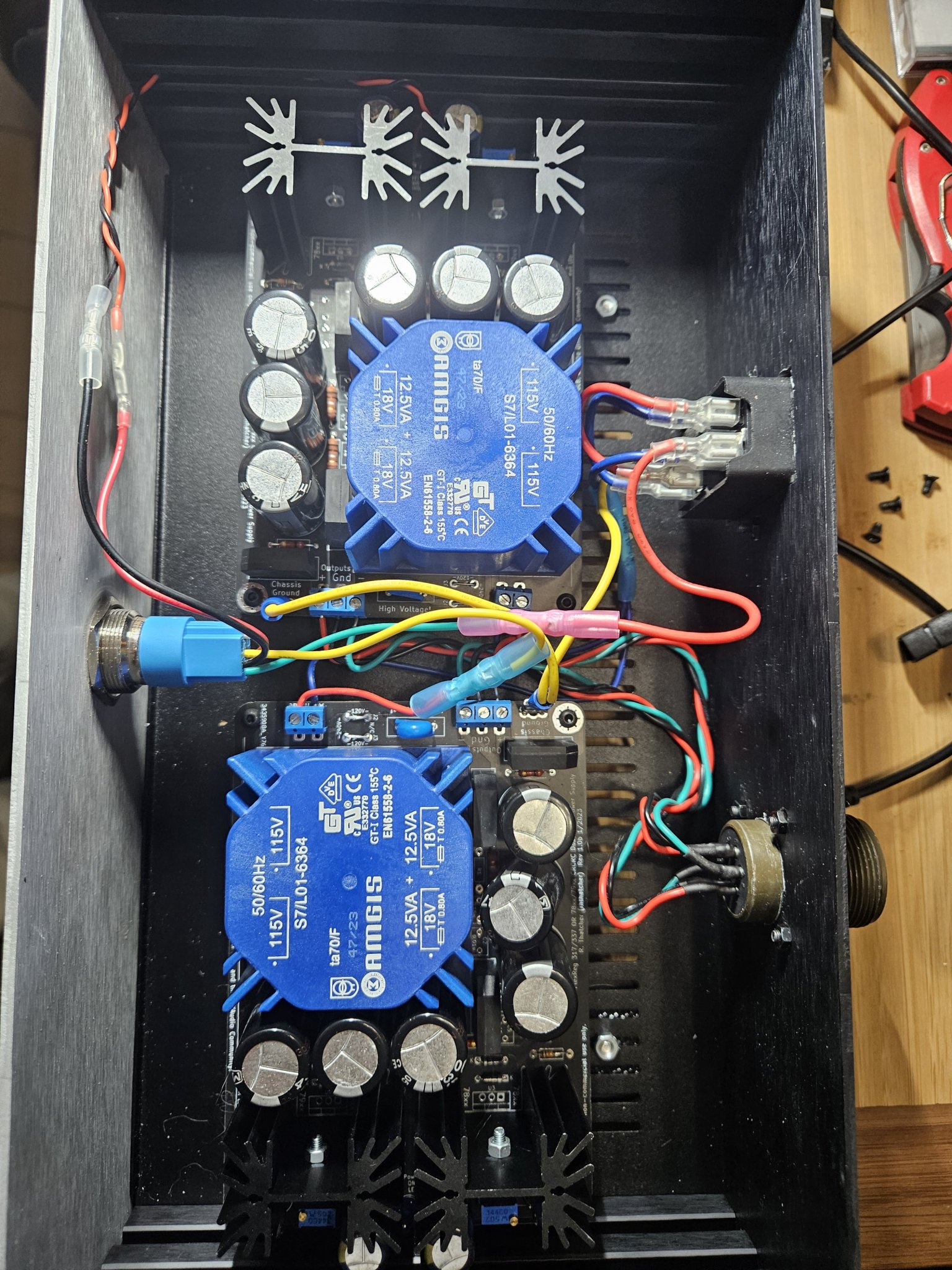

It looks like a pre reg or tracking pre reg, a regulated supply before the on board regs. They work very well at lowering the noise floor further. Its on my next to do list ....
