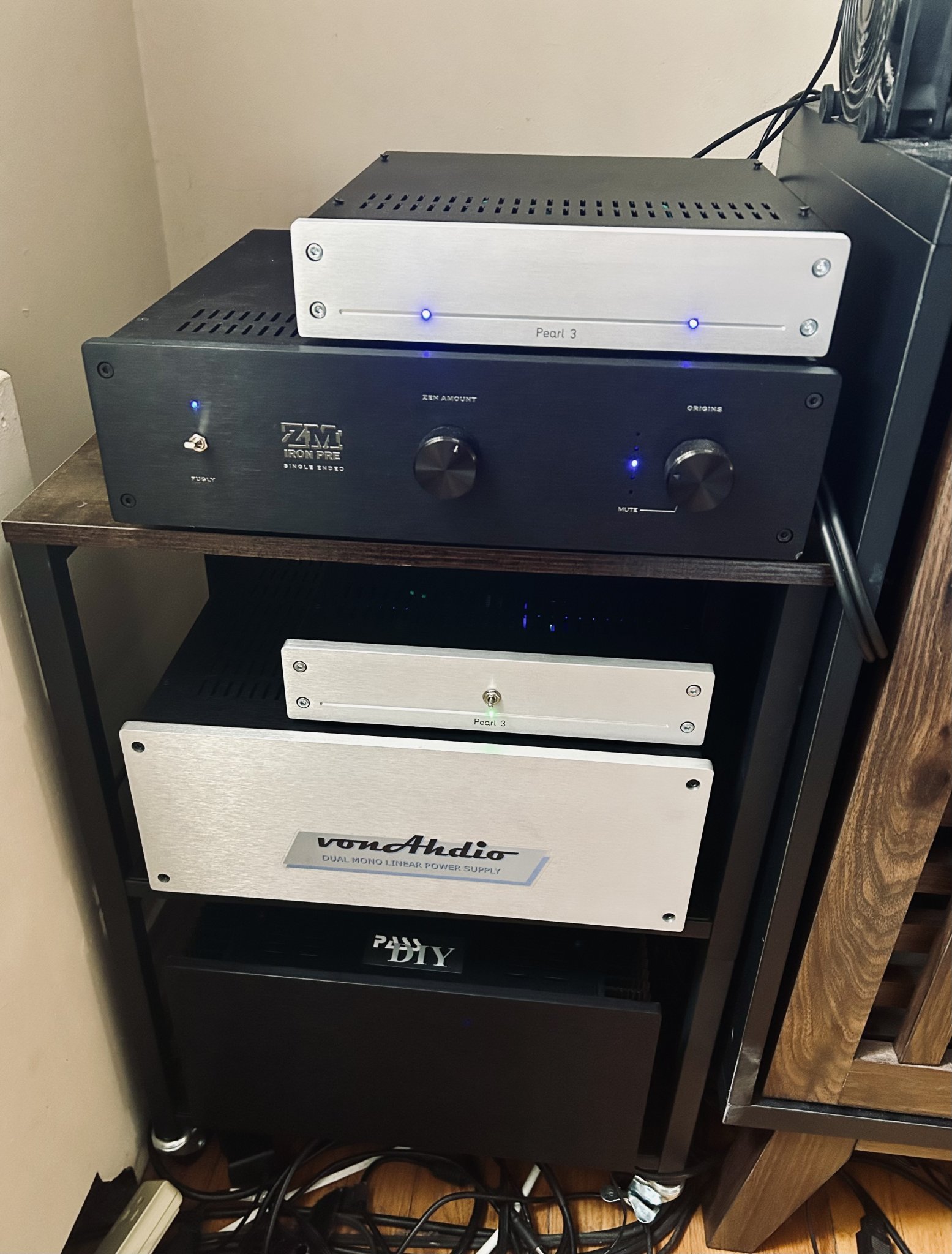

My cable is 6' long, shielded. When I ran the distortion and frequency response measurements with the QuantAsylum AQ403, I placed the PS the full 6' distance away on the floor, then watched for changes in the measurement screen as I moved the PS up off the floor, then closer to the preamp box. Power supply noise did not noticeably increase until the PS was about 1' from the preamp box, and then more when I placed the PS on top of the preamp box.
In my system, the PS box is 3' to the right, and 3' below the preamp, and there is no audible power supply noise.

When I built my Pearl 2 I recycled a fairly small steel case for the power supply. The Pearl 2 itself sits on a shelf while the PS fits easily behind on the floor.
It also seems a bit strange to build a two-chassis solution and then place the chassis on top of each other. Then transformer is only a few cm from amp boards. Compared to the one-chassis solution using an internal metal splitter the transformer in that solution is at a longer distance from amp boards.
I have purchased 2m cable so I should be good to go with 1m or so depending on how I will place the two chassis in my rack system.

I wasn’t able to make a single-box Pearl 3, with a transformer PSU, quiet enough for MC. Now I’ll be the first to admit that my tolerance for hum is essentially zero, when turned all the way up, far, far, past listening levels.
Could it be done? Perhaps. I suspect it would require a couple things… 1) a rack-width chassis, with the PSU as far from the RIAA boards as possible, and 2) at least one layer of steel in between them, maybe even two. Can the PSU, can the RIAA boards. That’s what my experimentations have led me to think would have to be done. I didn’t pursue this line any further as there’s too many other projects on my list and (much more important) the two-chassis solution is gloriously quiet and requires zero hoops to jump through for it’s performance.
Maybe a good quality SMPS with a good filter (AmyAlice?) in a rack-width chassis, with a suitable sub-enclosure inside for the PS and filter. I've done that with a different build and it is quiet. Like 6L6, hum and noise become really intolerable for me, limiting my desire to spin vinyl. A good gauge of how quiet any of my phono preamps are, is how many LPs I want to listen to in a row. With Pearl 3, we've played vinyl 4 hours in the morning, 3 hours after lunch. Basically, I stop when it becomes inconvenient to flip the records, and then it's GASP! - CD time.

What I am worried about is: noise pickup, DC-resistance (voltage drop) and I think noise pickup is the one I am most concerned about.
Use math. The power consumption of the Pearl 3 doesn´t qualify for any voltage drop in 3x0,5mm2 cable whatsoever.
About noise, I´ll believe you, when you show me the difference in noise of the suplly voltages inside the Pearl 3 from a ½meter cable

Regarding the power cable between the two chassis. Which length do you plan for?
I can see many place chassis at top of each other. In this case power cable can be like 30 cm. But then it is not very flexible and regarding magnetic noise probably better to place units at a distance from each other. Then maybe best to make power cable 1m or?
But if amp total silent even if top of each other then best to have as short a power cable as possible?

this seems to be mostly fallout from "photo op" considerations. people like to take a picture of their new units. when the boxes "match" you demonstrate that... by stacking or putting 'em side by side for the photo.
in reality there is really no reason for either box to be "apparent" or accessible. I figure mine will be in behind the turntable and preamp located to drape cable nicely. I might put the PSU somewhere I can see an "on" light...

I love the official chassis boxes, but I decided to go with a nice looking box I machined for the preamp, and a smaller, nondescript box for the PS, as it's hidden on a lower shelf. Still, the official boxes are really beautiful to my eye.when the boxes "match"

it isn't just the relative location of the two boxes. a lot depends on the particular environ of the equipment. as mentioned earlier a room below lighted with an array of old fluorescent fixtures can have a significant detrimental effect. other sites might be relatively "clean". in other words what works for one builder may not work well for others. YMMV.
same with grounding I expect. which might explain the "mileage" differentials we hear about all the time.
