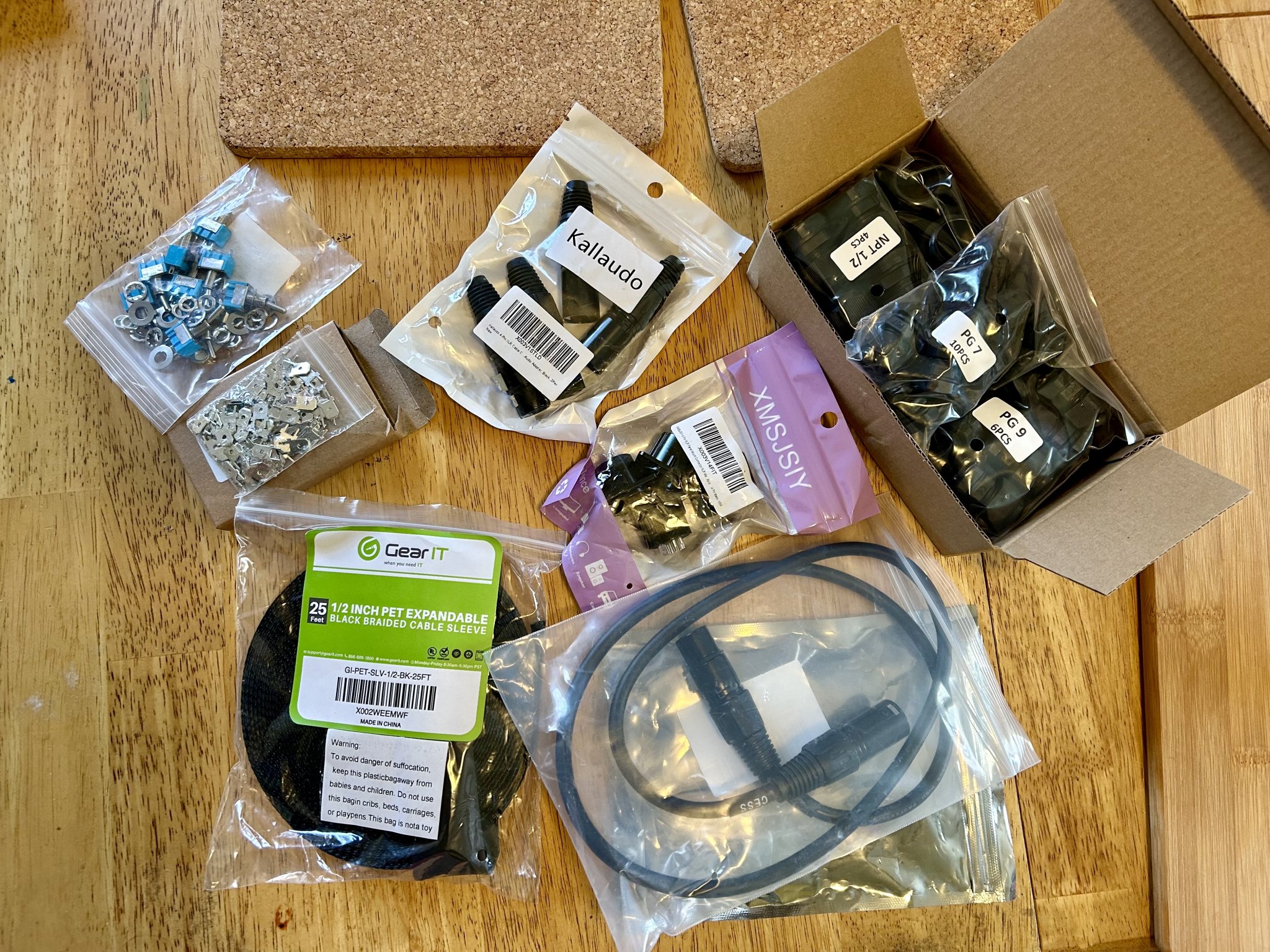

Champing at the bit, waiting for flux and other stuff 🙁, due tomorrow 🙂
I'm hoping to have all parts ready to go before Pearl 7 comes along. 🙂

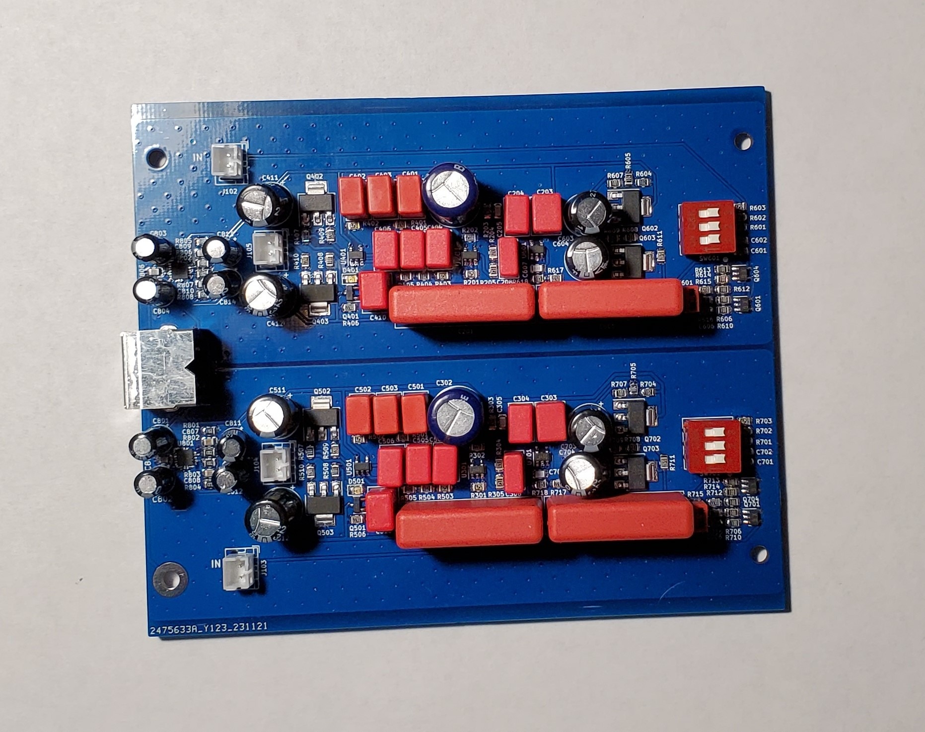

If anyone is interested I've made a surface mount version of pearl3 with some modification in the RIAA equalization, a subsonic/supersonic filter section adapted from Doug Self's Small Signal Audio Design book and separate low noise LDO's for each channel. It all fits on a 100mm x 120mm board intended to fit in a Hammond 1455 series enclosure.
That design could be wave soldered and easier to service if you put the smt parts on the back side and the tht stuff on the top
At the moment, there are bottom side 100nF bypass caps for each of the op amps. You're right that it could be a bit easier to build if all the SMT were bottom side
