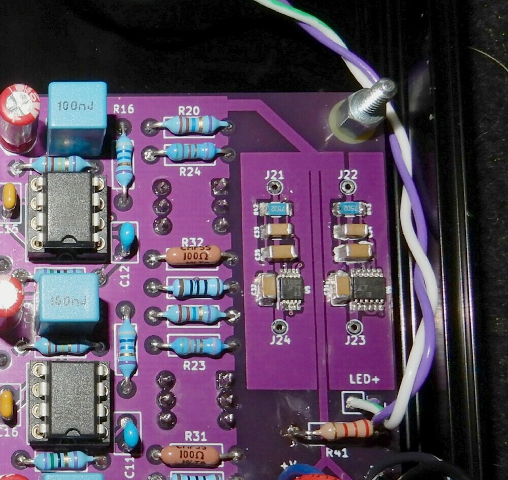

I used the hot plate method for my MC head amp charge pump - really small parts! I failed the first try and had to use a fresh board. This is the second attempt, but it still required cleaning a solder bridge and iron touchup.

When in doubt... Drown that bitc..h in flux. I'm using temp of around 330C for my soldering using classic 67/33 and Cardas Eutectic solders.
1. Put flux
2. Tin one pad of the part that you want to solder, choose something in the corner
3. If your flux got burnt, or doesn't look good: wipe it and add fresh flux
4. Hold the part in the tweezers and solder that one pin you got prepared. Make sure to position the part properly - it's crucial
5. Add more flux
6. Solder the rest of the pins one by one. I like to use 0,1mm solder, or something around that
7. Wipe the flux, inspect the job
8. If there are solder bridges between pins: use flux and try to wipe it with soldering iron's tip. If there are pins that aren't soldered well, use flux and add a bit more solder.
9. If last step is troublesome, use soldering wick (or cable's screen) with flux to remove extensive solder.

I too have used Cardas "Quad Eutectic" solder. It is a "secret" alloy of lead, tin, silver and copper. I tend to stay away from secret enchanted audiophile products, but this solder is wonderful. It flows beautifully - must be the magical flux - and it is easy-ish to clean up too.

Already have the solder, but that sounds like good advice. I haven't been using flux to avoid the cleanup but.....In my experience SMD such as used here is very easy to solder with a regular soldering iron with a small tip. I'd rather focus on getting good flux rather than a fancy solder. Flux is your friend!

I use Chipquik solderpaste and a hot air rework station for SMD parts.
No sweat! Get a thin solder, something below 0,5mm. It is very easy to overdo and add too much solder to the connection.@SomekPoland Your description is pretty much what I watched on YouTube, but short, sweet and to the point!
